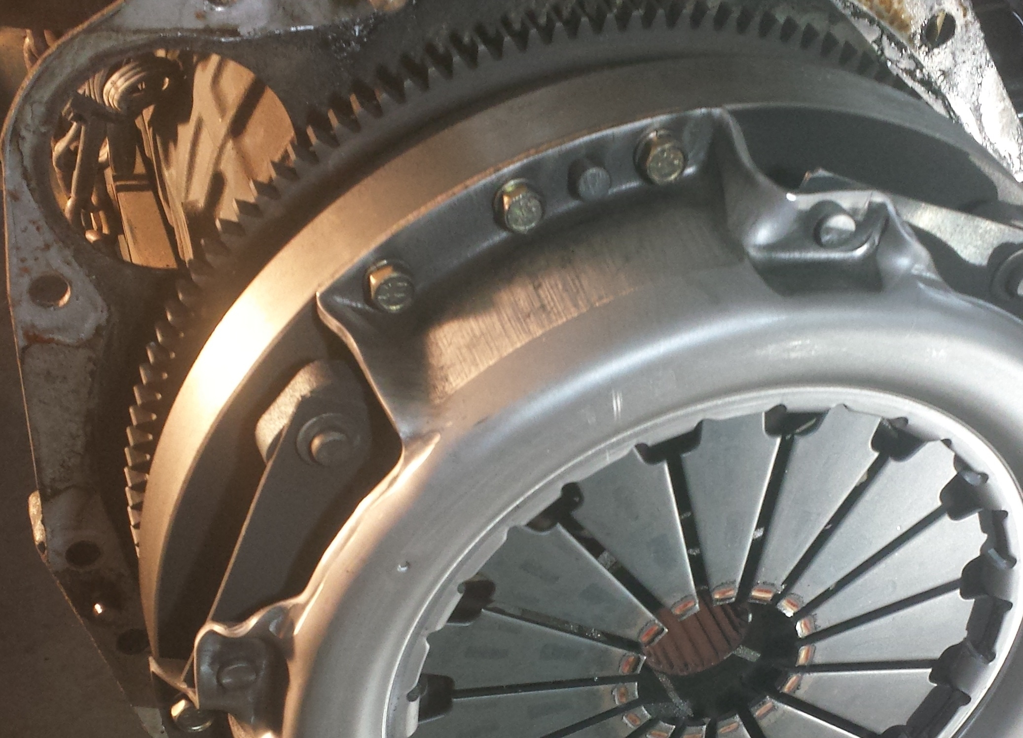

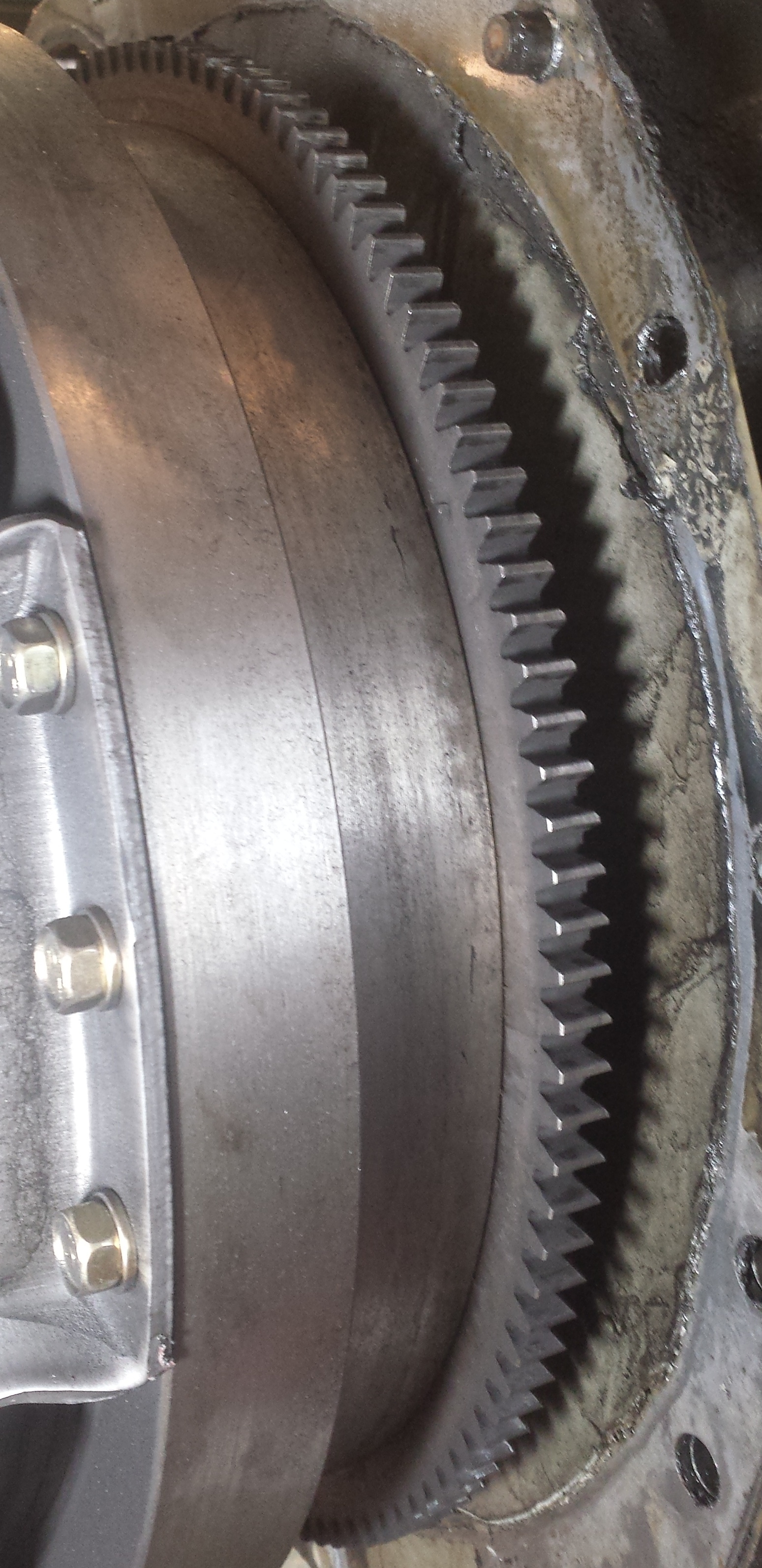

Mark the spot it grinds and check it prior to every start. I bet you will find it's only useing a few teeth to start alot of the time. Then get it in that spot and pull the starter to inspect the teeth.
/ Engine Starter Mystery
#12
Thanks for the ideas!
Not sure what I should be 'marking'... the crank pulley? Not sure why it would start perfectly every time when the engine has been running and is warm?
Attached are a couple of photos of the ring gear from when I did the split a few years back. Not the best photos but they might show something others would recognize.
Thanks again.

/ Engine Starter Mystery #13
Mark the crank pully in a easy location.

Finally... this problem is solved.
Turns out, the starter had bad grounding when the tractor (engine and transmission) were cold. But that grounding improved when the tractor was warmed up. When the tractor got cold again, the grounding was bad again.
I added a wire from the starter mounting bolt to the ground point on the tractor frame. This provides permanent good grounding to the starter and it is starting perfectly now regardless of tractor temperature.
Thanks again to all for the ideas!
/ Engine Starter Mystery #15
A weak ground would reduce the amount of amperage the starter could pull which may only show when the motor is cold. Thanks for the update.
