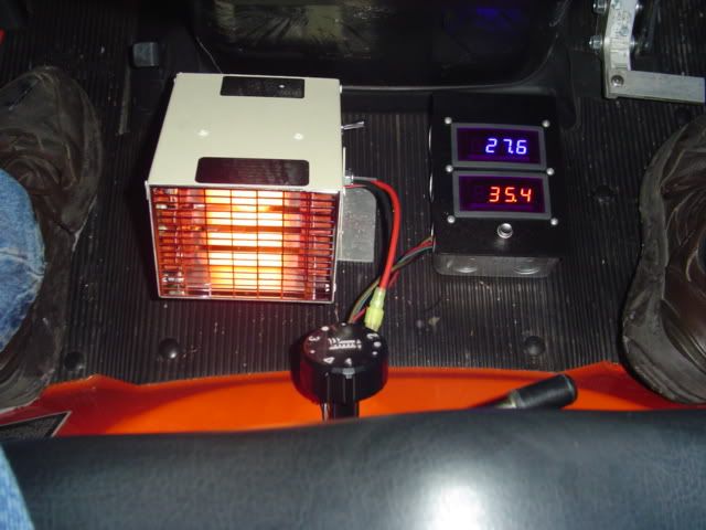

.............I currently run the new style with configurable vents (24V / 45 Amp) and it seems comparable to a 1500W space heater.............
With 24 volts and 45 amps it calculates to 1,080 watts. I can see that feeling comparable to a 1,500 watt space heater in the cab. the other calcs don't make sense. I went to their website and it looks to me like they have some bafflegab going on.

locknut, did I read that correctly, you are running a 24 volt system on your tractor.
/ Tractor heater? #25
"bafflegab" ...thats sounds scary....lol

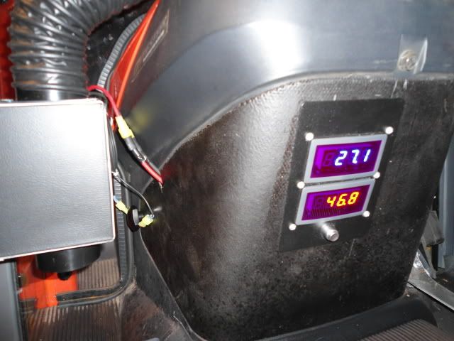

Yes. 70A Delco 1-wire alt driven at mid pto.Two L&G batteries mounted underneath for the voltage storage. I use it for the heater and two 24V actuators for the v-plow up front.
/ Tractor heater? #26
Very nice set-up.:thumbsup:
/ Tractor heater? #28
Locknut,
Where did you get the nice digital gauges?
Steve
Coleman-Aire thru ebay.Wouldn't recommend one though.DOA when I got it.Sent it back.Worked ok for a couple years,then last year it quit.Supposidly made for aircraft.Maybe tractor use is too much vibration.Been thinking about removing it from the blockoff screen and install a volt gauge.
