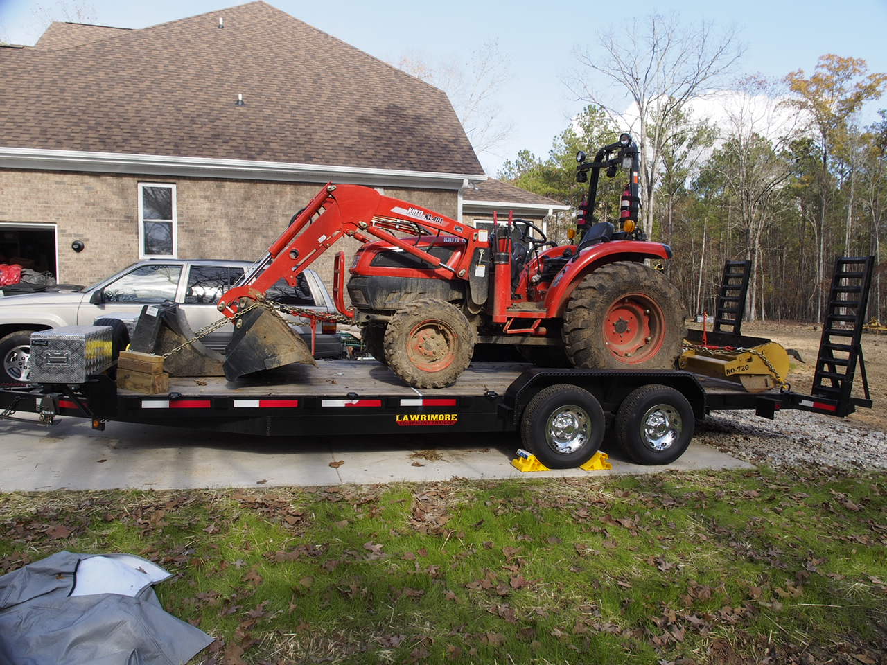

I know the tongue weight of my trailer and tractor in its "standard" configuration and have marks painted on the trailer deck for where to place the tractor's axles for proper, measured tongue weight and use a Blue Ox WD/sway system. I adjust these load points depending upon various mounted implements.
Note the thin white line on the deck by the tractor's front wheels. I have moved the tractor back a little bit from normal to compensate for the weight of the stump bucket forward of the tractor. Bucket is strapped down out of view and the tractor bucket sitting on top of it and chained down. Weight of ~ 15% - 18% on tongue is my norm.
