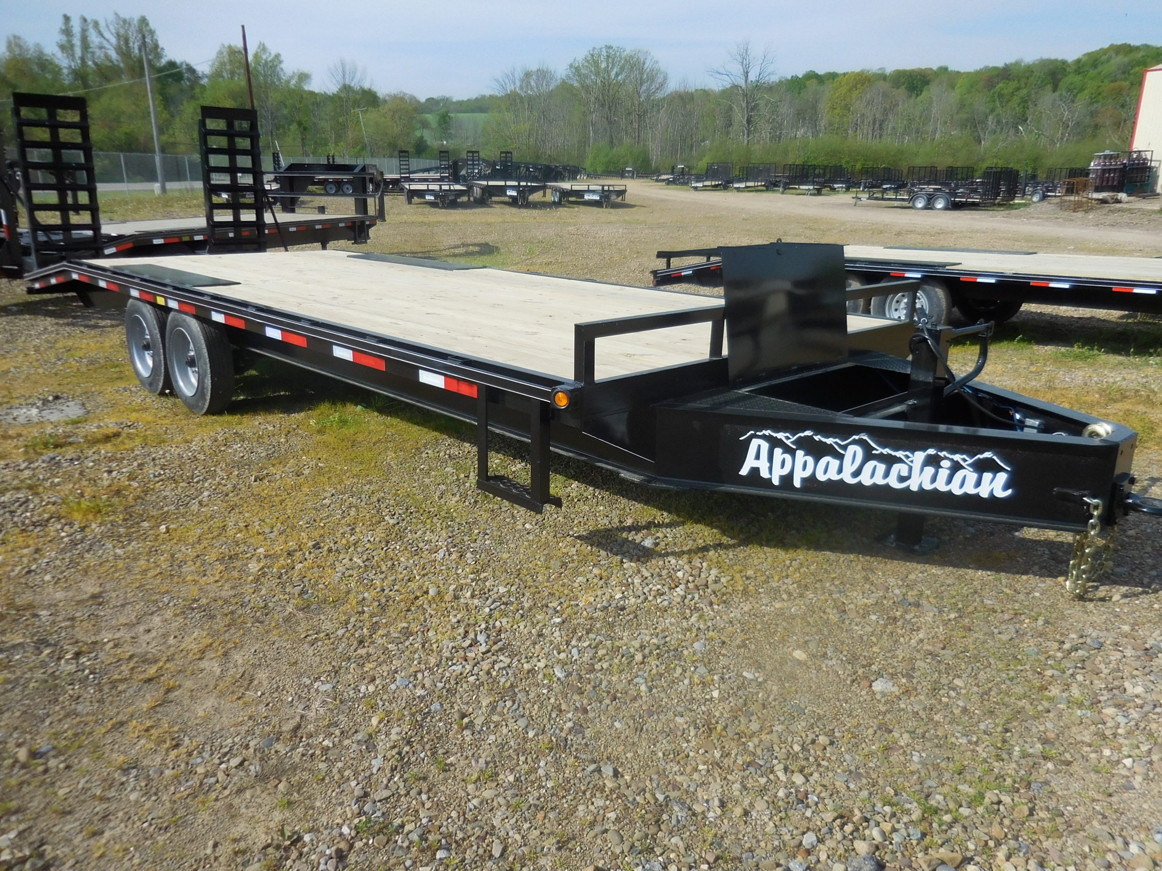

Ordered an Appalachian 20,000LB 25’ deck over trailer.
Going to look like this, except:
Red paint
Dual 2-speed jacks
Split 15,000LB mesh tailgate
Spare tire & wheel
22K cast 2&5/16” ball coupler.
Uses:
2x Kubota ZD-1211’s 1 day/week.
Hauling 8 bales of hay @ 1750lb each
Future CTL hauler.

Super singles like the trailer pictured ? Or dual tandems?
/ New Appalachian 20K Trailer ordered
/ New Appalachian 20K Trailer ordered #8
I went with the super singles since I already have a dual tandem.
I like super singles but they pull like an anchor. They’ll get you stuck in a hurry.
/ New Appalachian 20K Trailer ordered #9
The only place I don't like my super singles is when loaded heavy in soft sandy areas but it pulls great to me in the rest of my uses and you will absolutely love the 17.5 tires over the 16's as they are tough as nails, congratulations on your new trailer, it's gonna be a great week brother.

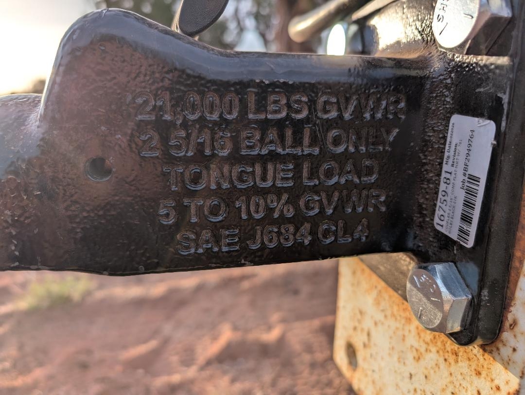

Nice trailer! Looks heavy duty, the 5500 will be a good match. It is 20k rated with 5k hitch weight, equipped with a pintle hitch coupler. The 22k ball coupler will derate it to about 2.2k hitch weight or about 18.2k gvw rated, still a serious trailer. It should serve you well.
From the manufactures web site.
GVWR 20,000 lb. - Capacity 15,000 lb. with 5,000 lb. Hitchload
  • Heavy duty adjustable plate for pintle eye (ball hitch N/A)
I will have to check on that. They did not specify a de-rating of the trailer, but that makes sense. Although it says the ball hitch is N/A, it is actually available.
If it derates the trailer, I am going back to the ring lunette. I need all 20K capability.
The order was just placed, so easy to change now.
Easy to change anytime, really. Was kind of thinking last week of having both couplers for it.

Good call. I buy, repair and sell trailers to supplement my retirement. The last 3 heavy duty bumper pulls that I sold, all came with pintle hitches, and high pin weight ratings. I always install ball couplers (21k Demco's) to make them more pickup truck friendly. I always include the pintle ring with the sale and advise them of the different ratings.
Not to berate you, your truck or trailer. I know you are an experienced heavy hauler. Just trying to help. But keep in mind, 5500 or not, 5k hitch weight will be sketchy with the long overhanging flat bed/hitch, receiver rating and ball/pintle mount rating. I think the 2.2k ball coupler is enough for the 5500. I recommend using your dump truck with the pintle hitch.

I asked Appalachian about the ball coupler. Here was their reply:
“Our typical ball couplers are only rated for up to 16,000 pounds. For this trailer we will use a heavier cast coupler that is rated at 25,000 pounds, so your weight rating is not compromised.”

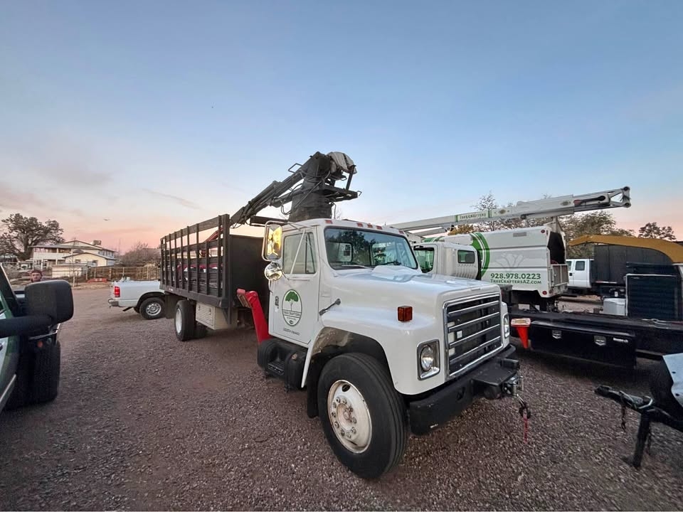

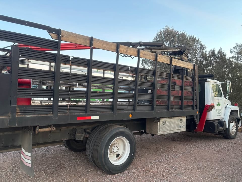

This self loader might make you an awesome hay rig. It had a log grapple but pretty sure you could modify it for hay bales.

I could be wrong but most ball couplers are rated 10 percent hitch weight of the GVW.

I just got an update on the cast ball coupler.
Rating is 25,000Lbs
Tongue rating is 5,000lbs.
So the trailer hitch is plenty for a 20,000lb trailer, but the 5500’s hitch will be the weak link in the chain. Now I have to find out what its’ rating is. I know the hitch is rated at 20,000, but I don’t know the tongue rating.
Behind the dump truck or future hay truck, that won’t be an issue.
