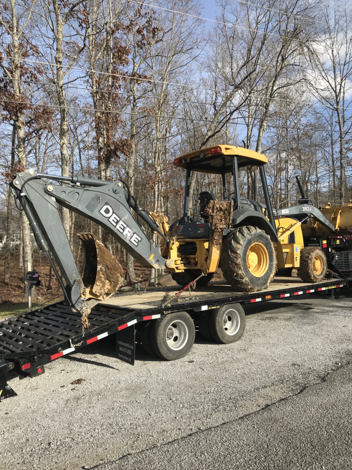

Yes, alot. I hate digging by hand...time consuming...low effect. I will rather weld for a week just to dig easy :)
I didn’t get along very well with shovels, so.. I definitely feel your pain. IMG_0786.JPG
