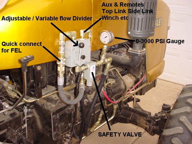

YES I can control the speed with the VARIABLE Flow divider that I installed on the tractor before I installed the FEL.
AND OR I can control the speed by feathering the valve, these valves are good for feathering.
Here is a PIC of the variable flow divider.
