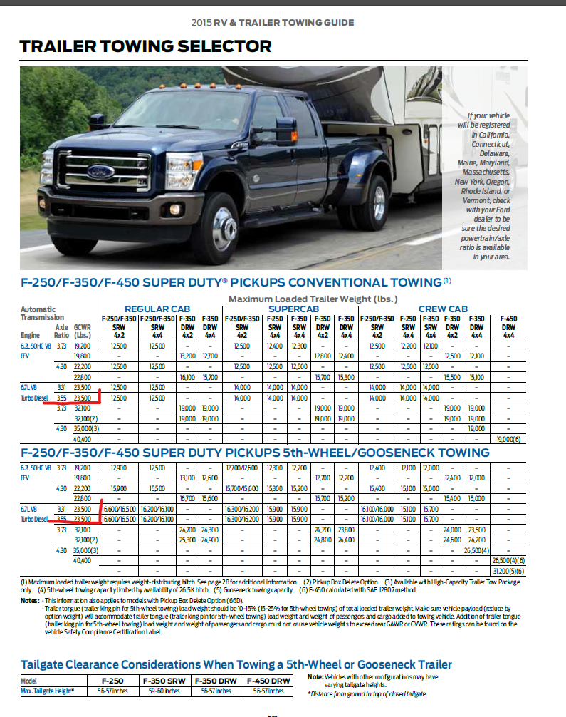

Well, my F150 with a 5.0 V8 only tows 9,000 lbs., so you have to get a “properly equipped” half/ton.
Very true. My half-ton towable 5th wheel can only be towed safely by a select few half-ton pickups.
