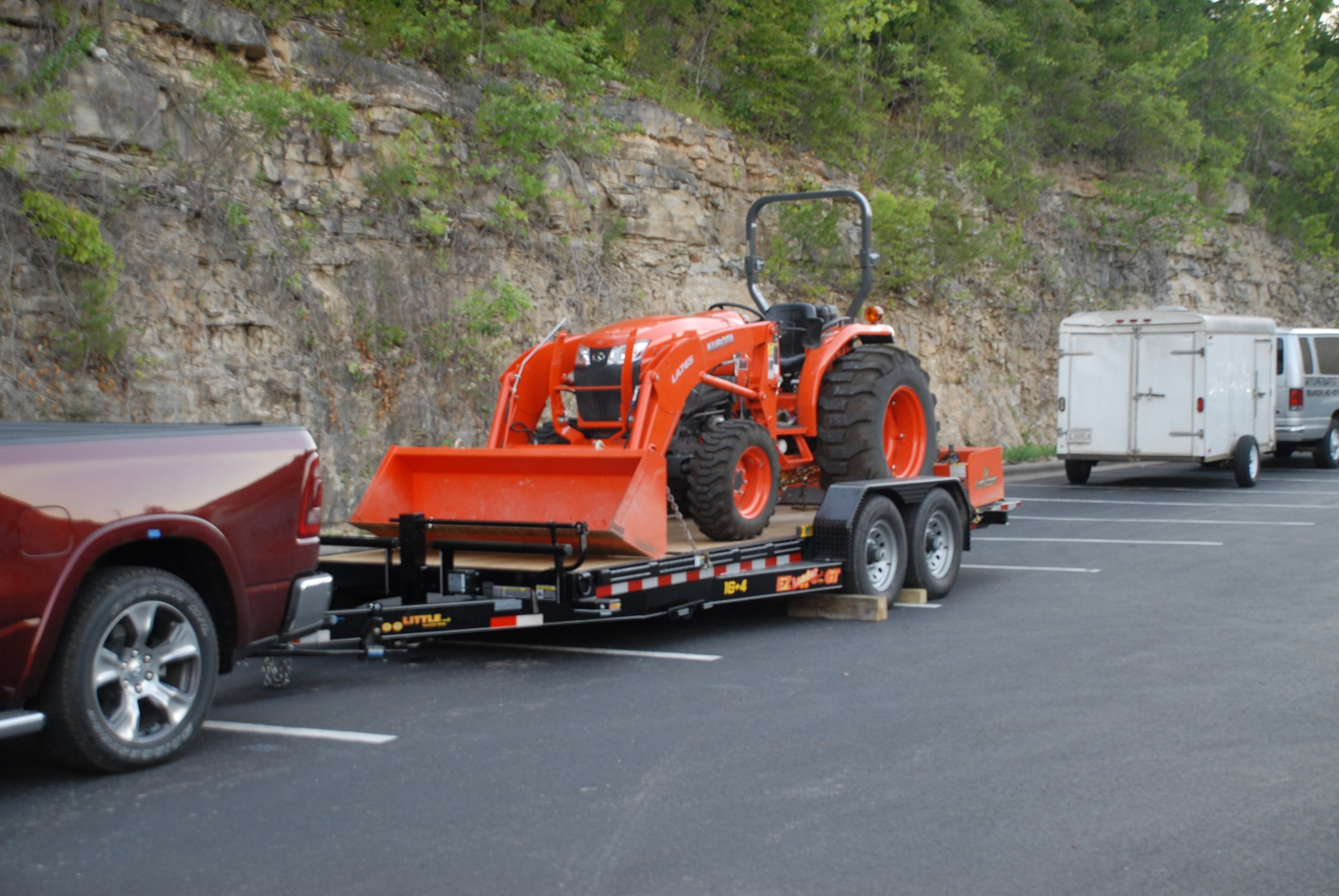

my 20' equipment trailer sits level unloaded. my truck I leveled.
I set my hitch's ball height so the empty trailer's hitch is just about a inch or so below it.
When I load the mini-x I center the load on the trailer so the trailer sits level then roll forward about 6" to add a little more weight on the truck.
Truck and trailer still sit level and handles perfectly. trailer tires all wear the same. Keeps the steering geometry correct as well.

Here are some pictures I just took of my truck, trailer and suspension travel. With the empty car trailer, my rear fender well is 3/4" higher than the front. When I load my Ford pickup (5500 lbs) the truck will drop another 3/4" and I will be level and loaded. Or about a 3" total drop from my empty truck as delivered, new. I have about 500 lbs of Tools, chains, binders and etc., so it probably starts out an inch low from the get go. Note the bump stops. I don't have 5"-6" of suspension. That is about a 2.5" gap with the empty trailer. I need at least 1.5-2" of wiggle room for suspension travel before bottoming out (a no no).
