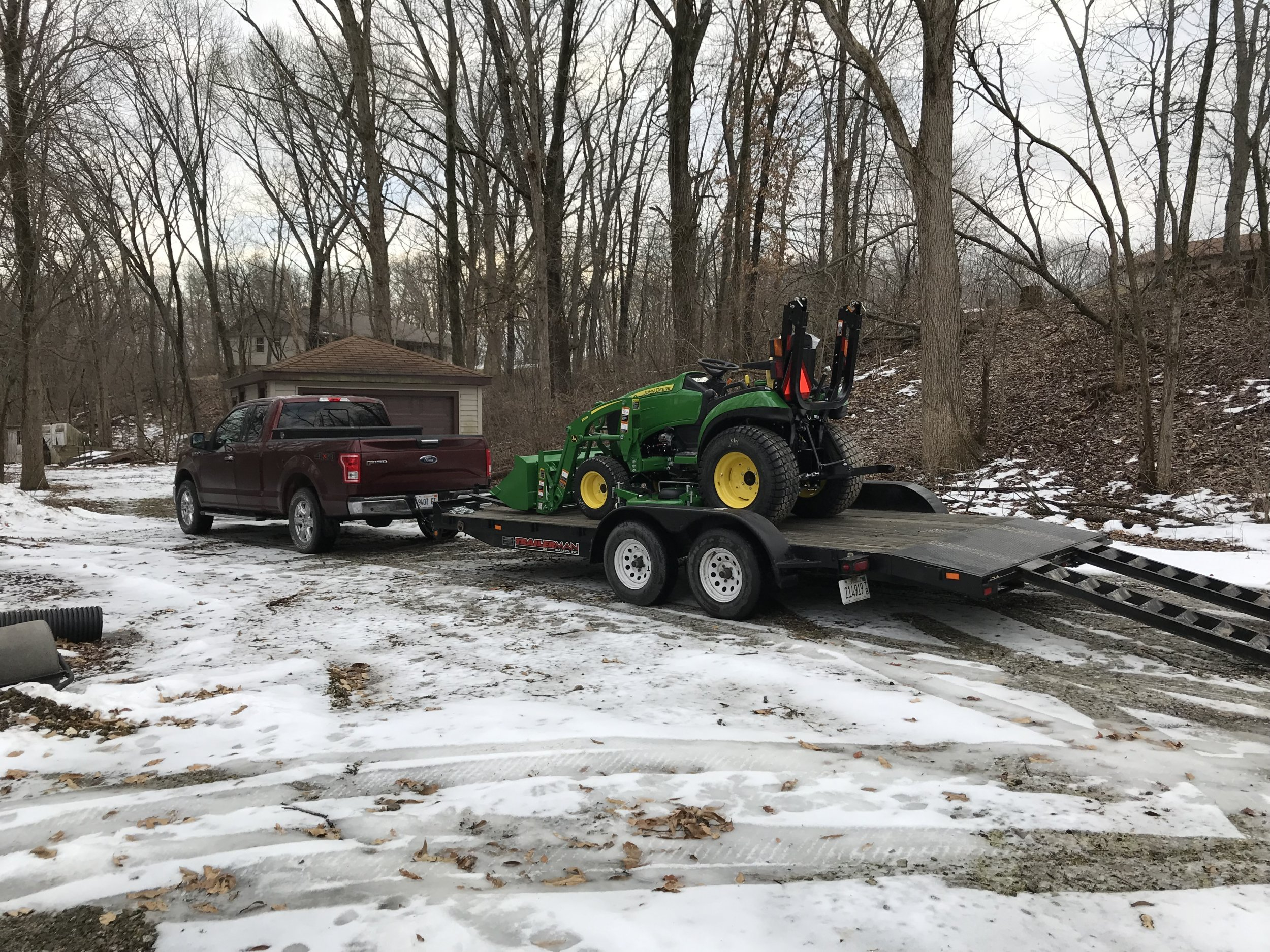

I have actual experience with something very similar. We moved from Green Bay Wisconsin to North Georgia...nearly 1000 mile trip. I purchased a dual axle 20' long equipment trailer and hauled my Deere 5065E with FEL and bucket with my 2005 Nissan Titan LE with no issues at all. It is very important chain the tractor to the the trailer with binders and its important to use the right tie down locations on the tractor.

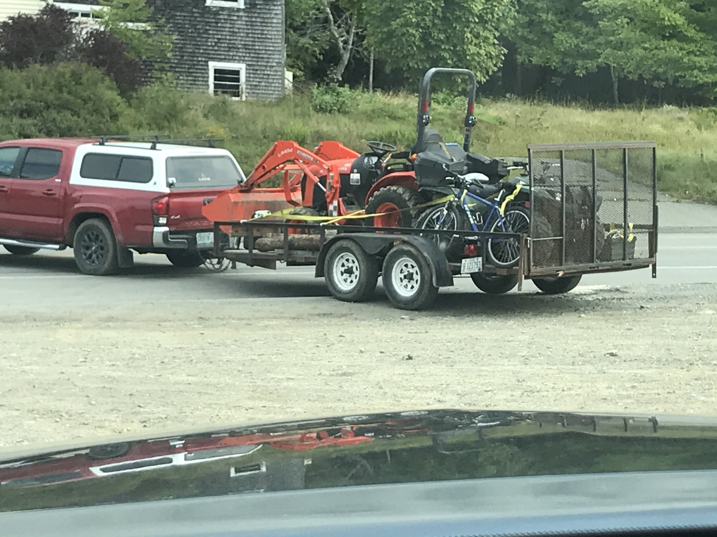

My b-i-l just drove from the Black Hills up the Al-Can highway to Soldotna, finishing on Saturday evening. He used his F150 w/ the 3.5L EcoBoost (larger of the 2) to pull a 10k rated trailer. No tractor, but loaded with UTV, 2 chest freezers, a dozen tubs of powder, ammunition, tools, whatever heavy stuff he needed to move. I believe it may have been close to the ratings, knowing what he had and what he does. There are numerous grades on that road that are not enjoyable. The F150 pulled the trailer just fine, but the tow/haul mode doesn't do squat on a 10% 3 mile long grade going down. There is just no engine braking from that little 6 cylinder like you would get from a bigger V8 (gas or diesel). He had traded off an F250 diesel a year ago because he didn't think he needed it anymore. The F150 got the job done, but after that 10% grade, it flashed up a large wrench on the dash. They pulled over at the next cell phone signal and called a couple dealers, but they couldn't diagnose it over the phone. The nearest dealer on their Covid-restricted route was 900 miles ahead. They let it cool down an hour (engine, transmission, AND brakes), then continued. No more wrench, but it sure made them nervous the rest of the trip. Help is not around the corner. I guess my point is that I think tow ratings are for bragging rights, not necessarily function.
