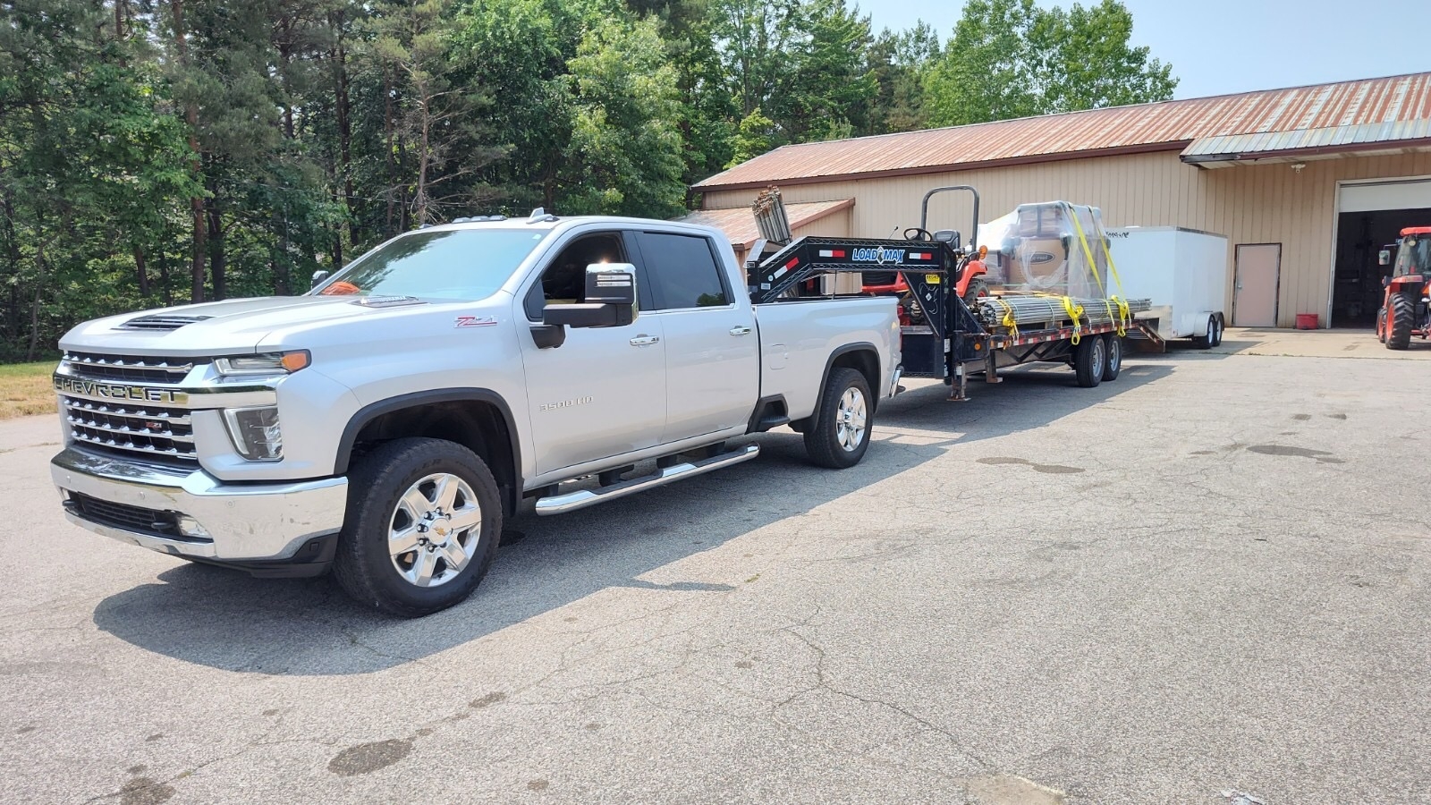

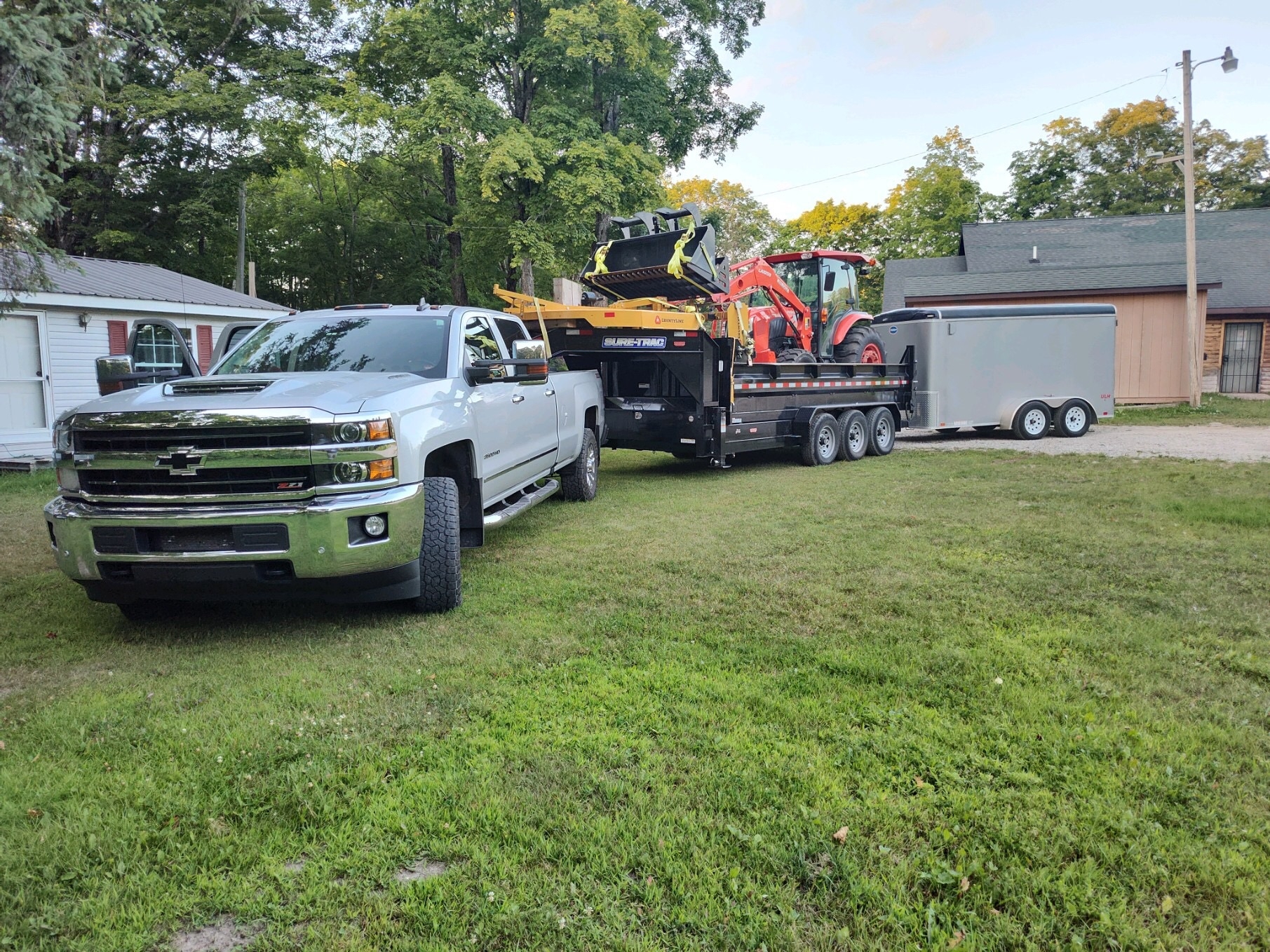

Chevy duramax 3500 pulled from Michigan to Alaska no problem 29,100 #
