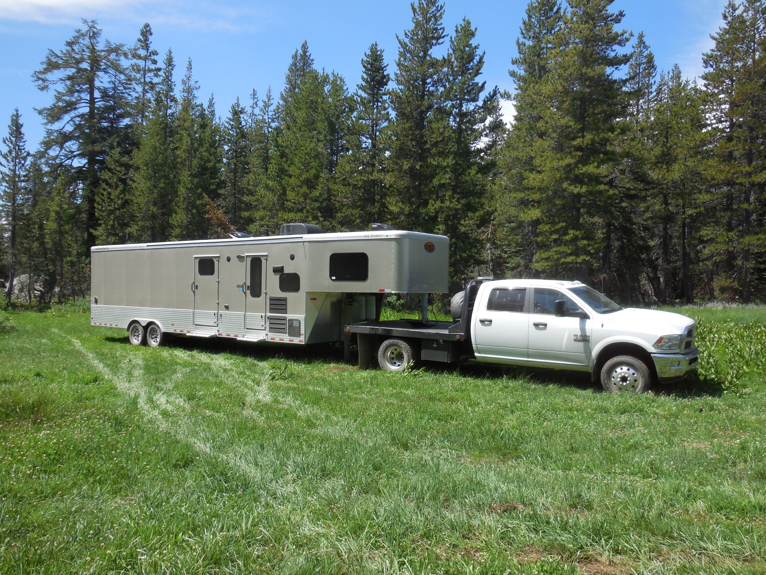

That's why I ordered disc brakes for my 25K trailer, pulled by a 9.400-lb. 3500, even though I rarely use them.

That's one thing I really like about my toy hauler - couldn't get too much weight behind the axles if I had to, since the garage is centered over the axles.
But I wouldn't recommend pulling it with a 1/2-ton as it puts around 5,000 lbs. on the rear axle, regardless of what's in the garage.
