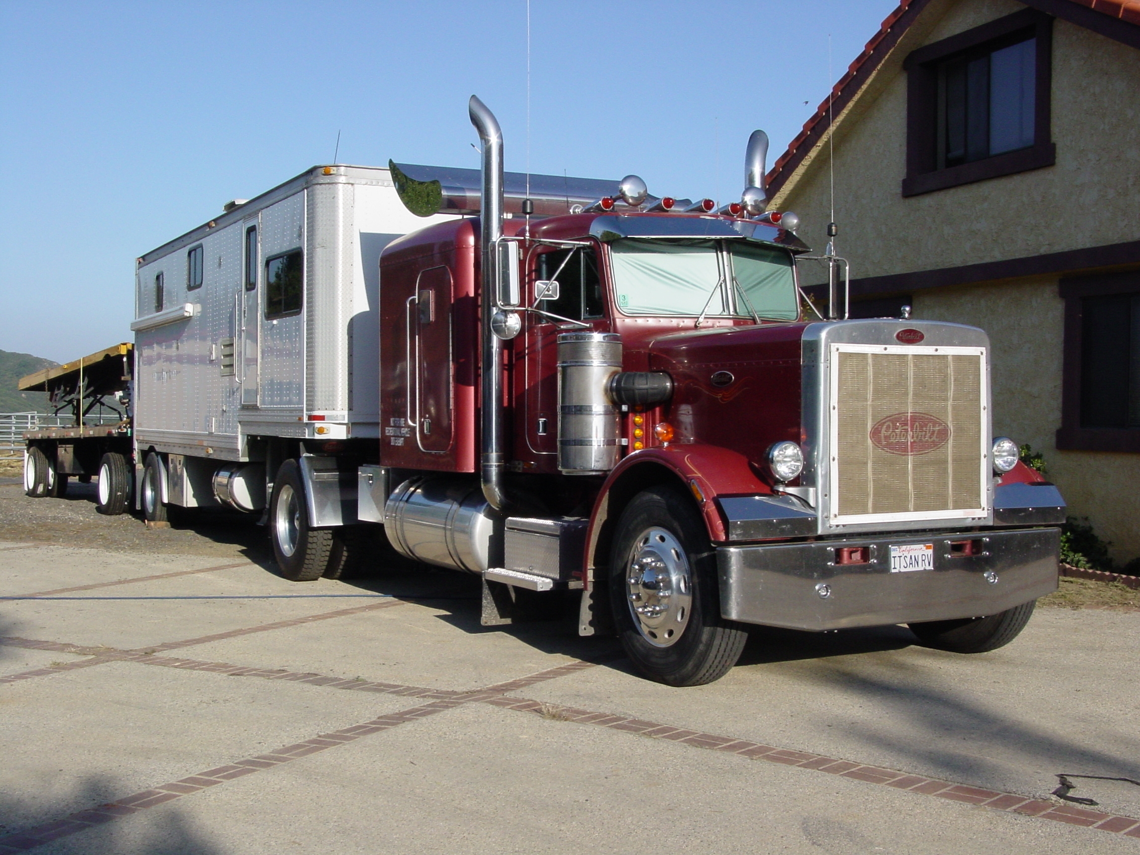

Everyone should just get a Class 8 rig in order to tow any weight over a wagon.
Which is exactly what I did, and never regretted that decision one bit.
Not only was it a great learning experience figuring out air brakes and such work(or even how to drive it in the first place), but it was great to be able to pull whatever I wanted, and go up to 2,000 miles without having to stop for fuel.
That it would beat some cars up long and steep grades when pulling only 33,000 lbs.was a bonus, but being able to stop whatever the total weight happened to be was great.
It did cost me $20K and would only get around 8 mpg, but at least parts for it were cheaper than the corresponding parts for a pickup (except the engine itself).
Trucks should really never have a rear end ratio lower than 4:1, and I'll continue to order them with this option as long as it's available, although presently 3.93 is as close as I can get in OEM. It gives better torque off the line when towing, wider separating between gears, and crisper gear shifts you can actually feel.
Also, for all the guys mounting big tires, I can't imagine doing it on less than 4.11:1. I think my last lifted truck (25 years ago) had 5.38:1 diffs.
That Pete had 3.73 gears, which were perfect with the 44-inch tires and the 18 speed I put in it. My Ram 3500 DRW also has 3.73s with its puny 235/80R17s.
It's a different, more fun, and much safer world than towing with toy "trucks", and by toy I don't mean Toyota, but 1/2-tons.
