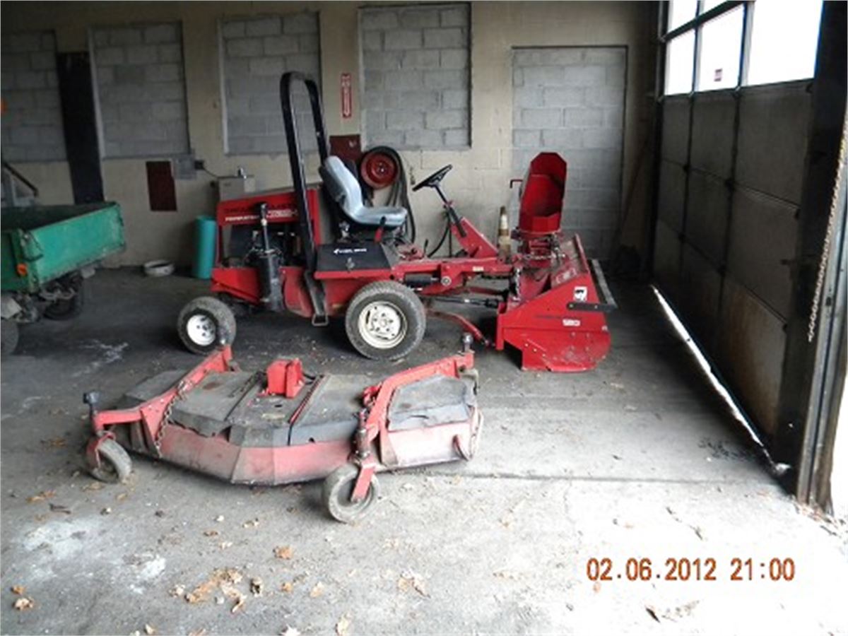

Hi All
I just got a nice Toro Groundsmaster 325D in good shape with a Cozy Cab and a Toro 150 snow thrower. The challenge is that I don't have the "Quick Attachment Kit" to make the connection from the arms to the thrower. The parts are amazingly expensive. Does anyone have any suggestions on how to get the thrower attached without the kit?

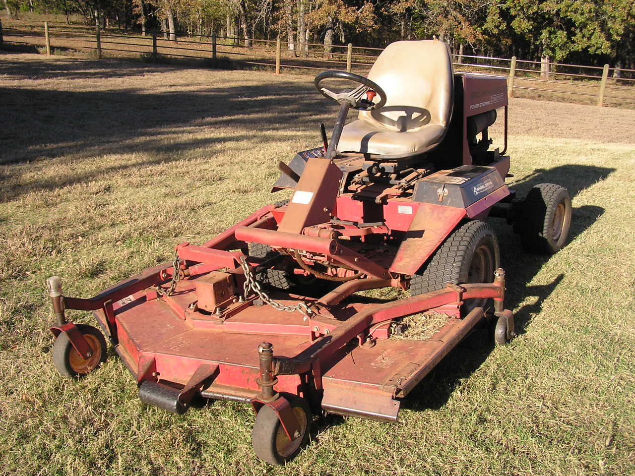

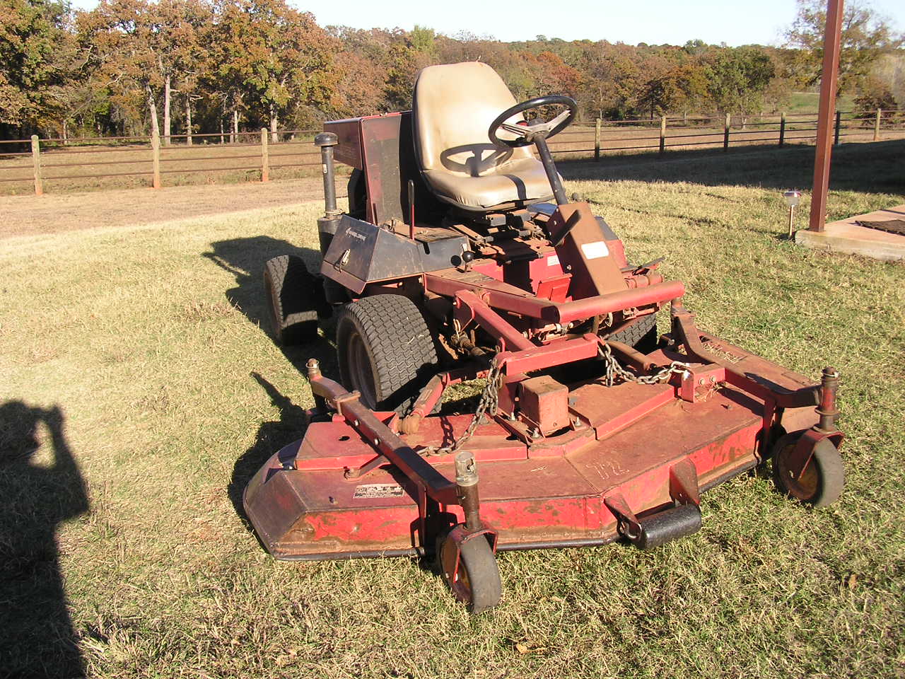

Pictures of yours would help. The Quick Attachment Kit is to make it quicker and easier to switch between the mower deck and other attachments.
You should be able to use the standard bolt on attaching hardware.

Thanks Xfaxman
Mine looks exactly like the first one you pictured here. I guess I understand that the quick attach does make it fast to swap out the attachments. I am having a hard time figuring out how to do without the kit and just make the direct attachments. Do the arms bolt directly to the blower and does the lifter attach to the blower with a chain? Any pictures of a direct attachment would be greatly appreciated.
I will try to provide some pictures tomorrow.
Jack

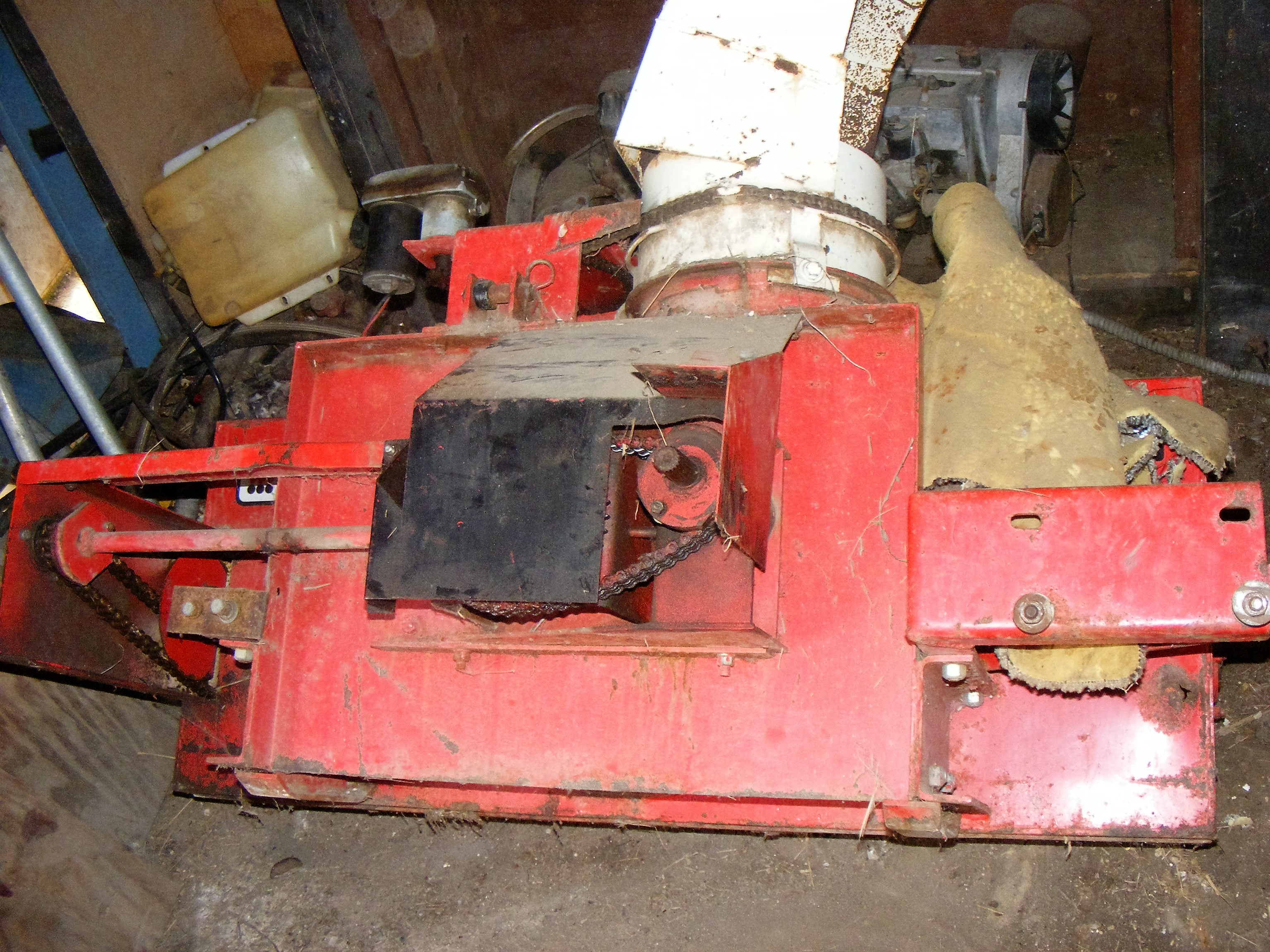

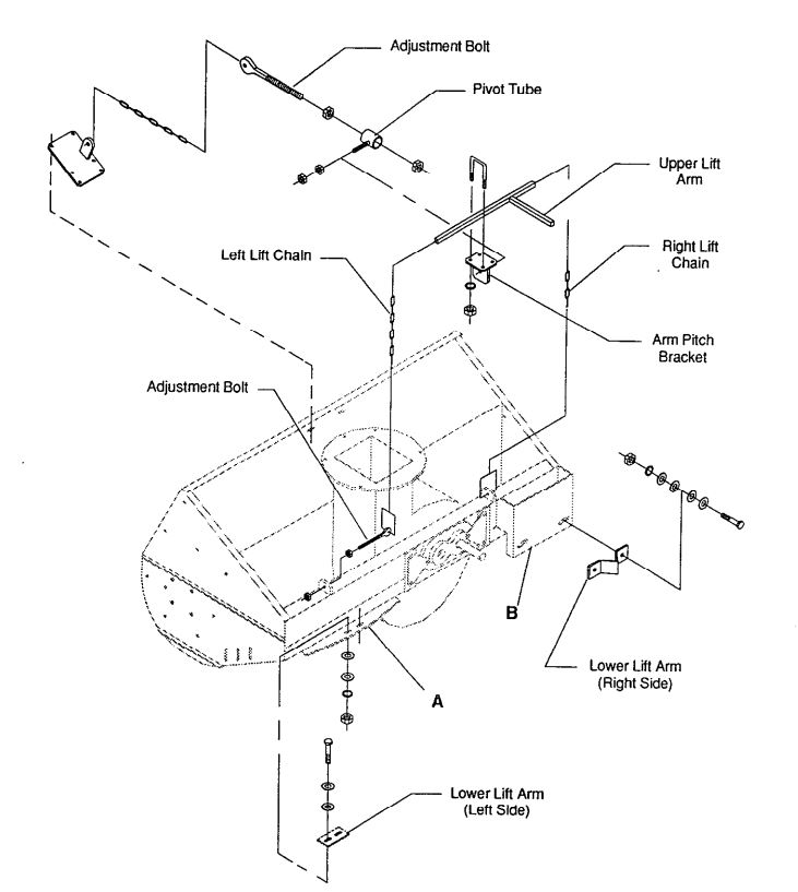

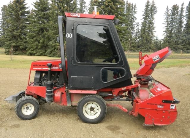

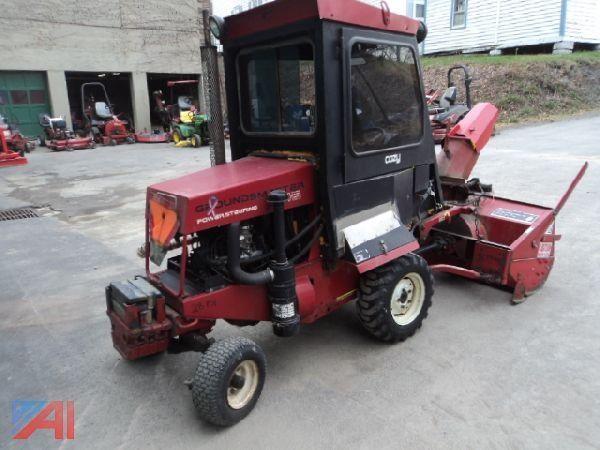

/ Toro Groundsmaster Snow Blower Attachment #4
I have no experience with a snow blower, but here is a picture from a Google image search that shows the right side arm fastened down low.
/ Toro Groundsmaster Snow Blower Attachment #5
A better picture, you can see the lift chain.
you know I just found that one too. It is clear that the same brackets that bolt to the mower deck will bolt to the back of the blower and that chains are used to attach to the hoist. I think I am in good shape. Thanks very much. Now I just need to source a wiring harness from the chute motor to cab.

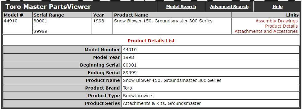

Now I am looking for pics of how the snowblower mounts. I do not believe mine to be mounted correctly - no chains are hooked up. It tilts heavily to the left side.
Toro said if I could find a unit that has the Toro model and serial number they might be able to help me.
They said the 150 number doesn't work. They need the Toro model number off the snow blower. Like the 325D is model # 30795
Found it. Toro 150 Snow blower for 300 series machines Model 44910
Who would have thought Toro would spell Snowblower in 2 words.

/ Toro Groundsmaster Snow Blower Attachment #13
The model number is 44910. but no assembly drawing available.
Here is the link to the operator manual: https://www.toro.com/getpub/19730

Chains would hook to the upper lift arm, the same as a mower deck.
Found more pictures, but hard to see chains.

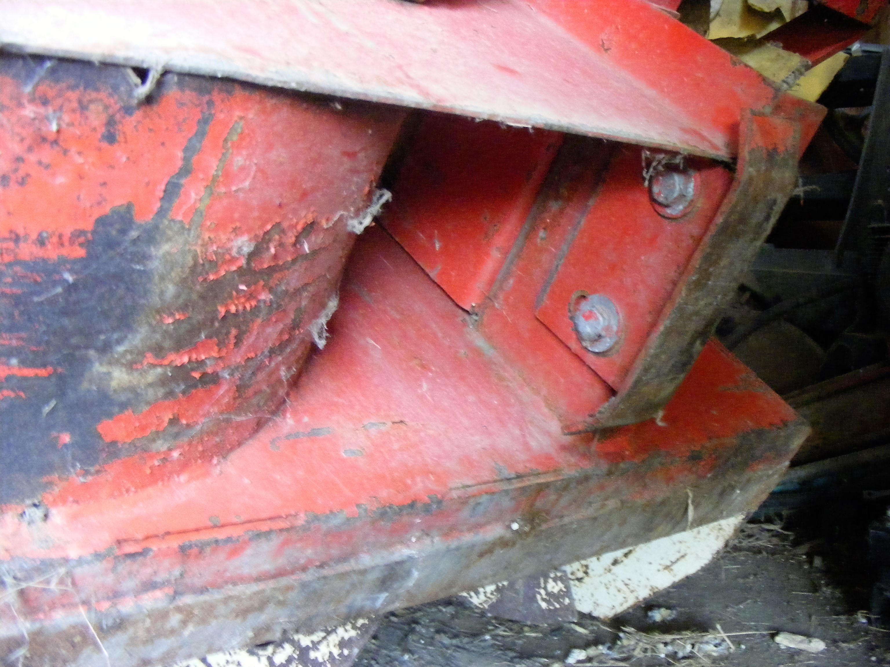

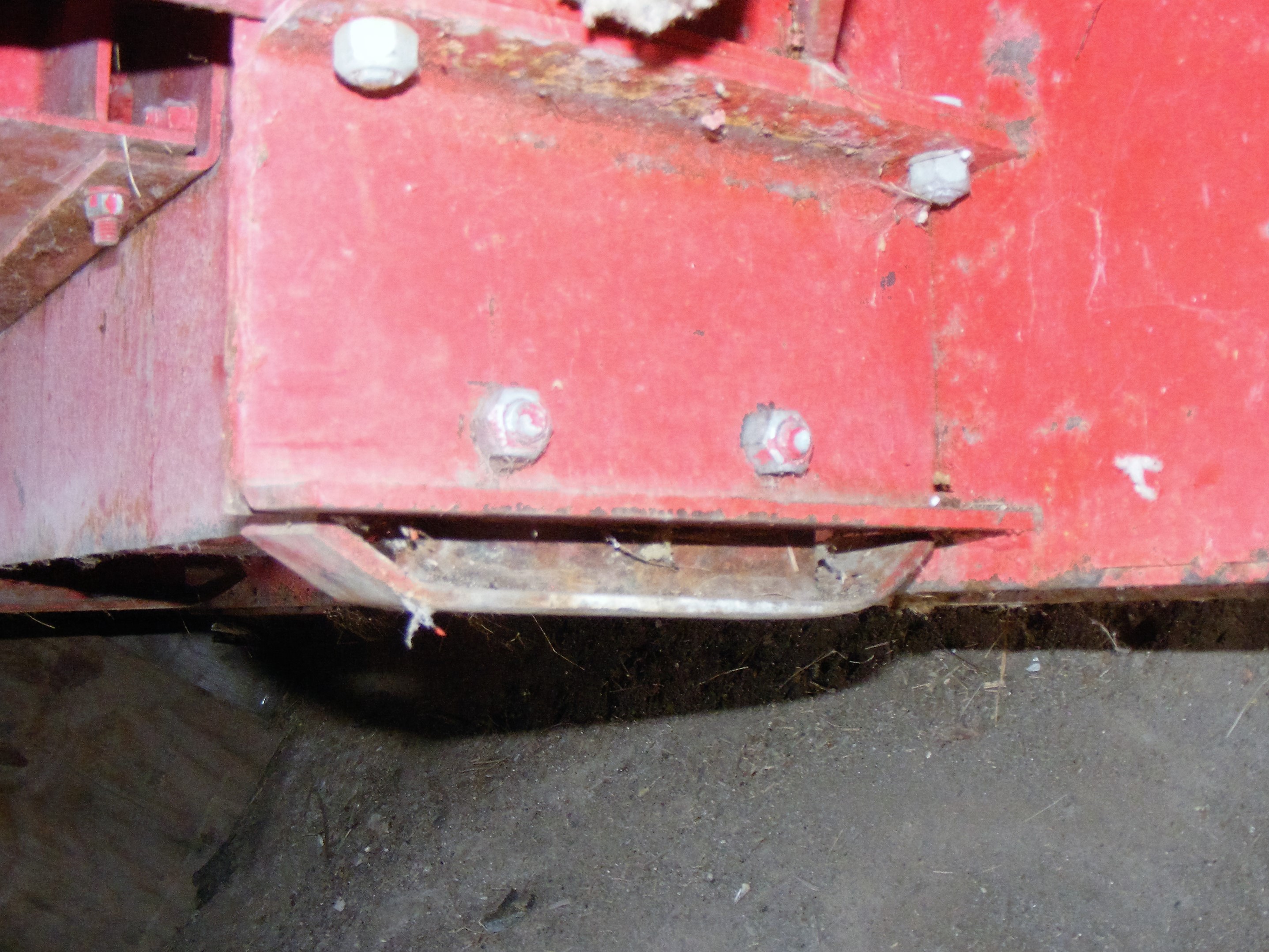

/ Toro Groundsmaster Snow Blower Attachment #18
My snow lander has adjustable skis on it. looks like a piece of angle iron with the ends curved up, they are slotted on the sides to adjust them up or down on the bolts. I had to buy two tubes of colored rubber calking to fill in the holes on my vinyl siding , I can not hit anything with a gun But I do not not miss a thing with that blower and a hand full of gravel. My Toro GM72 did not come with rear weights and with the blower on it will stand on its nose a lot when letting off the hydro peddle to quickly so I hung weights on the back. With deep snow I lift it all the way up and can drive in 3 foot or so then back up and let it down ,then go again. So I know that trying to hold the blower up 2 inches with the cylinder will not work well. As the drive tires climb up so does the blower,and the same goes when the drive way climbs up and the snow blower does not, floating on the wheels or skis is the best. My angle iron is aimed under the blower so as not to lift it from the outside of the path of the blower. Maybe some snowmobile skis or pickup truck snow plow shoes? Hope your cab is bigger then mine, I am 5 foot 10 inch and 240 pounds , I feel my hair touching the headliner and I have to turn my shoulder forwards to shut the door with no coat on, but it is so small you wont need a coat on. Before putting on the weights I had a roll of paper towel in there to wipe the slobber off the windshield from standing it on its nose, then the fan up in the right hand upper corner to keep the fog off the windows, it is a plastic blade and don't cut you but sure adds to the anger, but this cab doubles as a roll bar ROPS and has a 2 x 2 steel tube that is cold and hard at the top of the windshield.

/ Toro Groundsmaster Snow Blower Attachment #20

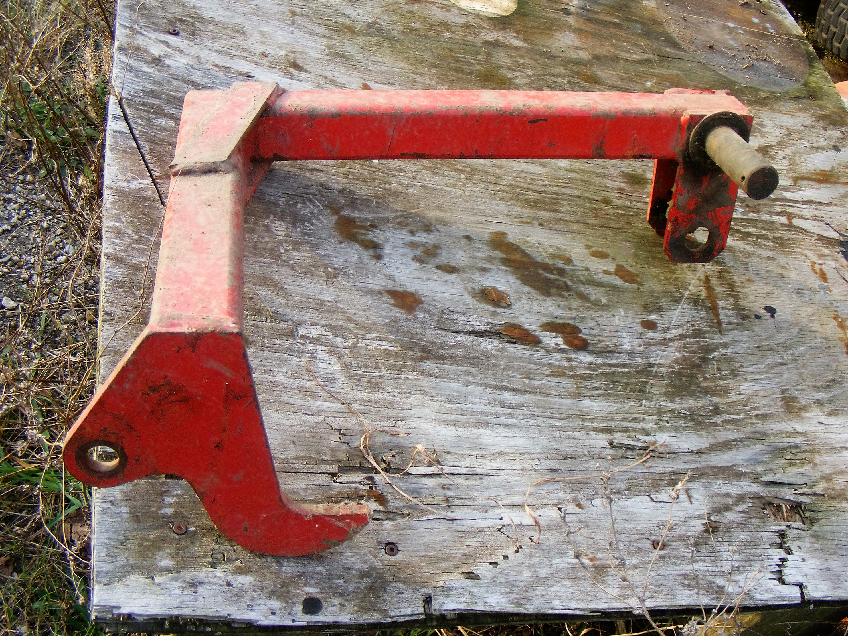

I went out to mine and tipped it up and took pictures of the skis and the lift arm that I change for the blower. Not quite how I remember it but pictures don't lies outside of photoshop .DSCF1135.JPGDSCF1136.JPGDSCF1139.JPGDSCF1140.JPG
