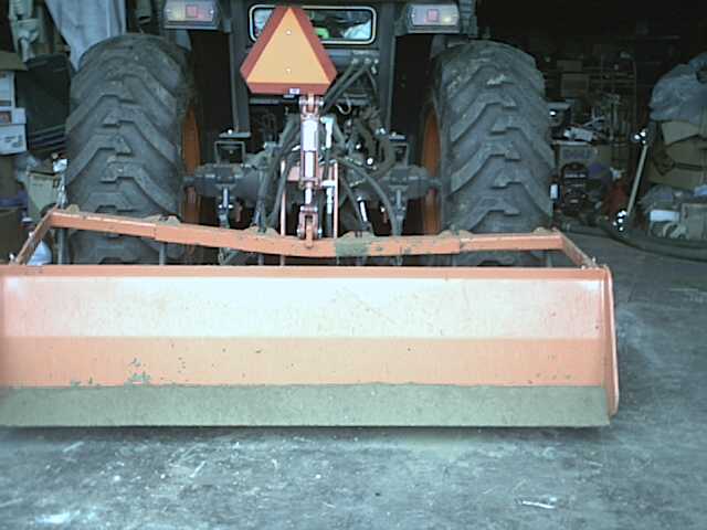

Harv, I was looking at the pix you posted, again, and it sure looks to me that the manual and hydraulic versions are exactly the same. Therein probably lies the problem. You sure don't raise and lower the scarifiers on the manual version while in full operation (max load). So the mechanism was probably built and "perfected" for the manually operated version. Just add a hydraulic cylinder and voila, disaster. Of course it will work if you stop to use the hydraulic raise/lower, the mechanism was designed and or evolved to do that successfully. So I guess my sales rep from the Kubota dealer and I made an unwaranted assumption about being able to raise/lower under way. Yup, I gotta get the industrial version. I'm told it is made to raise and lower while under load. I haven't seen a picture yet but was told the mechanism is totally different (why am I not surprised?). Now the only question is price and size. If I will spend enough to get the 4C2 version and what width can I reasonably pull, 76 or 80 inch?
Thanks again Harv, the pictures showed me what the deal is.

Harv, glenmac, Here is the latest chapter in the ongoing saga of my box blade. My Kubota salesman did all the interfacing with Cammond. From the representations made to him by factory personnel he was optimistic that I would get a "one time special good deal" as a customer service PR thing. The capo di capi (BOSS of BOSSES) finally got back into town on Tue and today made his final offer. I pay them $50 dollars to repair the damage I did to the boxblade subsequent to their initial waranty repair. Then I give them back the box blade in trade for a larger and more expensive blade with no particular price break. I want to be adult about this and not bite off my nose to spite my face so given my needs and time constraints and convenience I will take the deal. I will also comment further about this situation.
The instruction book does NOT say to stop the tractor prior to raising and lowering the scarifiers. That isn't expected with their other models and wasn't mentioned up to and beyond the time of the first waranty repair. The Kubota guy Kevin D. Luper, a prince among men, asked Cammond about that and in light of the fact that I did operate that way and experienced additional difficulty with their clearly inferior underengineered product which bent like a soggy pretzel, they said you can't do that. A bit late, I think. If that was their position why wasn't that information in the operator's manual. Plenty of other info was in there. If there were a distinction in the required operation between this sorry piece of crap and their industrial rated equipment (rumored to be better) then why didn't they mention it?

If I am understanding you correctly, I am not sure any box blade will do what you want. The heavy duty box blades with the swinging scarifiers that I have used will not allow you to lower the teeth while you are pulling the box through the dirt. The hydraulics simply are not strong enough to push the teeth into the dirt while under load. The Gannon/Woods 4272HD box blade I use is the heaviest duty BB I could find. The ripper bar uses a 3" hydraulic cylinder and is not strong enough to work the way you desire. The manual says you need to stop the tractor before you lower the rippers. There is a mechanical cam that locks in place once the rippers are down. This cam is what carries the load on the rippers so the hydraulics are not loaded all the time. I will do some BB work this weekend and try to lower the rippers on the Gannon to see what happens. I do know that the unit is so heavily built it will not bend anything by trying.
If you are otherwise happy with the blade you have, I would check to make sure someone on this board has actually used the Gearmore in the manner you described before spending the extra money. I know the Gannon heavy duty blades will not do what you want.

I checked my Gannon box blade today. It will not fully lower and lock the scarifiers if the box is being pulled through the dirt. It did not bent anything. I can hear the hydraulic relief valve open up if I try to lower the scarifiers while the box is under a load.
Hope this helps.
