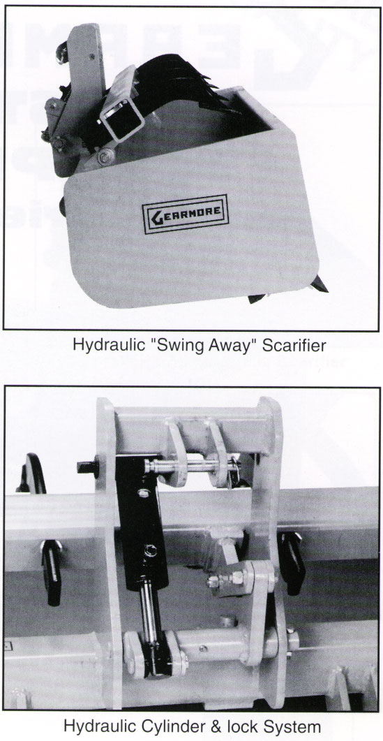

Harv, I was looking at the pix you posted, again, and it sure looks to me that the manual and hydraulic versions are exactly the same. Therein probably lies the problem. You sure don't raise and lower the scarifiers on the manual version while in full operation (max load). So the mechanism was probably built and "perfected" for the manually operated version. Just add a hydraulic cylinder and voila, disaster. Of course it will work if you stop to use the hydraulic raise/lower, the mechanism was designed and or evolved to do that successfully. So I guess my sales rep from the Kubota dealer and I made an unwaranted assumption about being able to raise/lower under way. Yup, I gotta get the industrial version. I'm told it is made to raise and lower while under load. I haven't seen a picture yet but was told the mechanism is totally different (why am I not surprised?). Now the only question is price and size. If I will spend enough to get the 4C2 version and what width can I reasonably pull, 76 or 80 inch?
Thanks again Harv, the pictures showed me what the deal is.
Patrick (anxiously awaiting Monday or Tuesday or)

<font color=blue>I haven't seen a picture yet but was told the mechanism is totally different</font color=blue>
Patrick -
If you back up and take a look at this post, you will see an example of the industrial line. The attachment for that post shows a close-up of the raise/lower mechanism, too.

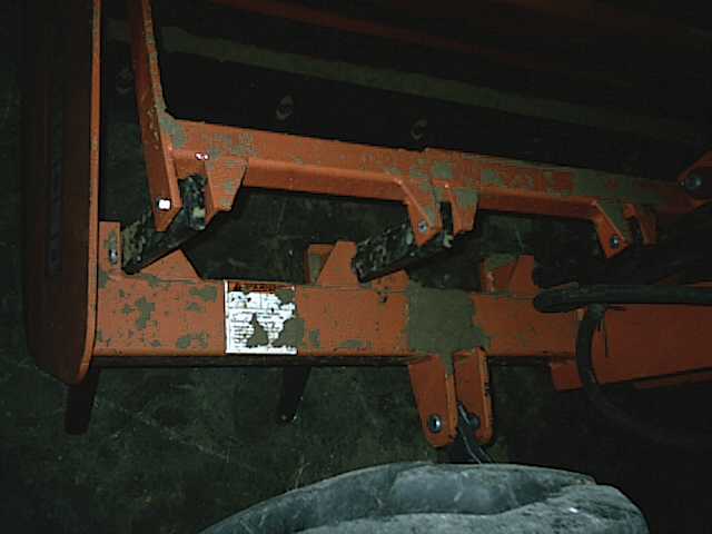

Harv, glenmac, Here is the latest chapter in the ongoing saga of my box blade. My Kubota salesman did all the interfacing with Cammond. From the representations made to him by factory personnel he was optimistic that I would get a "one time special good deal" as a customer service PR thing. The capo di capi (BOSS of BOSSES) finally got back into town on Tue and today made his final offer. I pay them $50 dollars to repair the damage I did to the boxblade subsequent to their initial waranty repair. Then I give them back the box blade in trade for a larger and more expensive blade with no particular price break. I want to be adult about this and not bite off my nose to spite my face so given my needs and time constraints and convenience I will take the deal. I will also comment further about this situation.
The instruction book does NOT say to stop the tractor prior to raising and lowering the scarifiers. That isn't expected with their other models and wasn't mentioned up to and beyond the time of the first waranty repair. The Kubota guy Kevin D. Luper, a prince among men, asked Cammond about that and in light of the fact that I did operate that way and experienced additional difficulty with their clearly inferior underengineered product which bent like a soggy pretzel, they said you can't do that. A bit late, I think. If that was their position why wasn't that information in the operator's manual. Plenty of other info was in there. If there were a distinction in the required operation between this sorry piece of crap and their industrial rated equipment (rumored to be better) then why didn't they mention it?
It would be too bad if this or any subsequent posts (stand by) prevented any sales of their product with either the Cammond or Gearmore labels.
I have questions: How was I supposed to make a determination that this piece of crap couldn't be operated like its big brothers? Maybe by the laying on of hands to feel its aura or perhaps with a OUIJA board? With one it is OK but with the other it isn't? Of course the prohibition was only issued after the second episode of equipment failure. I think maybe if it were in the operator's manual then I legitimately would owe them for repair and the first repair which they did for free was a boon. It became, not their problem when it recured. Very interesting.
The way that the vox populi is heard is sometimes in the marketplace and sometimes in the courtroom. It is only $50 (for the repair) but lost time and a drove of other issues with monetary consequences are beginning to bubble to the surface any moment now, perhaps. Small claims court seems like a reasonable way to redress my grievance. I hope the big boss has time to represent himself conveniently as lawers are not permitted. Seems like a slam dunk to me. I think I had every reason to believe I could use this equipment in this way since all the other models are used that way and my instruction manual did not prohibit it for this model. If I had an expedient alternative I would take it to avoid contributing volume and profit to them through this additional sale.
I paid nearly $800 for this useless toy and it will cost me about $700 more (plus the $50 repair charge) to get something that is rumored to be usefull. The only good news is that I can probably get it tomorrow. We are coming into the fall rainy season and need to get some things done yesterday with a box blade.
Through all this my Kubota salesman at Chaprell Dodge/Kubota on Broadway in Ada, OK has tried to get me the best deal possible. Kevin D. Luper put himself through college brush hogging and has an extensive farming/ranching background and knows what he is doing. He thought I was not expecting anything that he himself did not expect.
In sharp contrast to the treatment I'm receiveing from Cammond, Chaprell Dodge/Kubota are truly customer oriented. On the way to the dealer to return my box blade this afternoon, I overheated my little Dodge Dakota due to coolant loss. Stopped on side of highway looking like a geyser (not geezer). Nearby body shop gave me two gallon jugs and let me use their water to refil my radiator. The owner says, "here take this one too, its coolant, that will help keep it cool. Is that nice or what? Gave me a gallon of anti-freeze/coolant! When I get the Dakota painted he'll get to bid the job, you betcha. Anyway a lady stopped to ask if I needed a ride while I was pouring water into what looked like "Old Faithful" at Yellowstone. She followed me all the way to the next town to the Dodge/Kubota dealer, just in case. Is that nice or what? I get there and tell the service manager sketchy details of my problem and he gets a mechanic on it IMMEDIATELY. They fix the split hose, fill me up with coolant and (drum roll please) refuse to fill out a ticket. It is a freebie. Then they go in and order me a hose (dealer item). Of course I will buy the hose but still free coolant and free labor to trouble shoot and make a temp fix. Pretty nice, I think. Note all the nice people I dealt with today? The guys fixing my truck had no idea whatsoever what was going on in the Kubota and implement portion of my visit or that there was a tractor side to it at all. They were just being accomodating to a customer.
And then there were the results with Cammond/Gearmore in total stark contrast to virtually everyone else I talked to this afternoon. Sort of paints a picture doesn't it. Given a fresh start and knowing what I know now, I wouldn't get anywhere near their products irrespective of how good some of them may be reputed to be. I'll paint over their name on the side of my new one to avoid advertising for them.
Given two equivalent implements from different manufacturers and knowing what I know about Cammond/Gearmore's business practices regarding customer service, good will, and the like, I would rather buy from soneone I knew nothing about than contribute to the likes of Cammond/Gearmore. Of course Cammond/Gearmore box blades de junk are blissfully unaware that the negative publicity that can be generated by one motivated extremely dissatisfied customer could easily reduce sales sufficiently to exceed the $50 they extorted out of me by an order or two in magnitude. This is sometimes referred to as stepping over the dollars to pick up the dimes. How myoptic can one "business man" be?
If I weren't in such a cheerfull mood due to having dealt primarily with good folks today I would not hold back in such a reserved manner but would instead tell you how I really feel about those (*&^ing (*%*ers.
Of course thats just my opinion, you might like to do business with such people.
Patrick
P.S. This to is NOT an urban (or rural) legend.

The fifty dollars to fix the box under WARR is a bunch of bull. The real reason they want the money is if you do take them to court, it says to the judge that you misused the product. Otherwise why would you pay money to fix a faulty product.
At least your dealer is standing behind you because the boxblade manufactuer sure isn't. I do know a product I will never buy in the future with customer treatment like that.
Good luck
Gordon
/ Top O' the Line Box Blade???? #26
Re: Top O\' the Line Box Blade????
Patrick
If I am understanding you correctly, I am not sure any box blade will do what you want. The heavy duty box blades with the swinging scarifiers that I have used will not allow you to lower the teeth while you are pulling the box through the dirt. The hydraulics simply are not strong enough to push the teeth into the dirt while under load. The Gannon/Woods 4272HD box blade I use is the heaviest duty BB I could find. The ripper bar uses a 3" hydraulic cylinder and is not strong enough to work the way you desire. The manual says you need to stop the tractor before you lower the rippers. There is a mechanical cam that locks in place once the rippers are down. This cam is what carries the load on the rippers so the hydraulics are not loaded all the time. I will do some BB work this weekend and try to lower the rippers on the Gannon to see what happens. I do know that the unit is so heavily built it will not bend anything by trying.
If you are otherwise happy with the blade you have, I would check to make sure someone on this board has actually used the Gearmore in the manner you described before spending the extra money. I know the Gannon heavy duty blades will not do what you want.
Hope this helps.
-Roger

Roger that, Roger. I understand what you are telling me and appreciate your observation. I am not going on my opinion or my wishful thinking. The Cammond people told my Kubota guy that their industrial rated units were made to do that. My Kubota guy is no dummy and he expected the one I had to do it. AFTER it failed, they then say you have to buy the industrial unit to do that. This whole thing would have never happened if they were up front and put the info in the ops manual. I would have either accepted that limitation (and it is a fairly limiting restriction, sometimes) or opted for the "industrial" unit. So the expectation that the *^&%*^& brand will allow the operator to engage and disengage the scarifiers is based on the manufacturer's claims and puts possible failure squarely into the resonable-expectation-of-waranty envelope.
We'll see what really happens. My Kubota guy is going to deliver the replacement to me early next week. Yet another indication of the level of service granted without asking from Chaprell Dodge/Kubota on Broadway in Ada, OK.
Patrick

I checked my Gannon box blade today. It will not fully lower and lock the scarifiers if the box is being pulled through the dirt. It did not bent anything. I can hear the hydraulic relief valve open up if I try to lower the scarifiers while the box is under a load.
Hope this helps.

Hey Patrick, I don't know how I missed this post as it is right up my ally. I have the 72" 2G2 Gearmore. I know of no hydraulic activated scarifier bar that activates under load, they all need to be locked into position, the ram does not hold the scarifier in place but simply swings and activates a locking pin or other device. They must be lowered while the box is up. The picture of the box blade you bent is quite frankly "a weenie" and looks like it is built for a 2 wd tractor. Your L4610 has far greater pulling power then that ripper bar could possibly handle. I have been such a strong advocate here of getting a HEAVY box blade as I have seen many light weight boxes on 4WD change shape. The L4610 could handle a 76" box, but that would be it, don't go wider then that unless your ripping paper bags and pulling dust.
P.S. the only way rippers could activate that I could see under load is if they lowered straight down rather then pivot as both Gearmore and Gannons do. I use the rippers and have boken many shanks but never bent the ripper bar, catch a solid rock with the light box and their gone with a tractor such as yours. If it were me, I would get the 4G2 in either the 72 or 76" width. The 4G2 for the extra weight and 5" pull and ripper square tubes. Anyway, this may all be moot as its been awhile since you posted alot of this stuff, Rat...
