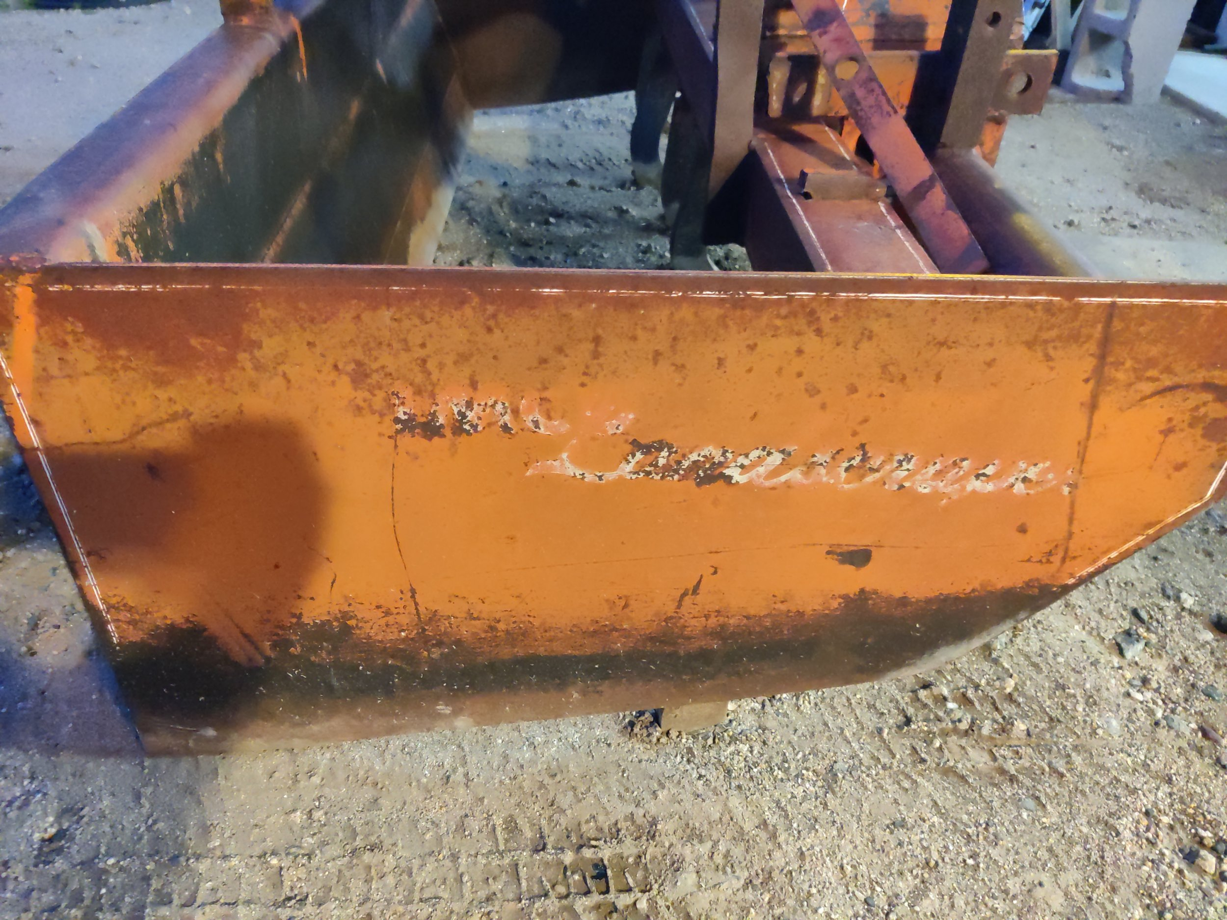

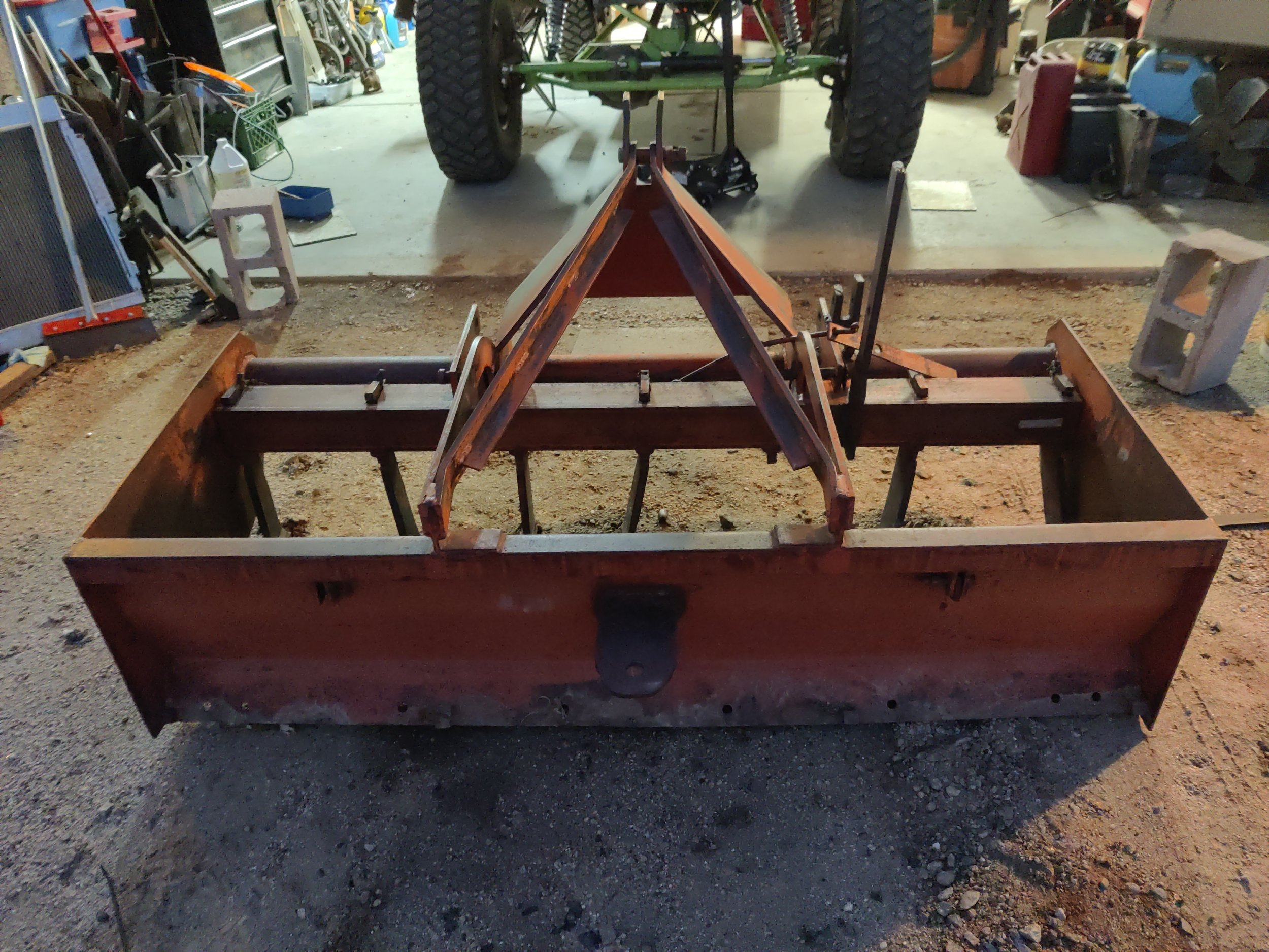

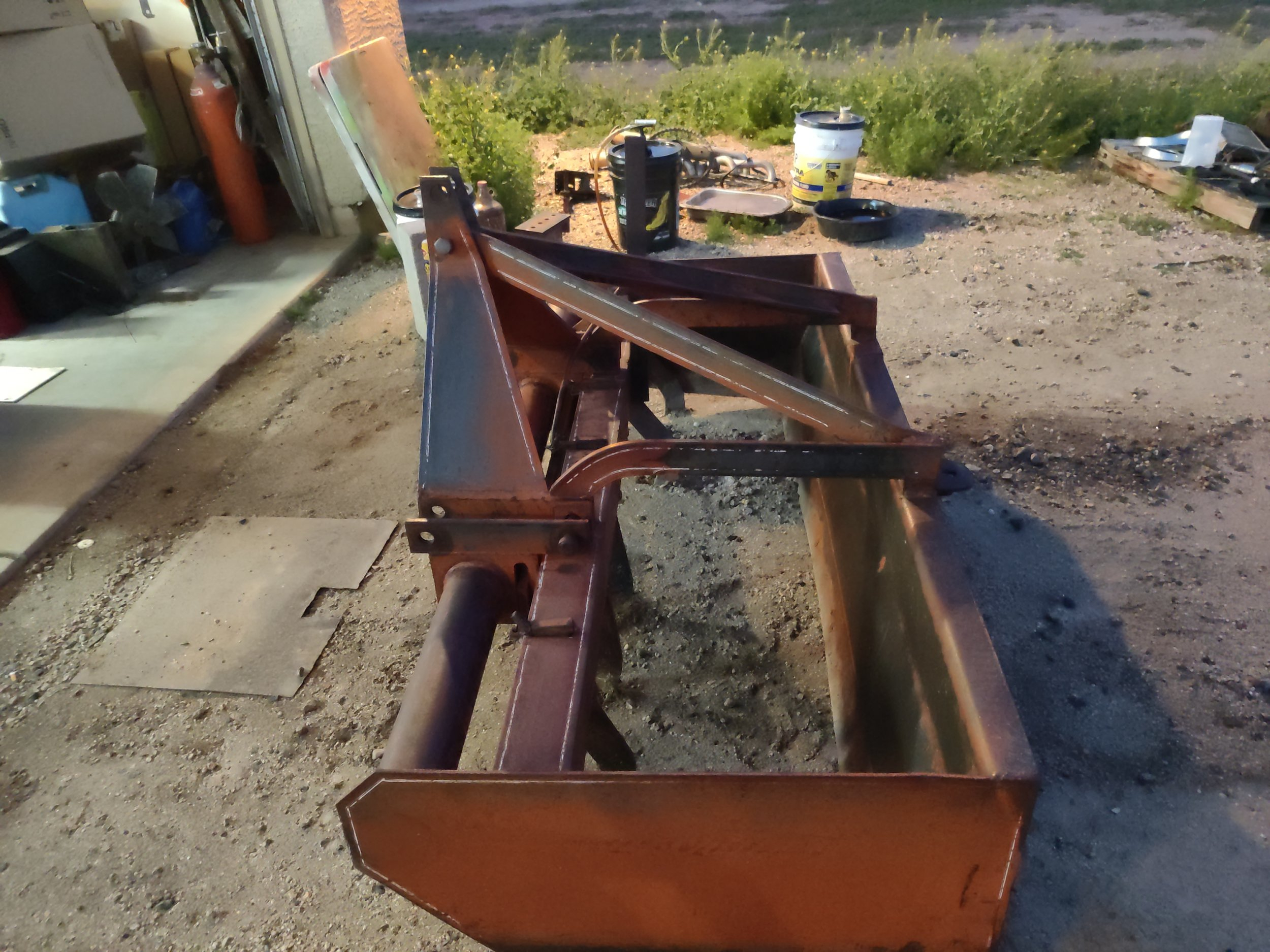

Picked up a box blade today, and just curious what it is I got. Can't really make out what's left of any names/labels on it. Been hunting the classifieds for a few years looking for one, and finally found one that fits my tractor and was within budget (which admittedly is much lower than it should be, lol).
Needs some work still, largely due to farmer "fixes" but it's more labor than cost, except the ripper shanks. One is broken, several are bent pretty badly, though I should be able to straighten them out pretty easily. May have replace 2 or 3. I'll also have to come up with a replacement rear scraper blade. Other things are little like fixing pin holes that look like they were opened up to use it on a larger cat hitch, which will be easy enough to turn some bushings on the lathe that I'll weld in.

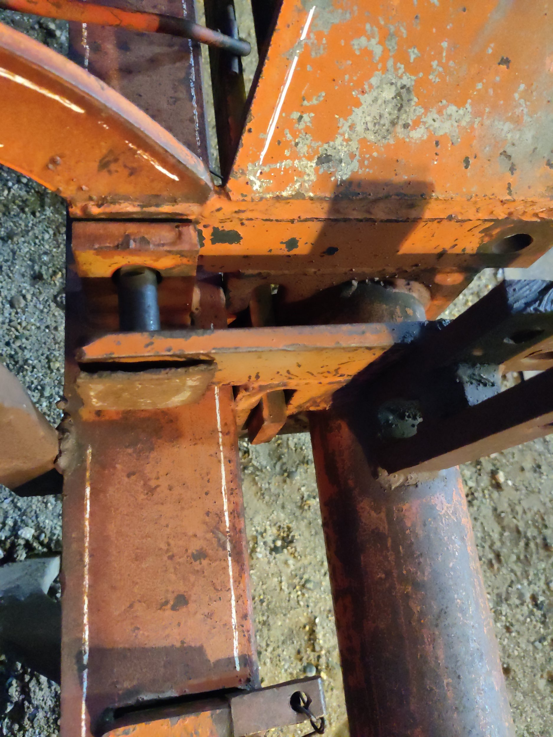

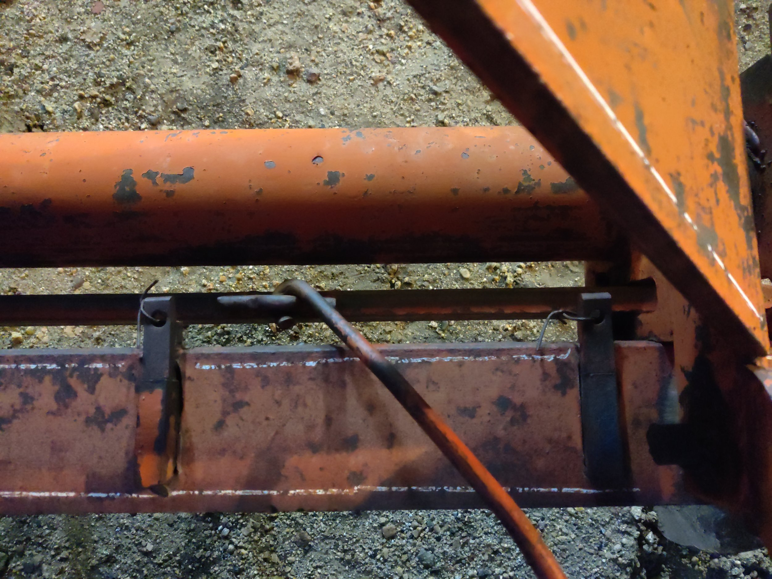

I am curious about this flat bar that runs between the large round tube, and the ripper tube, that has an inch or two of up/down movement, in that I can't figure out what it's for...has a hook welded to it with a handle that looks like it was mounted somewhere to pivot the bar up.

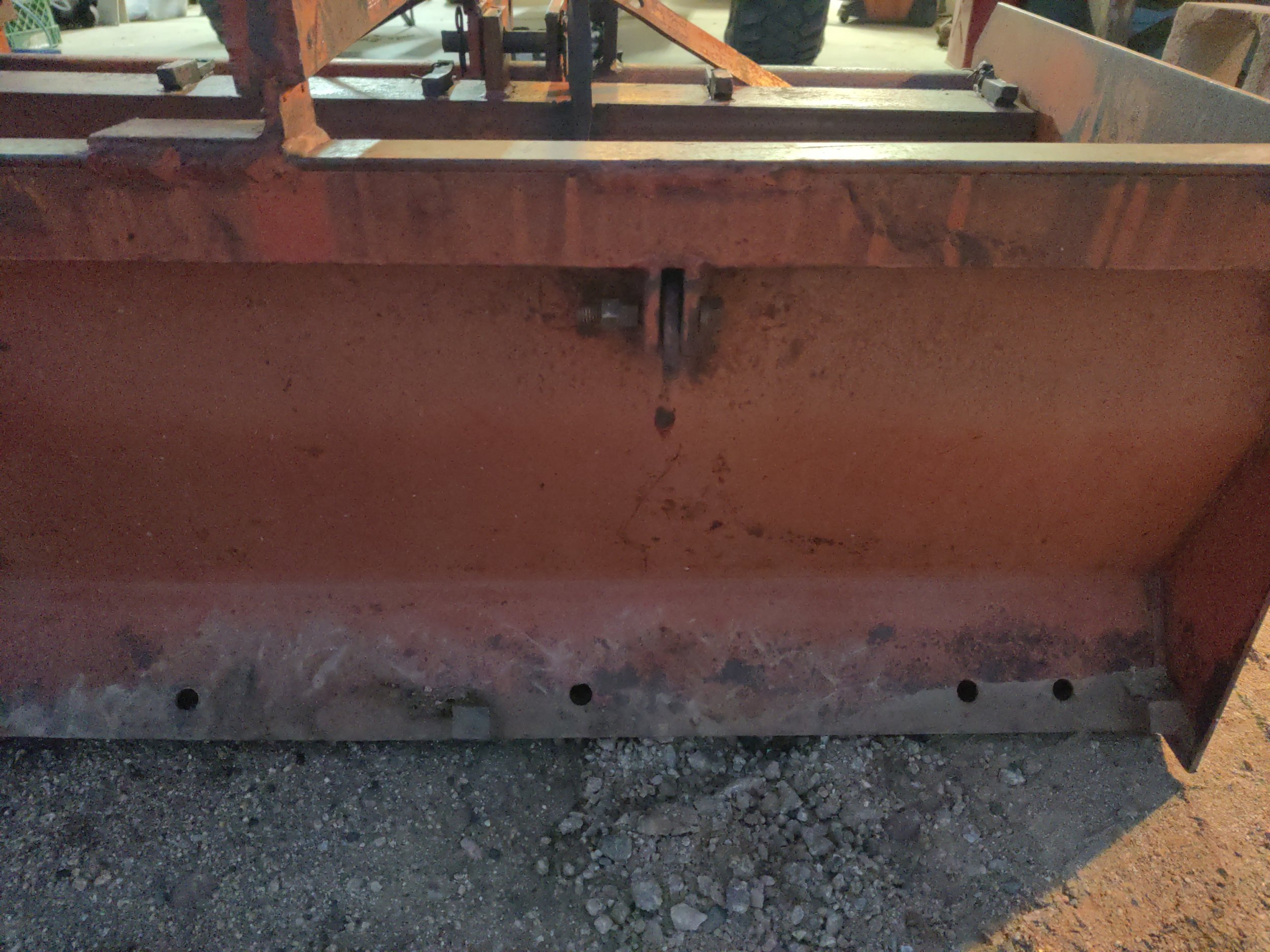

And these two tabs on the very back, on the outside of the back wall. Looks like something hung off it at some point that could be pivoted up, that's since been broken or cut off. There's one either side, about a foot inboard of the side walls.

Dunno, but it looks like it needs the rear blades?
   / What kind of box blade did I just buy? #3
It does look like open bolt holes where the cutting edge was. How much did you have to give for it? I’ve been looking for a used one on the cheap for a while. I can’t help with your other questions.
   / What kind of box blade did I just buy? #4
It definitely needs a rear blade. Operating without it will reduce the box to scrap. Looks like it is missing a large bolt where the toplink support attaches to the box. It looks like it has manual rippers that go up and sown together. Can you confirm? That piece that moves 2 inches may be a locking device for the rippers.
Box cost me $550 plus a 4 hour round trip drive. Probably went through about $50 in diesel going there. That cost is probably high, maybe stupid high, compared to other areas of the country where this stuff is everywhere, but here in the Phoenix area it doesn't exist on a wide scale outside of Harbor Freight grade stuff.... And even then people want $1000+ for old beat up scrap metal. Especially when it's this smaller 5-6ft stuff. I have found a number of 8-10 footers considerably cheaper, but those would just be way too much for my tractor. I'm not even sure yet that my wee little 8N is going to be able to cope with this all that well either, but worst case scenario, I should be able to resell it for what I have in it pretty easily if it turns out to be too much for the tractor.
It does need the rear scraper blade, but the inside one is there and appears to be in usable shape. I found a guy that has a bunch of 6 foot blades locally that look like they will fit at $75/each.
Yes, it does have the ability to rotate up the rippers..took me a bit to realize that's what the extra handle welded on the ripper mount tube was for, and yep, the bar that moves up/down is a lock for the rippers. It became obvious looking at it in the daylight, and then also explained the extra long bolt right under where the top link attaches. It's missing all three of the 3 point pins, but I've got extras floating around here somewhere.
Definitely needs some cleanup, and a few parts, but I figure I'll be all in under $1000 on it, which is considerably cheaper than the $1500 I was about to spend at Tractor Supply for a Countyline box, and this should be a better performer.

Nice specimen for a used box blade. While it will need some work, it is basically in decent shape. I wonder if the two tabs on the back could be used to add trailing wheels, to help with the leveling effect that tractor box blades have issues with? (when tractor drops into a hole, the boxblade digs). I have considered adding trailing wheels to my box-blade, but since I have a landplane, it isn't a high priority. I would also add wheels differently than those tabs are, so they wouldn't do me much good as they aren't strong enough in that position to work well. (no easy stop tab)

They look like a factory attachment, rather than a hacked on later kind of thing though admittedly, anyone doing a clean job can make it look factory too. I could have sworn I had seen other box blades with something similar on the back, but of course I can't find anything now. It's really just more of a "am I missing a big feature that I don't know about?" kind of thing for me.

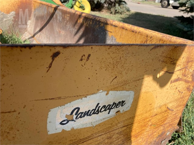

Gannon had a model called "Landscaper" which might be what it says on the side plate.
