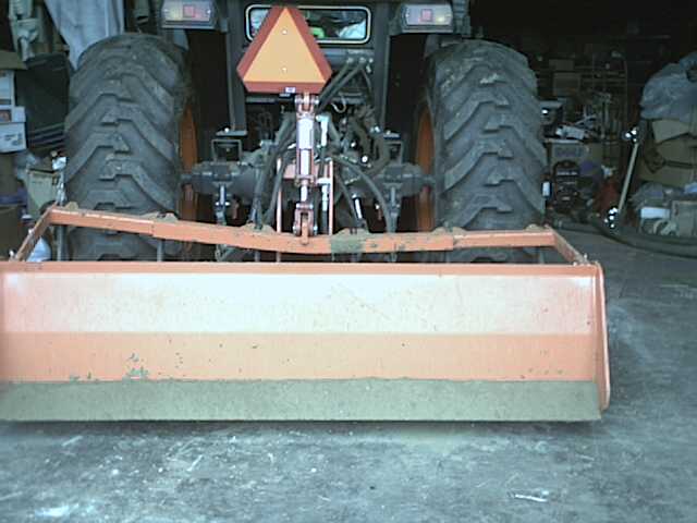

Harv, glenmac, Here is the latest chapter in the ongoing saga of my box blade. My Kubota salesman did all the interfacing with Cammond. From the representations made to him by factory personnel he was optimistic that I would get a "one time special good deal" as a customer service PR thing. The capo di capi (BOSS of BOSSES) finally got back into town on Tue and today made his final offer. I pay them $50 dollars to repair the damage I did to the boxblade subsequent to their initial waranty repair. Then I give them back the box blade in trade for a larger and more expensive blade with no particular price break. I want to be adult about this and not bite off my nose to spite my face so given my needs and time constraints and convenience I will take the deal. I will also comment further about this situation.
The instruction book does NOT say to stop the tractor prior to raising and lowering the scarifiers. That isn't expected with their other models and wasn't mentioned up to and beyond the time of the first waranty repair. The Kubota guy Kevin D. Luper, a prince among men, asked Cammond about that and in light of the fact that I did operate that way and experienced additional difficulty with their clearly inferior underengineered product which bent like a soggy pretzel, they said you can't do that. A bit late, I think. If that was their position why wasn't that information in the operator's manual. Plenty of other info was in there. If there were a distinction in the required operation between this sorry piece of crap and their industrial rated equipment (rumored to be better) then why didn't they mention it?
It would be too bad if this or any subsequent posts (stand by) prevented any sales of their product with either the Cammond or Gearmore labels.
I have questions: How was I supposed to make a determination that this piece of crap couldn't be operated like its big brothers? Maybe by the laying on of hands to feel its aura or perhaps with a OUIJA board? With one it is OK but with the other it isn't? Of course the prohibition was only issued after the second episode of equipment failure. I think maybe if it were in the operator's manual then I legitimately would owe them for repair and the first repair which they did for free was a boon. It became, not their problem when it recured. Very interesting.
The way that the vox populi is heard is sometimes in the marketplace and sometimes in the courtroom. It is only $50 (for the repair) but lost time and a drove of other issues with monetary consequences are beginning to bubble to the surface any moment now, perhaps. Small claims court seems like a reasonable way to redress my grievance. I hope the big boss has time to represent himself conveniently as lawers are not permitted. Seems like a slam dunk to me. I think I had every reason to believe I could use this equipment in this way since all the other models are used that way and my instruction manual did not prohibit it for this model. If I had an expedient alternative I would take it to avoid contributing volume and profit to them through this additional sale.
I paid nearly $800 for this useless toy and it will cost me about $700 more (plus the $50 repair charge) to get something that is rumored to be usefull. The only good news is that I can probably get it tomorrow. We are coming into the fall rainy season and need to get some things done yesterday with a box blade.

If I am understanding you correctly, I am not sure any box blade will do what you want. The heavy duty box blades with the swinging scarifiers that I have used will not allow you to lower the teeth while you are pulling the box through the dirt. The hydraulics simply are not strong enough to push the teeth into the dirt while under load. The Gannon/Woods 4272HD box blade I use is the heaviest duty BB I could find. The ripper bar uses a 3" hydraulic cylinder and is not strong enough to work the way you desire. The manual says you need to stop the tractor before you lower the rippers. There is a mechanical cam that locks in place once the rippers are down. This cam is what carries the load on the rippers so the hydraulics are not loaded all the time. I will do some BB work this weekend and try to lower the rippers on the Gannon to see what happens. I do know that the unit is so heavily built it will not bend anything by trying.
If you are otherwise happy with the blade you have, I would check to make sure someone on this board has actually used the Gearmore in the manner you described before spending the extra money. I know the Gannon heavy duty blades will not do what you want.

Roger that, Roger. I understand what you are telling me and appreciate your observation. I am not going on my opinion or my wishful thinking. The Cammond people told my Kubota guy that their industrial rated units were made to do that. My Kubota guy is no dummy and he expected the one I had to do it. AFTER it failed, they then say you have to buy the industrial unit to do that. This whole thing would have never happened if they were up front and put the info in the ops manual. I would have either accepted that limitation (and it is a fairly limiting restriction, sometimes) or opted for the "industrial" unit. So the expectation that the *^&%*^& brand will allow the operator to engage and disengage the scarifiers is based on the manufacturer's claims and puts possible failure squarely into the resonable-expectation-of-waranty envelope.

I checked my Gannon box blade today. It will not fully lower and lock the scarifiers if the box is being pulled through the dirt. It did not bent anything. I can hear the hydraulic relief valve open up if I try to lower the scarifiers while the box is under a load.

Hey Patrick, I don't know how I missed this post as it is right up my ally. I have the 72" 2G2 Gearmore. I know of no hydraulic activated scarifier bar that activates under load, they all need to be locked into position, the ram does not hold the scarifier in place but simply swings and activates a locking pin or other device. They must be lowered while the box is up. The picture of the box blade you bent is quite frankly "a weenie" and looks like it is built for a 2 wd tractor. Your L4610 has far greater pulling power then that ripper bar could possibly handle. I have been such a strong advocate here of getting a HEAVY box blade as I have seen many light weight boxes on 4WD change shape. The L4610 could handle a 76" box, but that would be it, don't go wider then that unless your ripping paper bags and pulling dust.
P.S. the only way rippers could activate that I could see under load is if they lowered straight down rather then pivot as both Gearmore and Gannons do. I use the rippers and have boken many shanks but never bent the ripper bar, catch a solid rock with the light box and their gone with a tractor such as yours. If it were me, I would get the 4G2 in either the 72 or 76" width. The 4G2 for the extra weight and 5" pull and ripper square tubes. Anyway, this may all be moot as its been awhile since you posted alot of this stuff, Rat...

Hey Rat, Is it better never than late or better late than never? Your response is welcome but too late to influence my upgrade decision. I upgraded to an extremely HD Gannon, not what I wanted to do but sort of an economic default position. The light duty Gannon, bent orange one in picture, worked really well and I liked it a lot. If they would have beefed up the raise lower parts I would have kept it but they repaired it "under waranty" back to stock condition the first time and charged me to repair it the second time before they would accept it back in a trade up deal. Gannon acted in a very unprofessional manner (AT THE TOP MANAGEMENT LEVEL). I have a very big bone to pick with their ethics (or lack thereof).
The light duty boxblade did raise and lower while in use and until its light duty underbuilt mechanism was overstressed and bent it was a dream to operate. Its scarifiers did not rotate but raised and lowered sort of rectilinearly which alowed you to adjust ripper depth independent of the box blade height and cutting angle. It was fantastic. If its construction was as robust as the unit I upgraded to it would probably last just fine, especially in my rock challenged acres (very few rocks and those in a very few locations). But alas, they would not compromise or even consider a customer advocate position. I was especially ticked when I had to pay them to fix it so they would accept it on trade. They do not prohibit operating the scarifiers whenever you want on the HD model but claim it is prohibited on the first one (light duty). Nothing in the operators manual for the lighter version prohibits operating while in use nor did the Gannon folks say anything negative about it until after I trashed it the second time. They just make it up as they go depending on what is in their favor. The only thing that has prohibited my demanding a showdown in small claims court is I have too much to do to take the time. I would really love dragging their top guy dowm to the courthouse and embarrassing him with public display of his actions.
