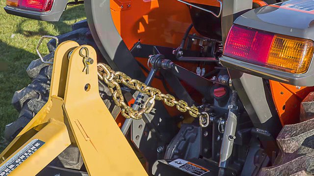

/ Top link vs flail mower #4
Just replace the toplink with a chain. Just get a chain as long as your current toplink. Put a pin through the chain where you would the same as a normal toplink.
When you lift a 3pt impliment the toplink is in tension (pulling) not compression (pushing). So it pulls the chain tight when you lift things. When the 3pt is lowered the chain goes slack.

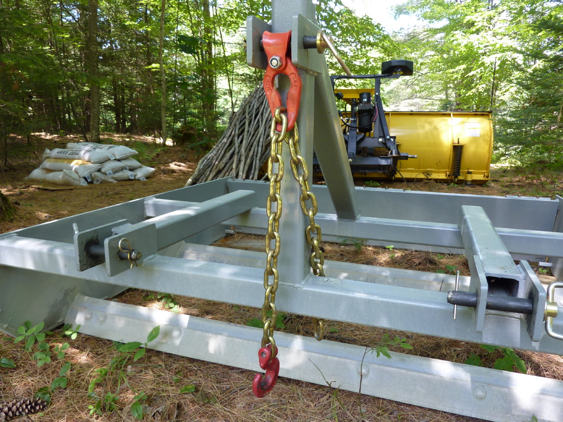

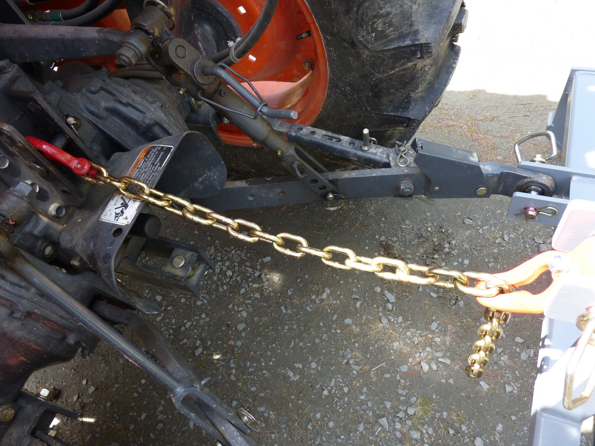

/ Top link vs flail mower #5
Sounds great, how does one use a chain rather than a toplink.
Like this:
And from member Gordon Gould one that is easy to change the length:
/ Top link vs flail mower #6
I have run the same set up as Gordon for the last couple of years on my TM1900 and it works great. I also have used a chain for the top link on my 5' and 10' rotary cutters for years without any problems.
/ Top link vs flail mower #7
That simply makes just too much sense - no wonder I have not yet done it. Thanks, guys.
