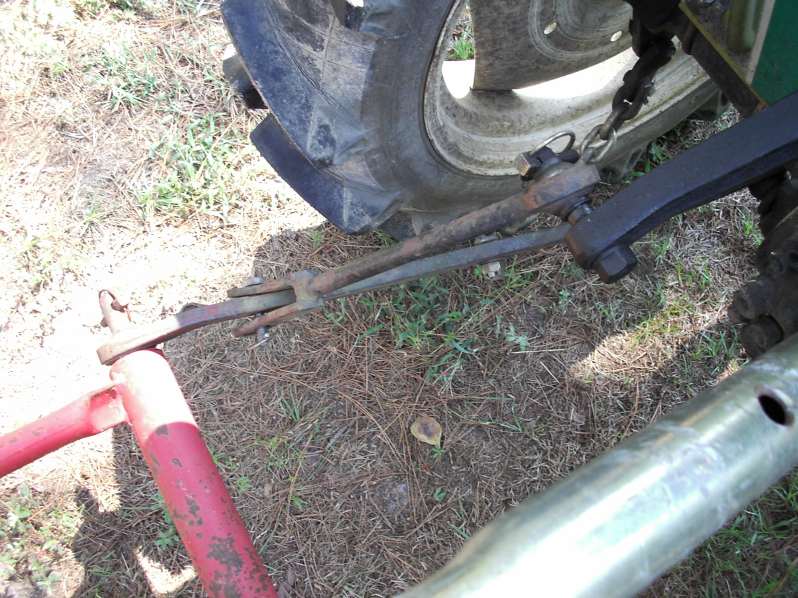

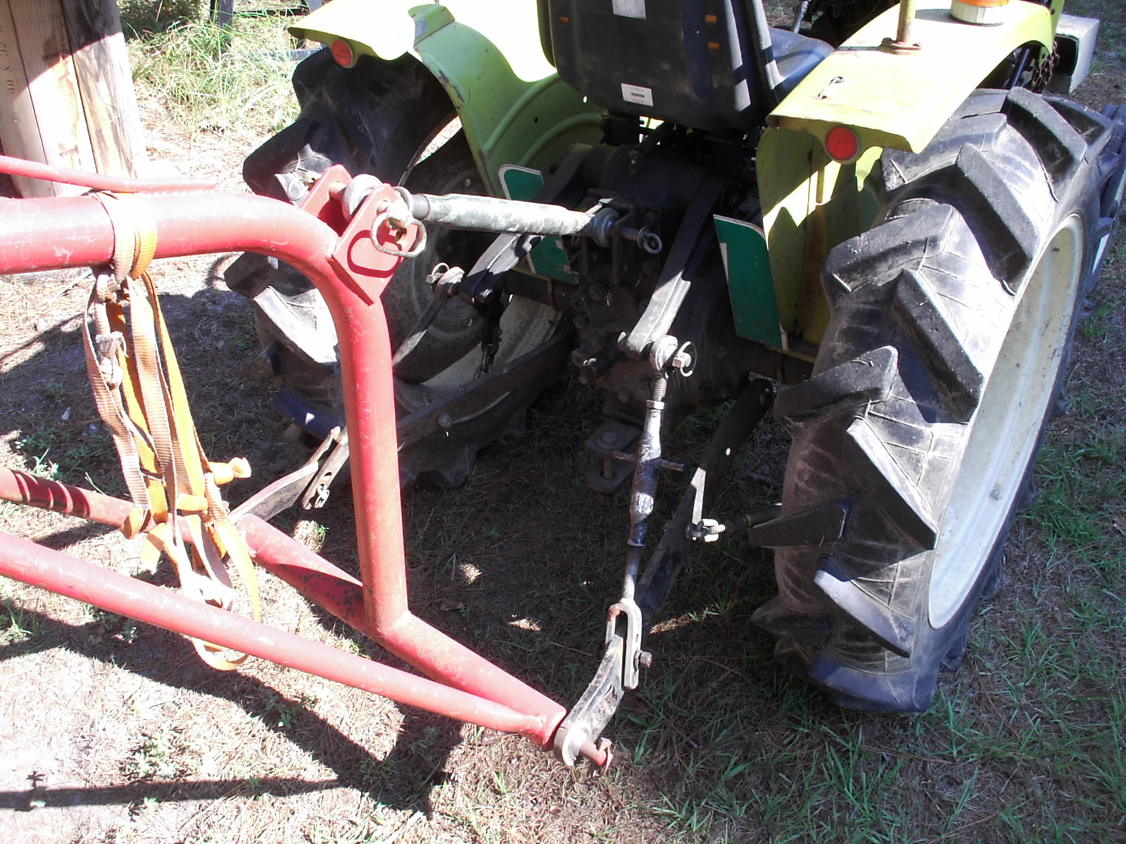

does this help?

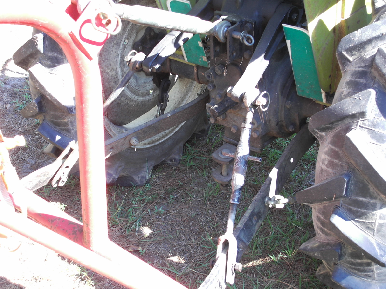

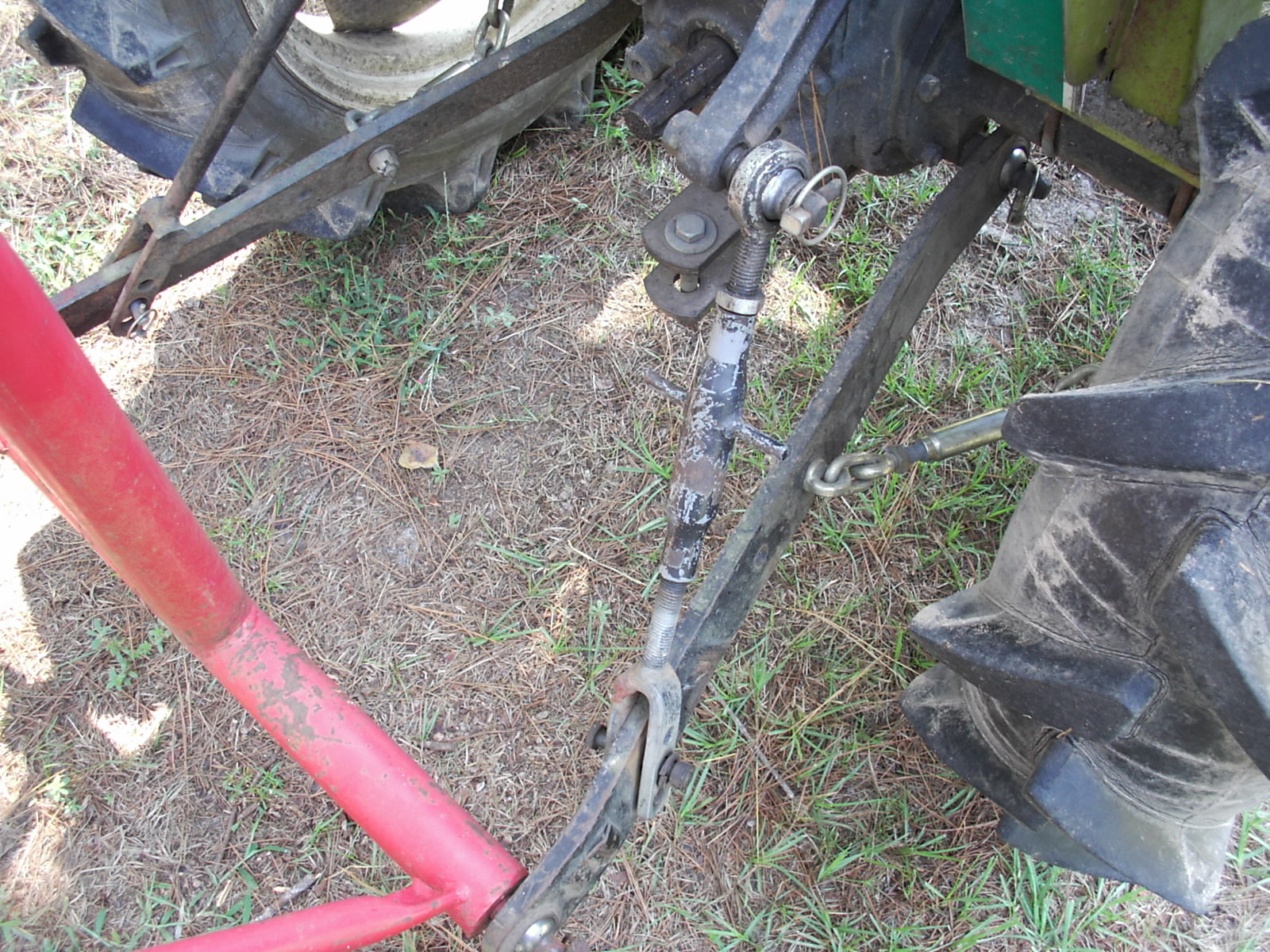

sorry for the poor comeback...here ya go:

In the Parts Diagram, Post #7, the Top Link is #4 and the (right) Adjustable Lifting Rod is #10.
Which of the two do you need to replace, #4 or #10 ?
