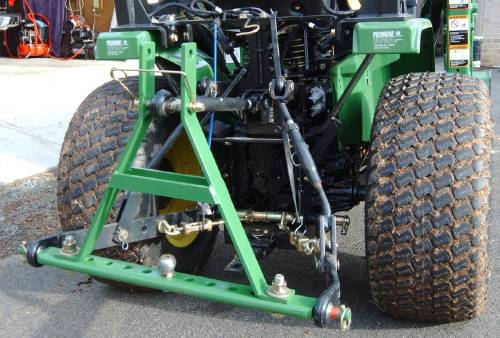

Looks like Greg has given you good information on what TSC has. Orsheln(sp?) also is like TSC in the Oklahoma and Texas areas and probably have an assortment of top link lengths. I use 2 on my soil ripper. One connects to a drawbar hitch; the other runs from the drawbar hitch top link area to the top of the soil ripper. It gives me lots of adjustment to the tilt of the soil ripper, as I have it fitted with disc hillers in the front and ripper tines in the rear.
One thing that I discovered with top links on brush hogs is if the top link is longer than the bottom links, the brush hog won't lift very far. The geometry of the 3ph will want to drive the tail wheel down into the dirt rather than up into the air. I resolved this on my brush hog by moving its bottom pin locations down. This pitched the top link closer to the tractor and made it the same to slightly shorter than the bottom links. Don't know whether you have something like this situation on your shredder links.

You need a braket similar to the top link part of my drawbar hitch attached.
I use this to link up with my old JD M soil ripper. The soil ripper attaches to the drawbar and has a top part that attached to the top 2 holes on this drawbar setup, above the top link that comes off the tractor, via another top link. If your top link is too long, e.g. without this in-between link of the 2 top links, lifting the implement will drive its rear end into the ground first before the bottom links end up lifting the implement's front end. It's just geometry at work.
