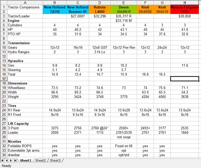

I pretty much track this list:
1. Tractor Frame Size/Weight- The weight traslates to traction and stability. Also nice to have more clearance.
2. Build Quality/Good Design/Niceties (extendable links, 3pt stabilizers, foldable ROPS. rear remotes, etc.)
3. Better than competitors loader specs - Lift, breakout force, lift height, etc.
4. Ergonomics - how does it fit and feel to operate. service?
5. Dealer Engagement how competent are they, and how will they treat you before, during and after the sale.
6. Price/Warranty/Financing - How does this work for you (my dream tractor is always $5k more than I want to spend)
The specs are a lot to keep in your head, so I put together a spreadsheet to list the specs. Here is one I did just for fun.
