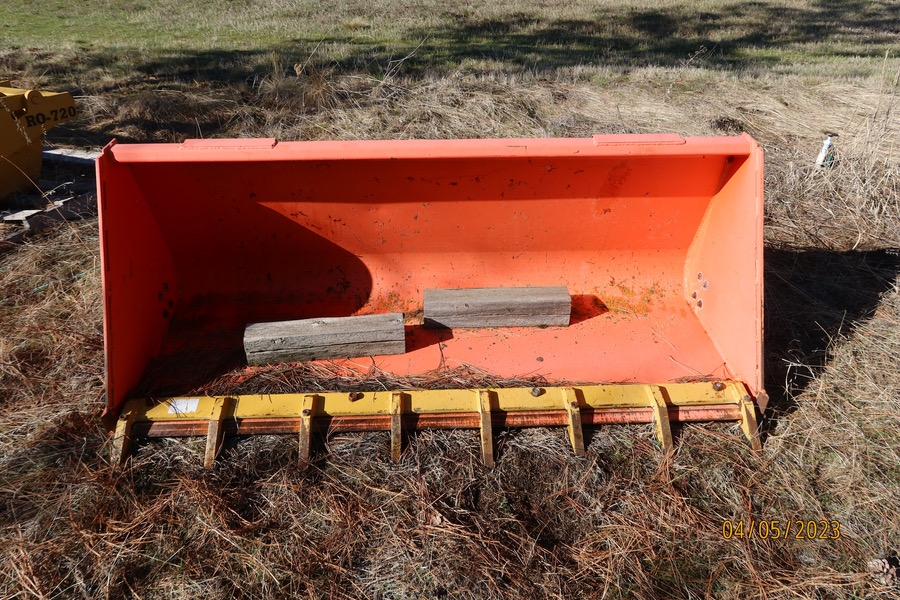

This is my heavy duty Kubota bucket and Rankin tooth bar. This tooth bar is attached by drilling thru the bucket and bolting it directly to the lip. The four bolts are Grade 8 - one inch diameter. This tooth bar adds substantial strength to the lip of the bucket.
have same set up w/Woods. btw the MXX40 series tractor is imho the best Utility series they've produced.
