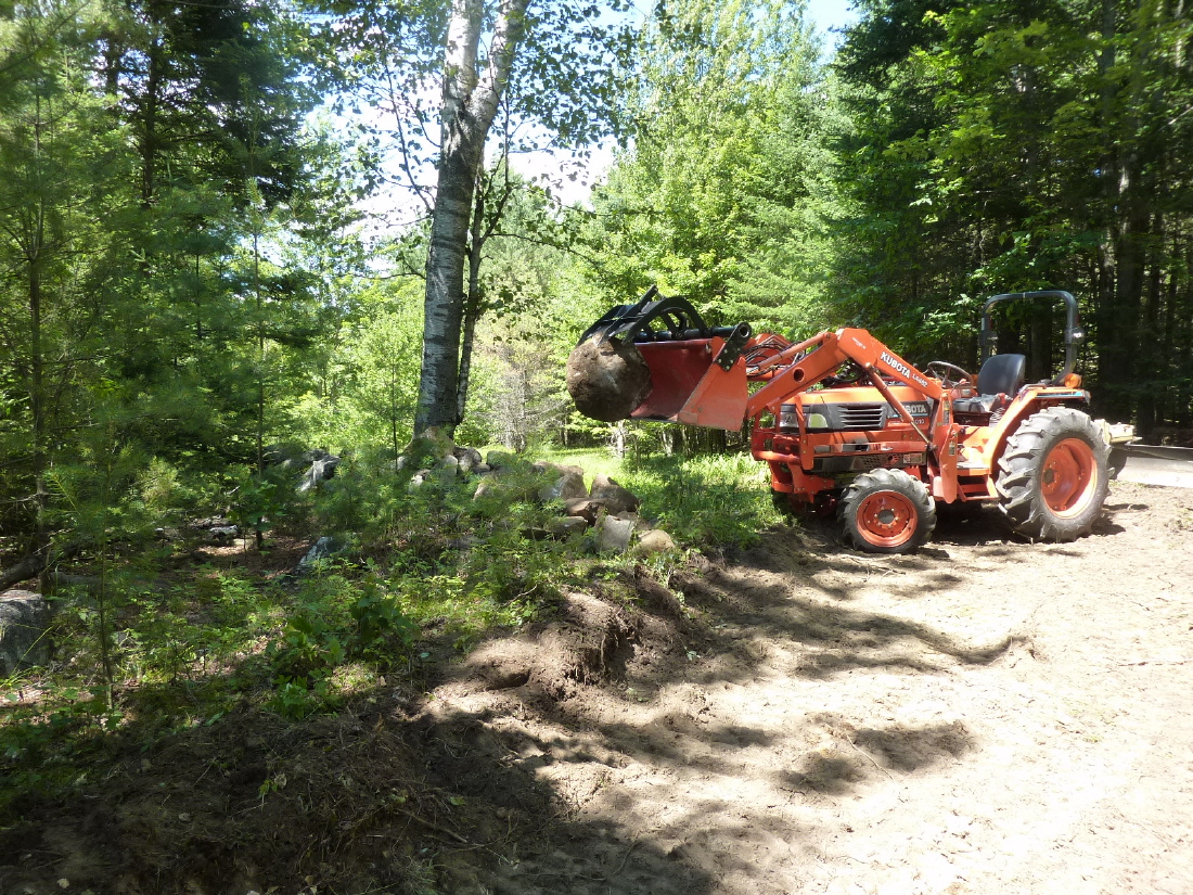

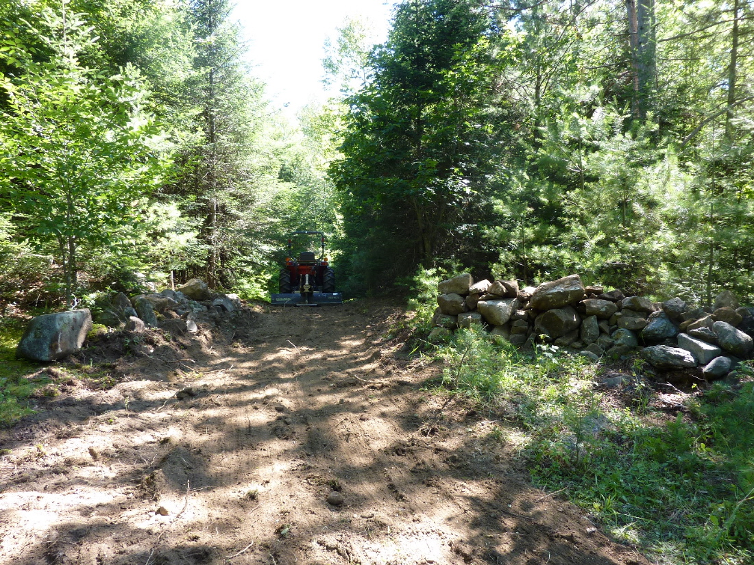

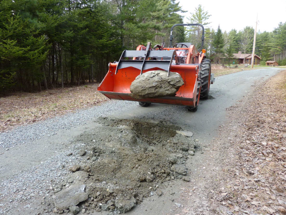

I am seriously considering putting an Iowa Farms toothbar on my bucket for digging and grapple work with logs and brush. I have a question though about it's use with stonewall sized rocks. I move a lot of them around fixing up my broken down walls.
Will the tooth bar make these jobs any easier ?
Will it take the abuse of all that pressure on one or two teeth ?
Thanks.

I have a Construction Attachments Extended tooth bar. I've used it to grub out rocks like what your seeing i've never broken a tooth or bent a shank. Teeth are replaceable on mine via a roll pin. i would agree with creekbend they are usually pretty strong

I also have a W.R. Long toothbar and have used it to root out rocks the size you have shown in your pictures. Using the outside teeth only, allows you easily take apart a stone wall and/or "nudge" rocks into place when building a wall.
One word of caution related to grubbing out a buried rock with an outside tooth is the excessive leverage placed on the loader booms. It can torque the booms enough to pull the opposite rear wheel off the ground "real quick".
