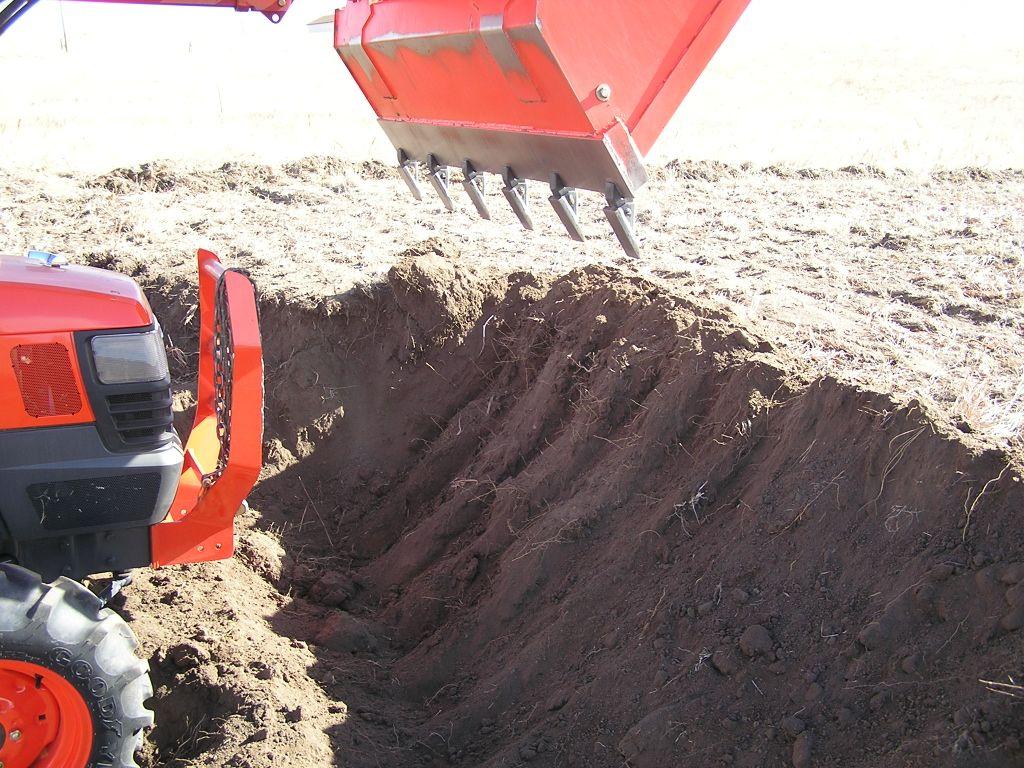

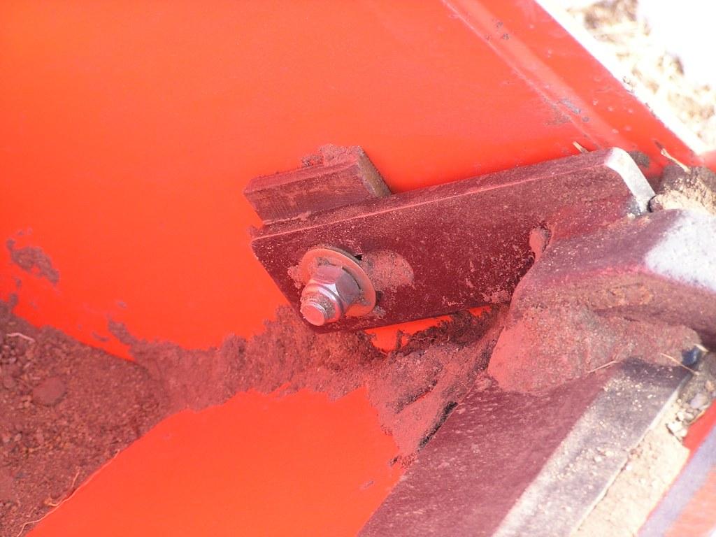

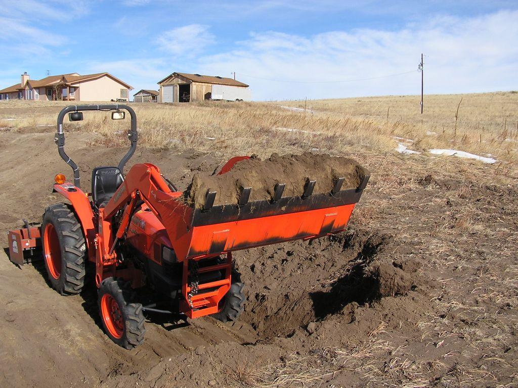

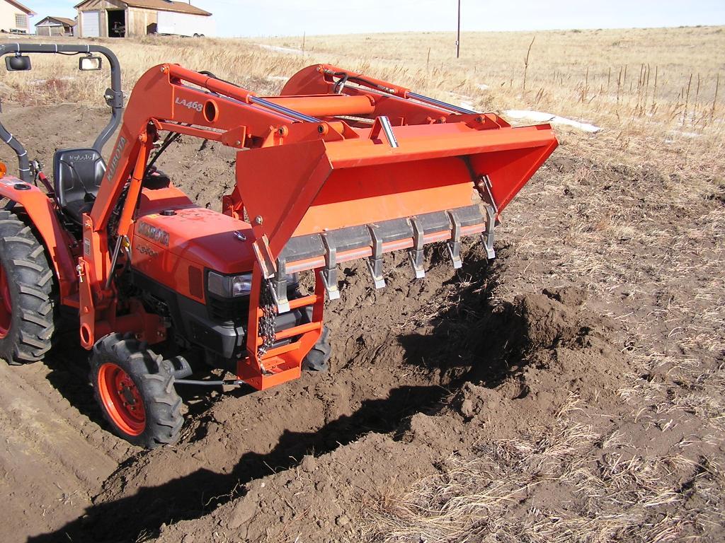

/ Tooth Bar Question #8
I have the Markham and they are the best company to deal with. Yes you have to drill (2) 1/2 inch holes in the side of the bucket. It's easy. :)
Thank you Sir for the great pictures and information. I have to get a set since I am dealing with rocky Montana soil.

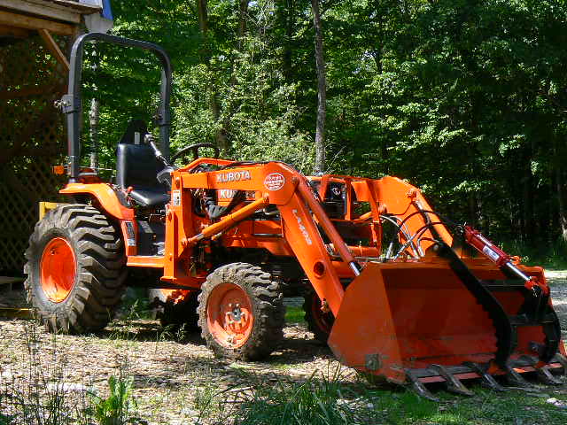

I'm not sure why the Long would be any more difficult to work with.
Based on the work I have done with my toothbar I don't see why more teeth would be a benefit.
I didn't weld the plates on the side of the bucket. I use the plates like big washers when the toothbar is on my tractor.
Yes, you need to tell them exactly how wide your bucket is inside. Markham asked me what bucket I had for my B7800 and I told them 60". I received a tooth bar that was 60" wide. My dealer had to cut it down and reweld it in order for it to fit inside my bucket.
Someone here at TBN with a BX24 (or any other Kubota with a 48" bucket) should be able to help you out.

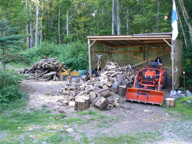

Here are pictures of my set-up
