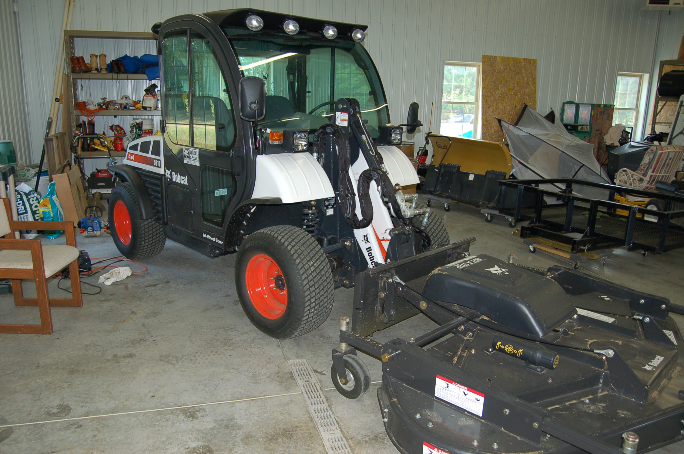

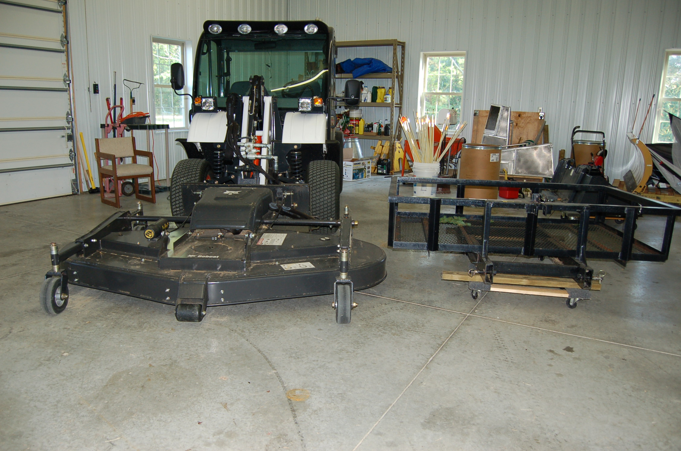

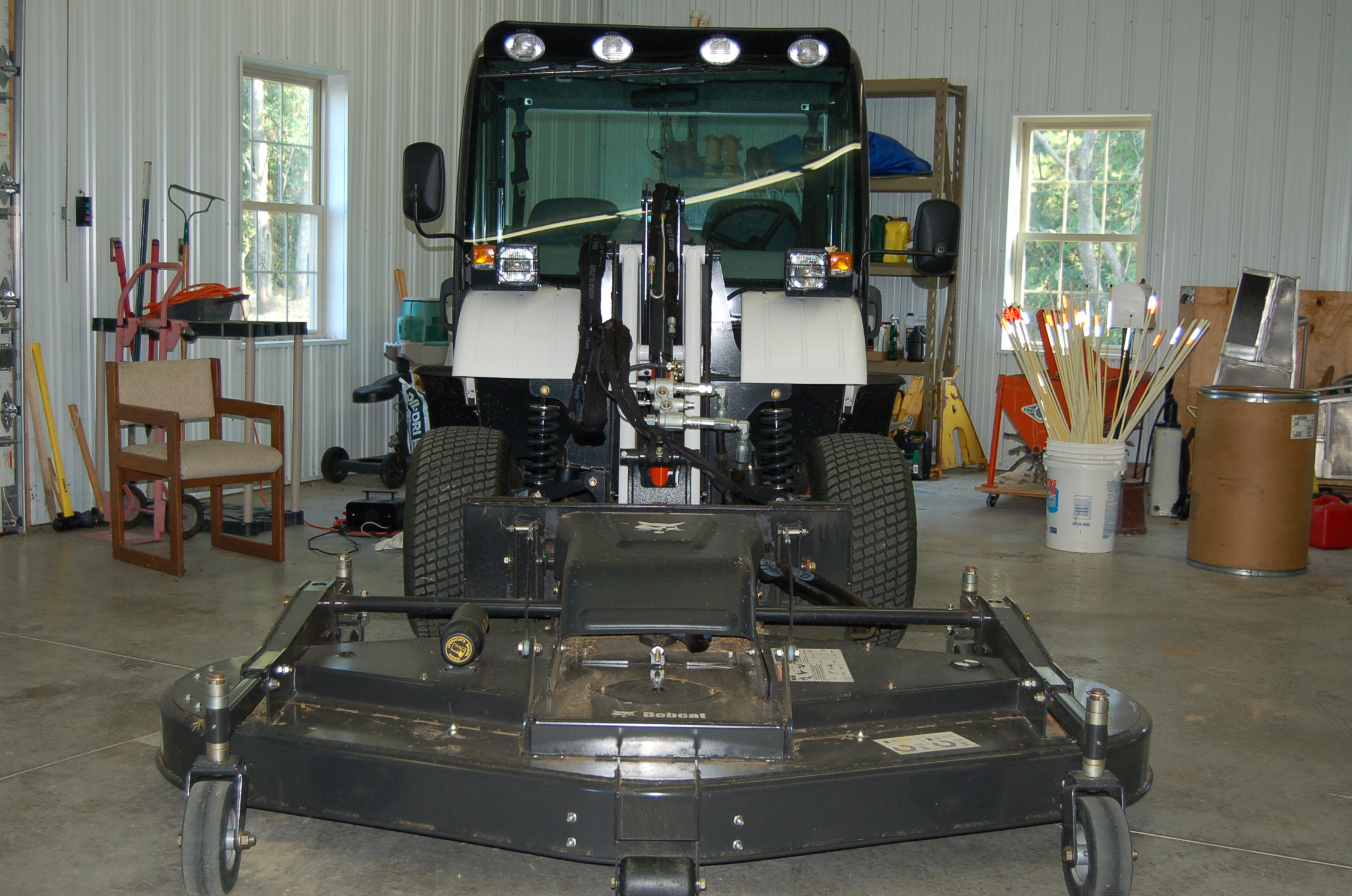

they changed the design on the 90 - my middle front caster is a 360 spin design like the outer ones. it is also adjustable in ht. the new on looks nonadjustable/fixed. hmm. saving costs or different manufacturer???
/ Toolcat 5610 delivered #22
The newer deck looks welded compared to the older deck which appeared to be pressed. New deck looks like it has more hieght. Welded decks are generally more expensive to make and some argue a better cut. Others argue that a welded deck holds more dried clippings under the deck because of the corners. I bought my 84" rfm rhino one year ago and it had a welded deck and now they went to a pressed deck version. Go figure.

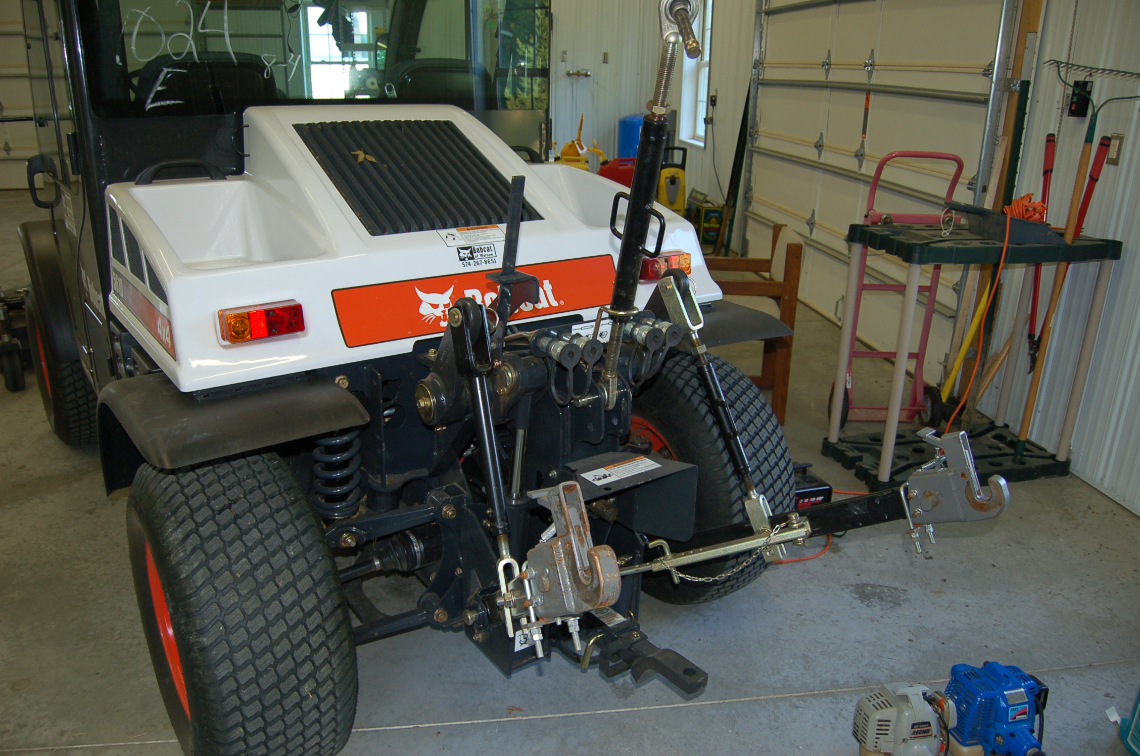

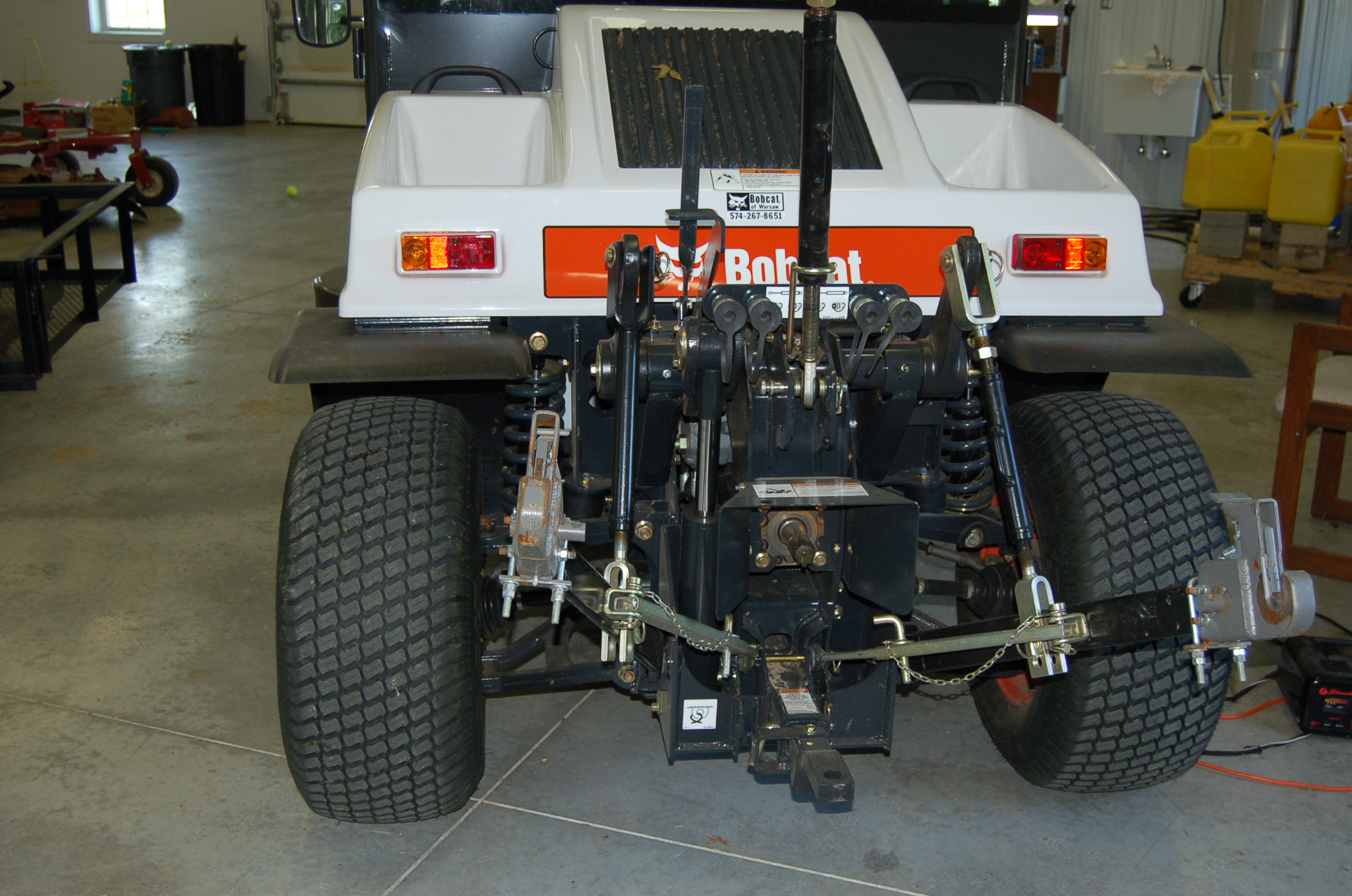

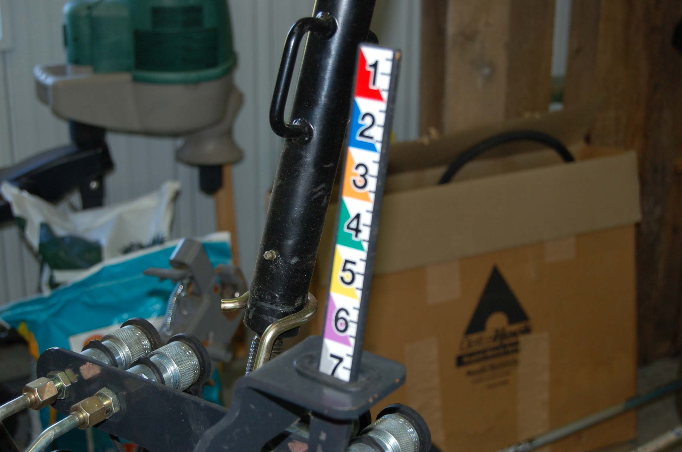

/ Toolcat 5610 delivered #24
Is there any kind of a adjustable stop for the 3pt lift lever so that you can lift and quickly return to the same previous height?

/ Toolcat 5610 delivered #26
There is no adjustable stop. You have to be careful and watch the depth gauge when you lower it to get the same height. When I reviewed the prototype it was a suggestion I recommend as well as, 3 rear outlets. I think you should be able to use an inexpensive stroke contol kit to limit the down control to the same height each time. I used these many times in the past on older farm implements such as pull type discs. Some stroke control kits can be clamped/bolted right onto the cylinder rod for more precise control. The ones shown below are stacked on top of each other until the correct depth is found. They come in variable thicknesses. TSC and other farms stores will have them or can order them.
STROKE CONTROL KIT - Agri Supply
Grip-Rite | Cylinder Depth Stop | Stroke Control for Farm Equipment

I field tested the new 90" mower for a while and I see that's it's out now, since that's the one that you got. One of the things I liked was the spinning indicator that tells you the blades are turning.
I've had issues with a piece of wood getting stuck between the blade and the deck and jamming the blade to a stop while the others keep turning. The only way I could tell it happened was when I saw smoke coming up from that blade spindle. I notice that they only have spinning wheel installed on the left hand blade. Probably because that's the one easiest to see from the operator's seat.
I wonder, how hard is it to be able to see the spindle of the passenger side blade? I've been thinking that I would want to order another of those spinning wheel spindles to install on the right hand blade, but I need to be able to see it for it to do any good. It doesn't seem like the middle blade has been a problem, only the side blades.
