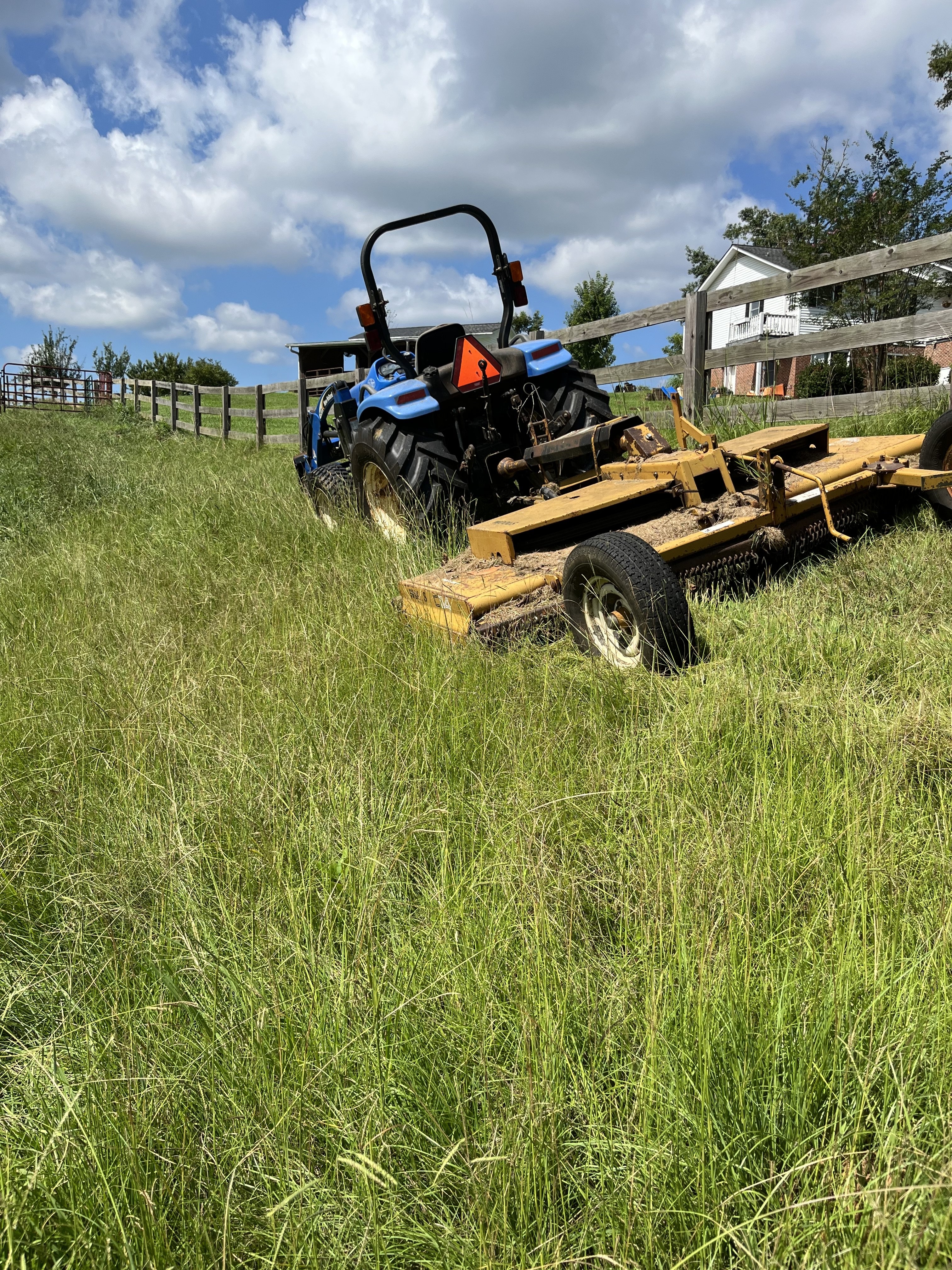

I have a Woods C114 rotary cutter (9.5’ wide) that I pull with my New Holland TC45DA.
I can rub the outside of the tongue with the inside of my rear tires if I turn to sharp. Note I have less than 36” between the insides of my rear tires.
I really like the C114 pulling it is smoother pulling (i.e., less bumpy) than a 3 point cutter when setup to leave about 8” of forage after cutting pastures.
If I had the money I’d love to have the Rhino TS10 batwing cutter.
