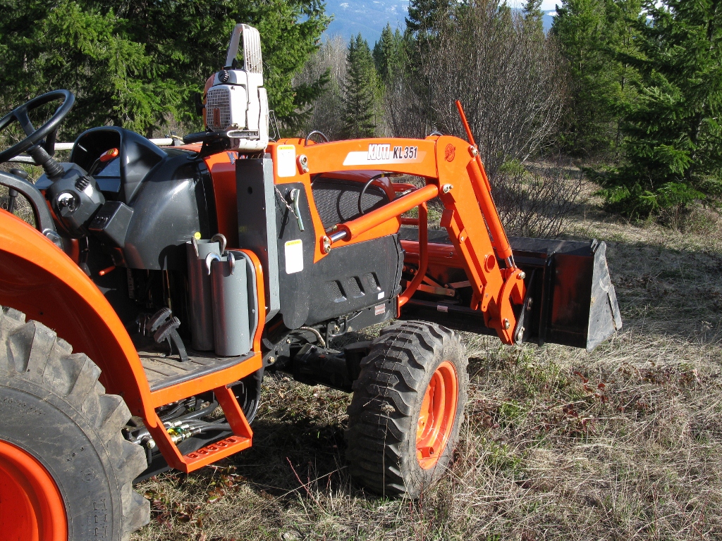

What did you use for the chain saw mount? I can't make it out from the photo.
The chainsaw case is 3 pieces of 1/2" plywood, all cut the same with the bottom edge more or less following the contour of the loader mounting bracket. I traced an area a bit larger than the chainsaw bar on one of the pieces and sandwiched it between the other two using white glue and some small (#8?) bolts. The bolts likely weren't necessary.
The holder mounts using the two existing holes in the loader mounting bracket.
Before gluing I installed a carriage bolt for the top connection to the loader bracket and drilled a hole opposite it in case I needed to access the bolt. That likely wasn't necessary and I should have just glued the bolt in the wood.
The bottom connection is an ordinary bolt that goes through all three pieces of plywood (i.e. the chainsaw bar is completely above the bottom bolt).
I have attached a cropped picture that may help.
I see the chainsaw's bumper spike is resting on the case. But I actually grooved the back piece of plywood and the bumper spike fits over the rear side of the case with the main body of the saw resting on the holder.
I got the idea for this from tornadowatchranch and the ideas for using plywood from other posters on TBN.

some very nice ideas on what to do with the chains and saw, i had been struggling with what to do with mine. thanks for the ideas and photos

Thanks for the feedack, KCO. Nice setup!

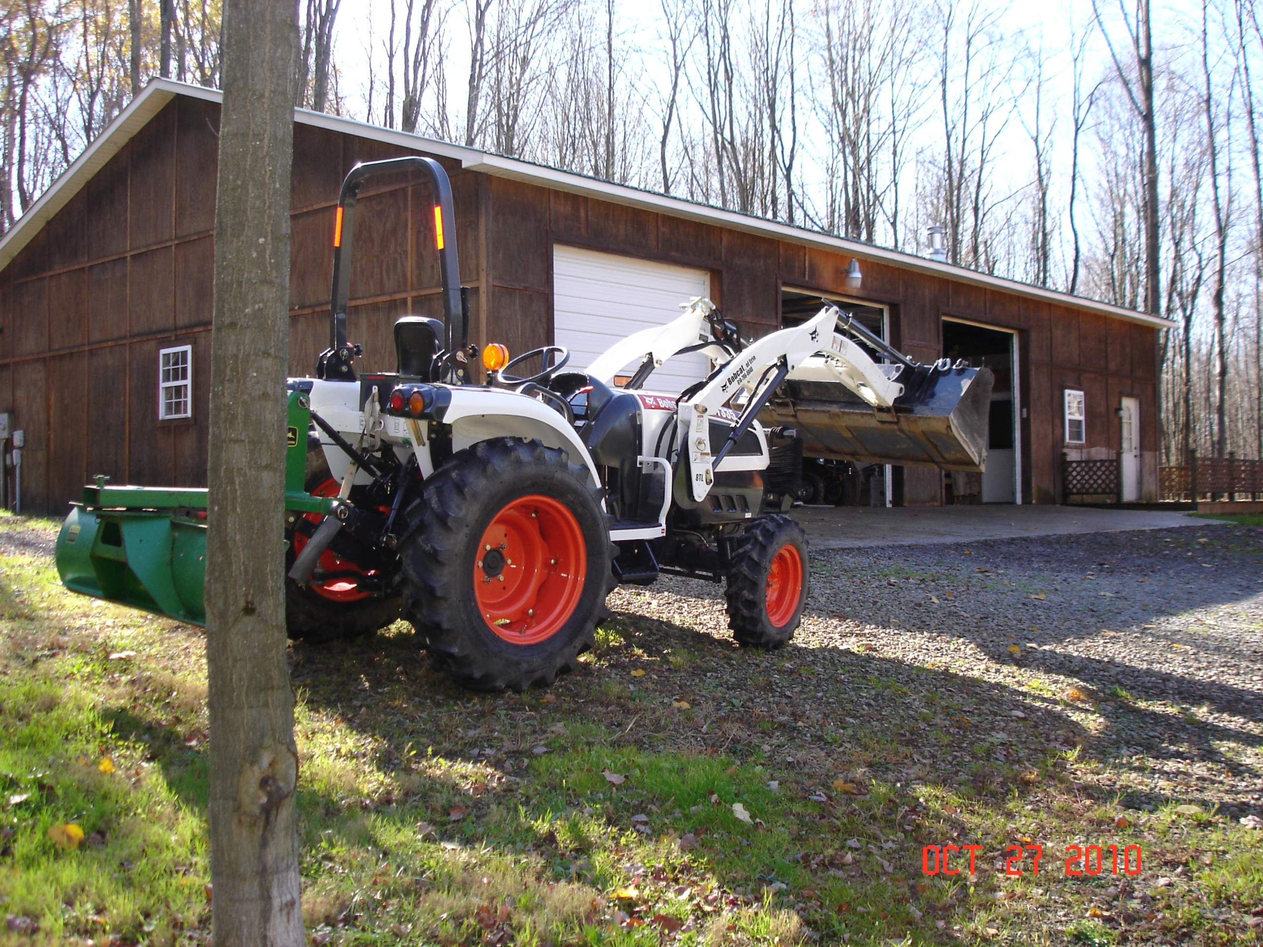

I thought I would add my toolbox to the mix. It's a "boater's waterproof box" from the boating section of my Walmart. I mounted it to the spot where the owners manual used to sit.
So far it has been great and everything stays completely dry!

did they move the fuel tank from under the hood on newer models of Bobcats?

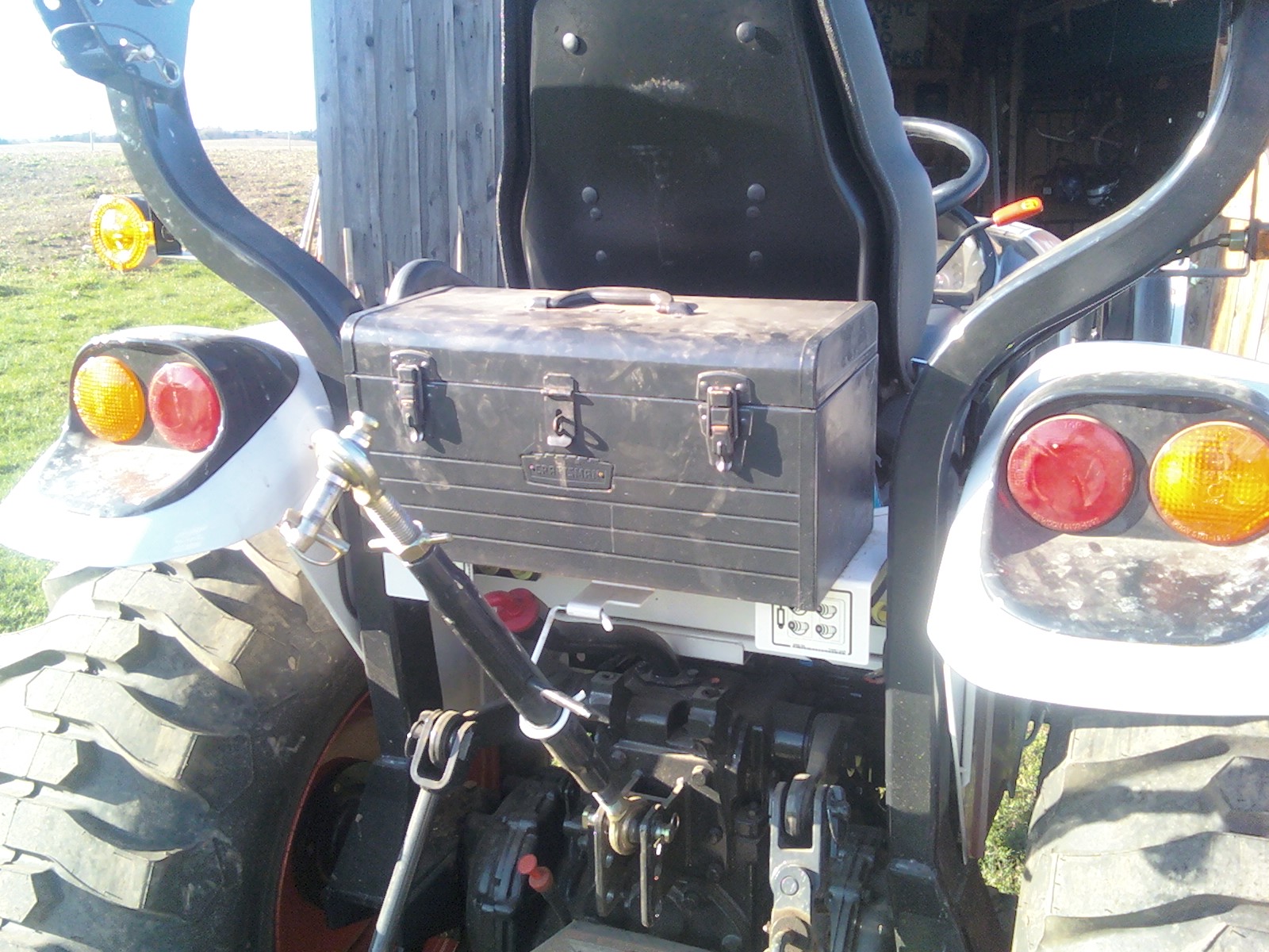

Using storage designed for boating actually seems like a pretty good idea, especially since the one in your picture is narrow and more likely to fit behind the seat as opposed to something like the waterproof Stanley tool box that I ended up with, which just barely fits between the tractor seat and backhoe seat.

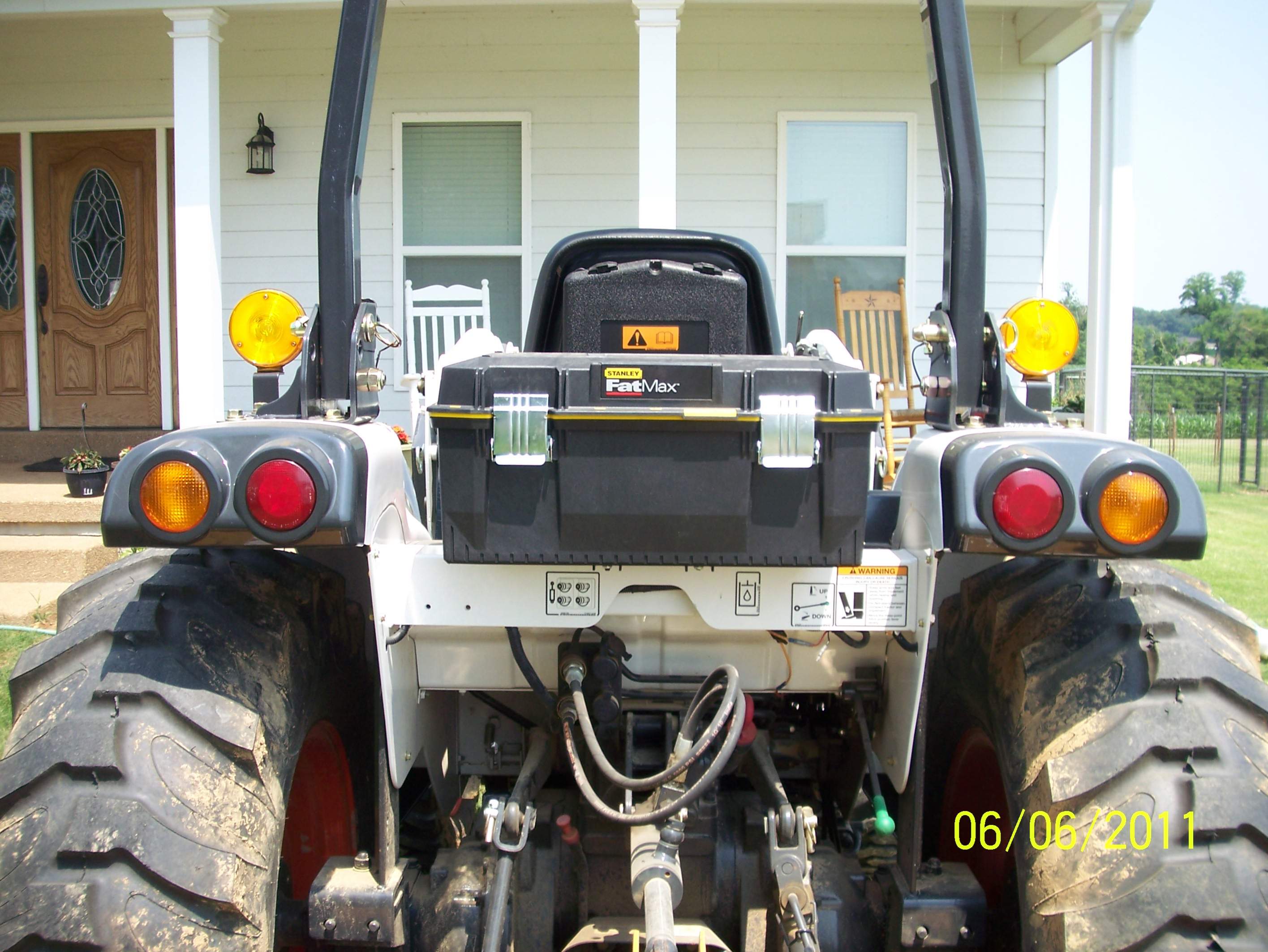

I've wanted to replace the small toolbox ever since I bought this tractor.This Stanley Fatmax was the only one that I could find around here that has a watertight seal and more than enough room for what I need. The only drawback is it blocks some of my view of the 3pt hitch.
Looks good, I like the big size.

Nope...that is the CT122 model. That model is too small for under hood fuel tank. Always been that way.
Ahhh I think thats the first time i have seen a pic of one, my dealer never has one on the lot when I am there
/ Toolbox #31
Yup, CT122 :) I've never tried fueling over the hood, but I don't think I'd like it. Out back I don't have to worry about spilling.
The think I like most about the boater's storage box is that it has a tray to put small items, and the bottom is open for chains, hammer, etc. :thumbsup:
/ Toolbox #32
Super looking box in just the right place!! If I might ask, what did you mount it on? It looks like it痴 a special shelf you fabricated to fit where the "lawyer Tube" was.
/ Toolbox #33
Yup, I took the lawyer tube off and mounted a piece of 1x6 pine to the mounting holes, and then bolted the box to the piece of wood. It's been almost a year of being outside and it is still holding up fine.

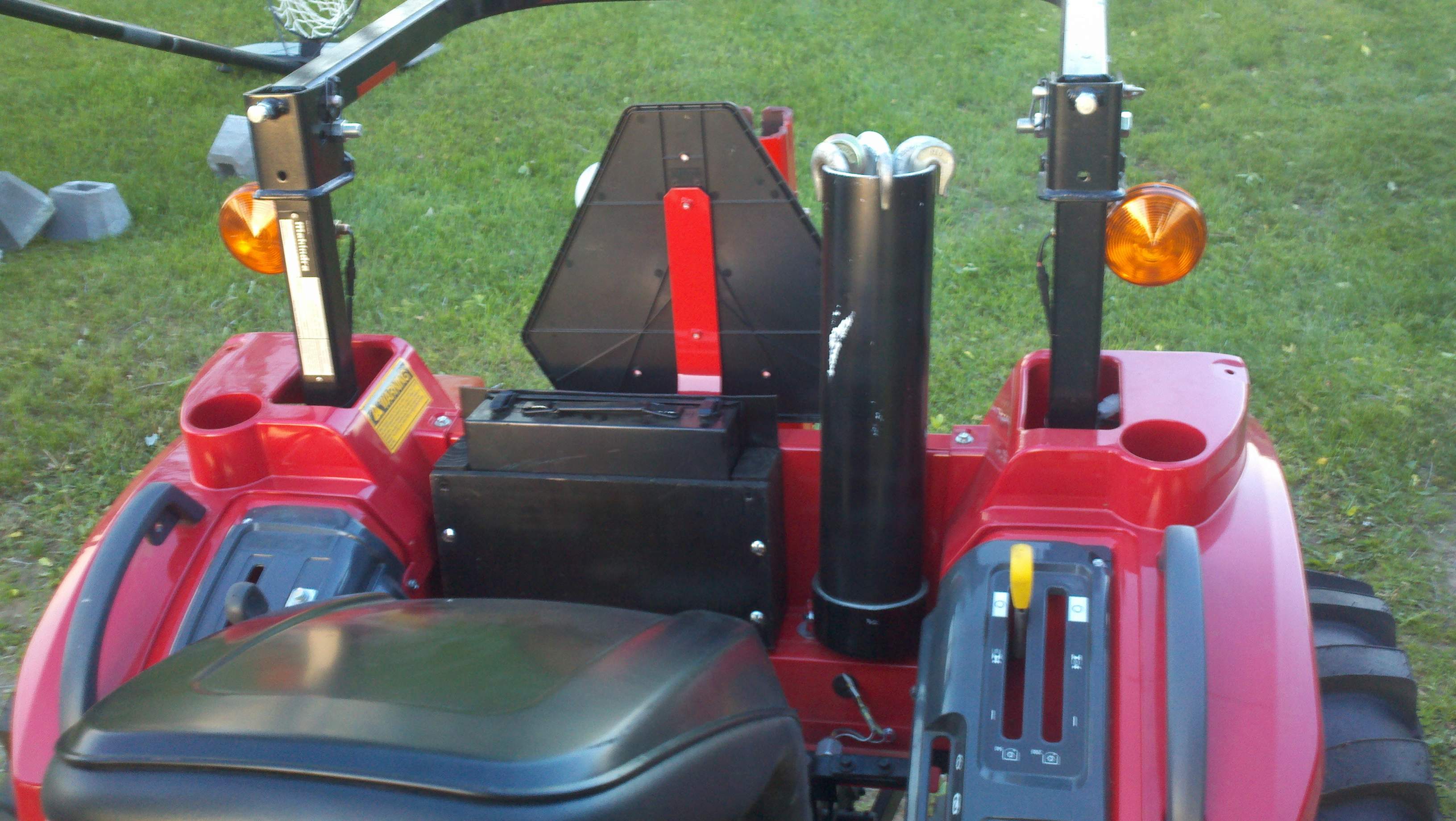

I found a picture I took last summer.
Removing the box for the manual is the way to do it. I installed a plastic tool box without removing the plastic manual and the box is too floppy; not enough support as it sits.
