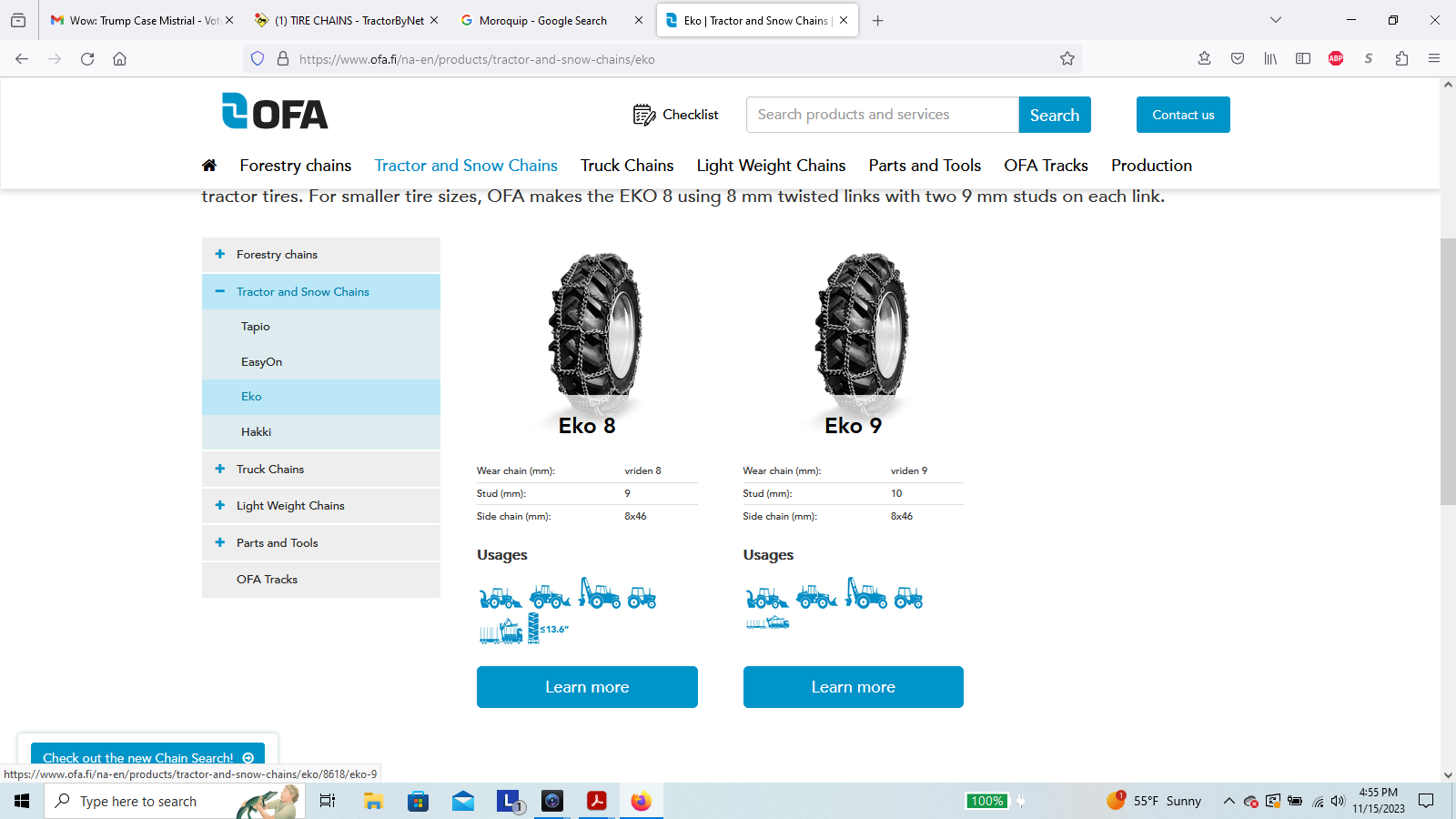

Just went and picked up 3 sets of OFA Oko chains from Morquip in New Hampshire.
A set of 15-19.5's and 14.9-28's and 18.4-38's

Thanks for the replies. I'll give Tirechains.com a shot. The ones I had were vbar. They were phenominal. Only had them on the rears.
/ TIRE CHAINS #14
I run studded OFA EKO chains. They offer amazing traction on all surfaces, including ice. They're designed to run loose so there's no need for tensioners and they're easy to install. I got mine fron Austin Farm Enterprises in Bainbridge, NY.

Well heck I guess I'll state this again the "euro" style studded chains such as the OFA, TRYGG, and Aquiline Talons
are so much better then anything else on the market,
such as 2 or 4 link spaced V bars, or the various duo-grip tire chains.
These full contact studded chains will provide a superior ride quality and a traction increase that is several magnitudes better then the other tire chains on the market. With these chains tire slippage and chewing is greatly reduced.
On frozen ground, ice or hard packed snow the traction is almost the same as dry packed gravel and in some cases actually better.
Those that espouse the other styles of chains simply have not used this type of traction chain.
