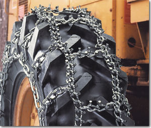

i am getting ready to buy tire chains for my 4410 and had a couple of questions before i buy them.trying to decide whether to go with 2 link or the 4 link type,and was going to put them on the front too.my property is all hill,and i have had some scary experiences with sliding in the snow.the only time i will be using the chains is when there is snow,otherwise,i have no issues with traction for the most part.my machine is always in 4WD even when i am mowing with it,that's a must.i was just going to put chains on the rear,my concern is if the rear gets traction,and the front don't,may cause damage from speed variation between the front and rear.i'm pretty much sold on putting them on the front just to keep the front end from sliding.if you have ever slid sideways and come up on two wheels,you know what i am talking about.not a good feeling.just want to get some other opinions from you guys,what do you think ?
/ tire chains #2
Using chains on the front of a 4WD tractor is a bad idea. Front wheel drive systems are designed to slip when the tractor loses traction. Slipping on a dry surface with FWD engaged can damage the front wheel drive assembly. It is for that reason JD cautions the operator not to run the tractor on a dry pavement with FWD engaged. Installing chains on the FWD will give you traction but no slippage and is a sure way to damage your tractor. My JD 2305 operators manual specifically warns the operator NOT to use chains on the front tires.
/ tire chains
just read through my operator's manual,it does say not to install chains on the front tires,the way it is written is as follows : Do not install tire chains on machine front wheels,Chains will strike and damage machine.i would have to agree that they would hit if you turned too sharp,and i agree,you would'nt want them on a dry surface,however,with being on packed snow,and given i am most always on some type of an incline when i am working with snow,and the only time the chains would be on it was when there is snow.still up in the air about it.the front end is always sliding.more so than the rear.maybe i will just put them on the rear for now and see how it goes.i have talked to 3 different guys,and they said to definitely put them on the front.

i talked to the dealer today,and they do not recommend putting chains on the front,he did say to let a little air out of the front tires to give them a little more surface on the ground.i am gonna try with just the rear chains,they will make it better for sure,if the front end still wants to slide around,i will put chains up front too.i only want the chains on when there is snow on the ground,it won't keep the front axle from slipping alltogether,so,should be no problem as long as i am carefull with it.i posted a couple of pics in my albumn of my baby if you's wanna have a look ,,,,,,,,,,,,,,,,,,,

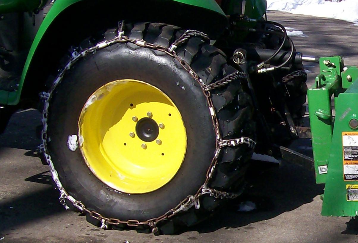

I've run chains on the rear for many years - simple single ladder chains. This is the first winter I've put them on the front and wasn't because of steering (that is what the individual wheel brakes are for, IMO). But I needed to go in the deep snow in the woods and the extra traction was great. I left just the fronts on for awhile. Then decided having a lot of traction just on the front wheels, without any help from the rears was not the best idea (although have not heard of a Deere having problems, and was told by a Deere engineer that they were designed to take the load).
Here are a couple pics of the rears and the fronts only.

I won't get into the front or no-front chains debate-but you definitely want 2-link ladders for the rear, not the 4-linkers.
