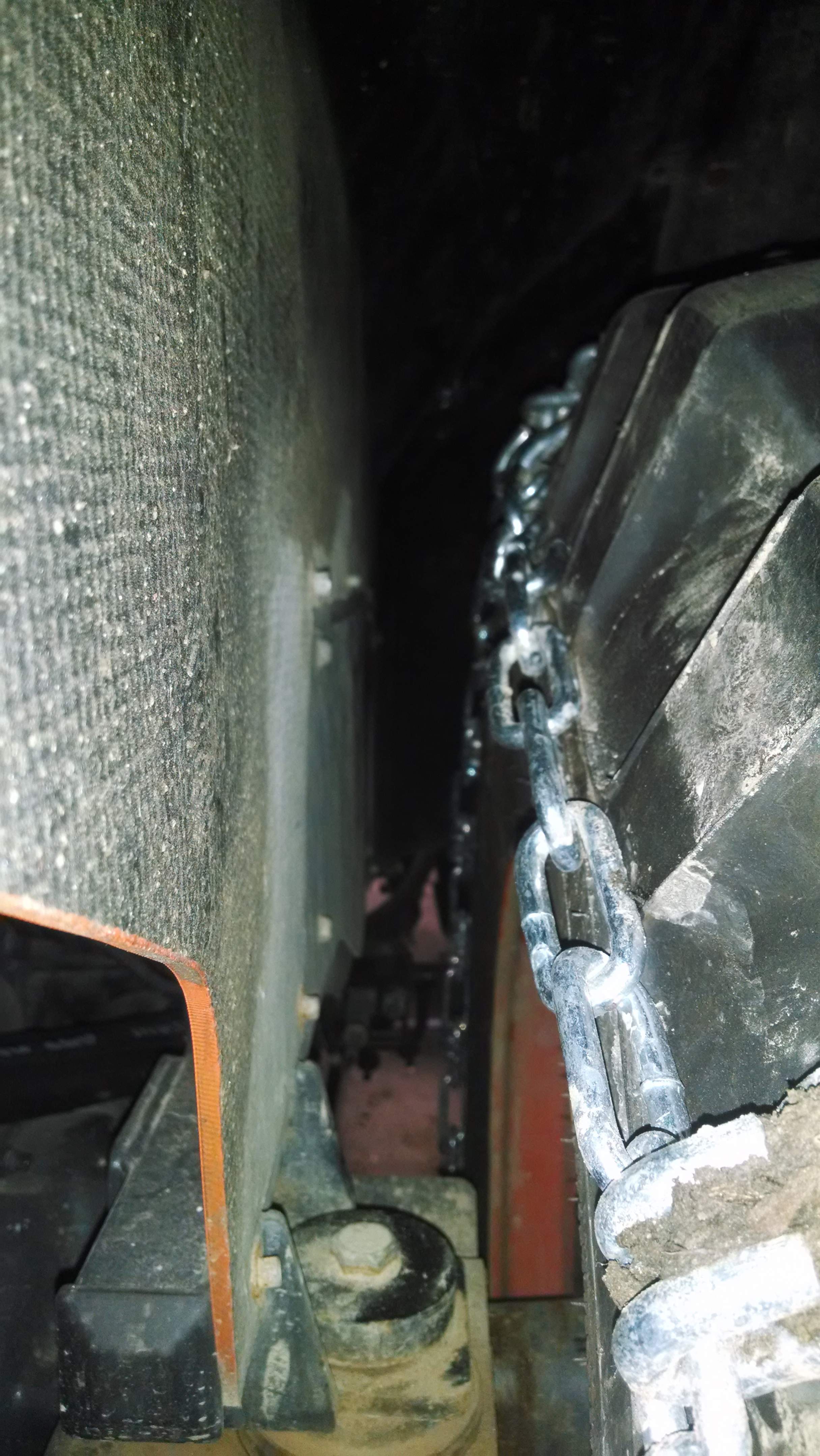

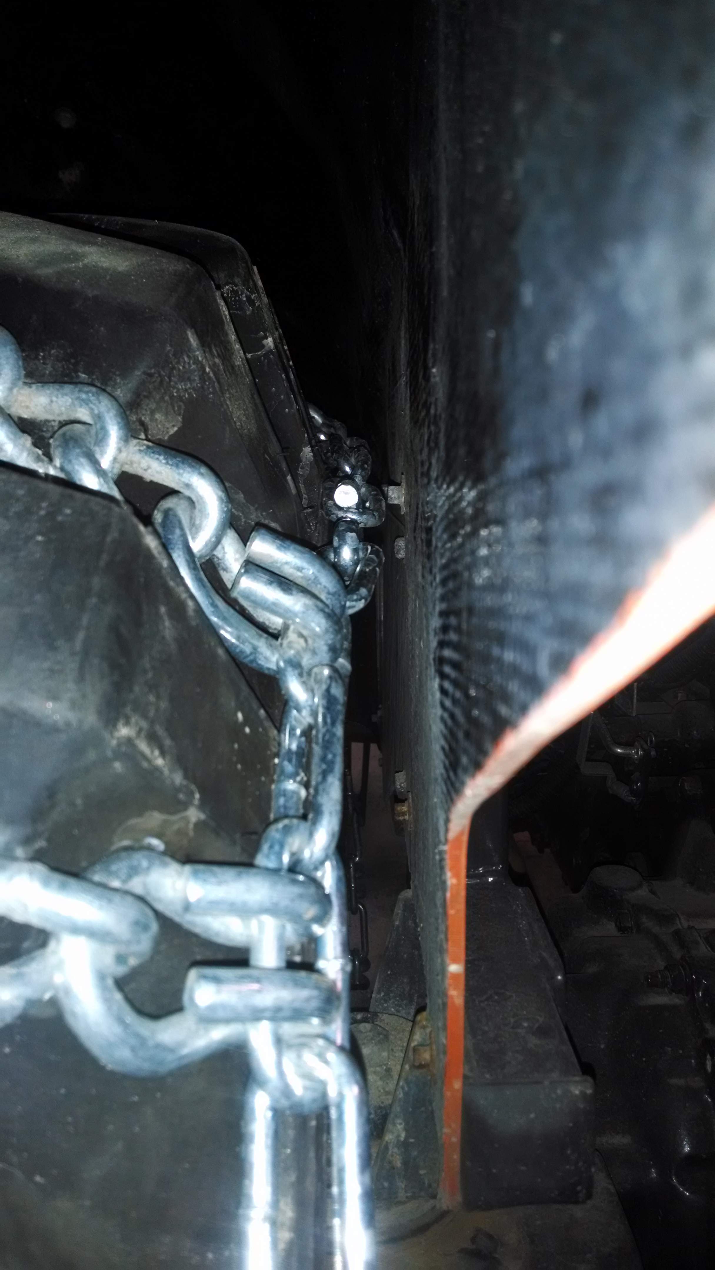

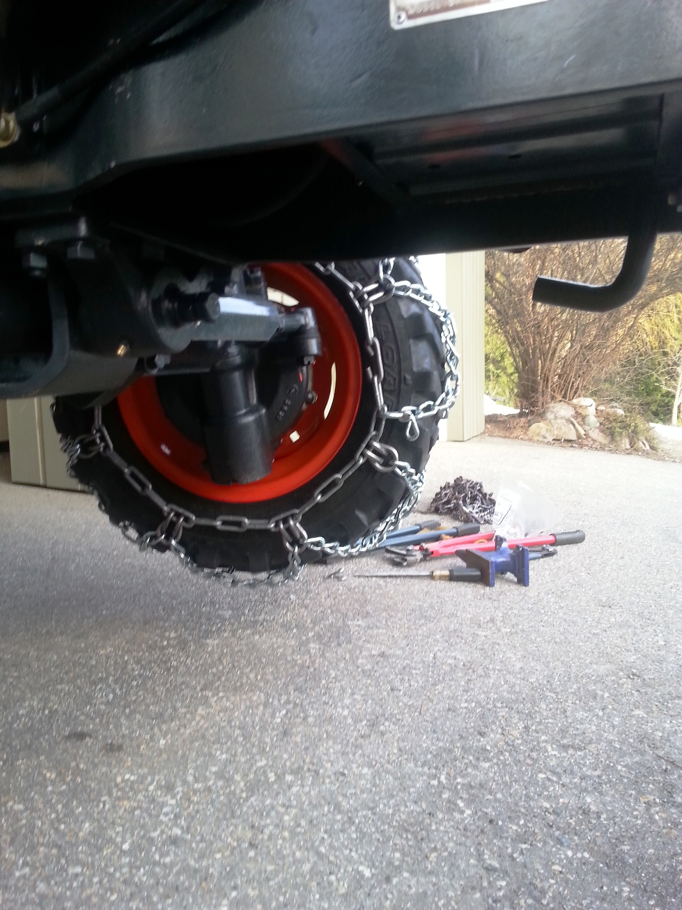

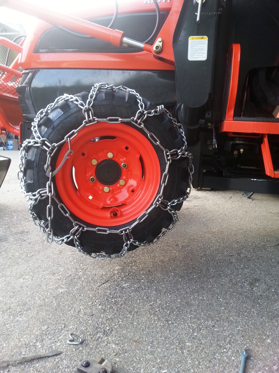

FRONT CHAINS:
(an on-going issue)
I had trouble with my DK35SE front chains this winter when a bungee tensioner broke, the chain shifted, and I failed to notice until I got home. It wore a couple of links as shown here:

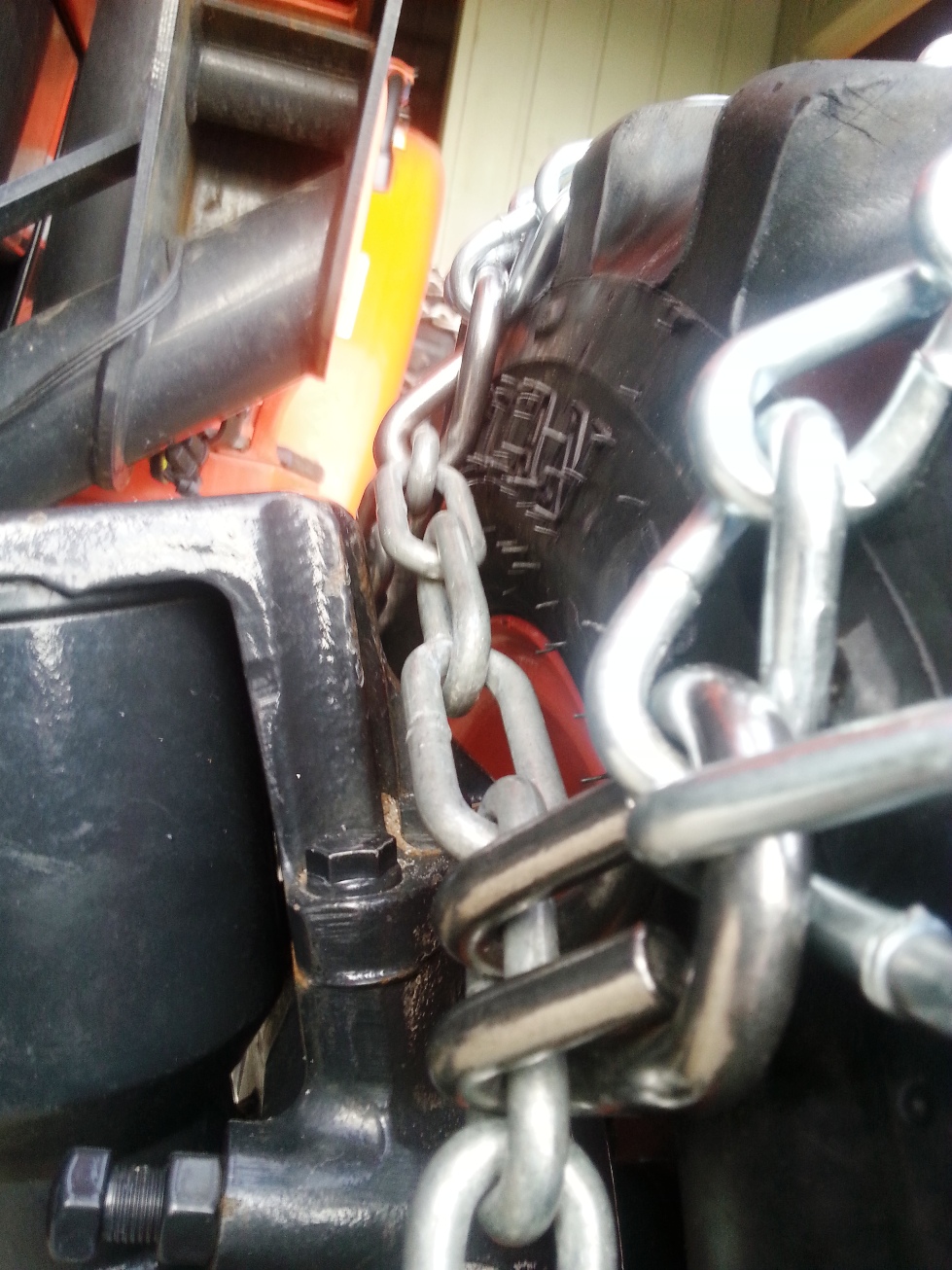

They worked OK since but I resolved to make them fit better. However, some cross chain link welds are starting to separate so I decided to replace them. I got H-pattern(a denser DUO-type pattern) from CanadianChains.com.
H-Pattern Regular Link Heavy Duty - Small Tractor
I thought they might work because they use the same size, 7mm, components as the 2-link ladders I have now. I thought the H-pattern would keep them more centred and higher on the tire. I was mistaken:
A clearance issue arises because the 4-link H-pattern places the side chain closer to the centre of the wheel and the bevel gear housing. The clearance is that tight, but manageable with the 2-link ladders.
So I am investigating two options:
1. (preferred option) keep the H-pattern chains and add spacers. I like the chains and spacers will resolve the tight clearance issue once and for all.
2. exchange the chains for bulk parts and make custom 2-link ladder chains. A clearance issue remains, but is manageable through custom fitting, careful installation, and good tensioners to hold the chains in place.
Friday I emailed Motorsport-tech and Bro-Tec for availability and prices for front spacers, and CanadianChains about returning or exchanging the chains in the event I cannot get spacers.
I realise spacers increase front axle stress, but I don't believe it will be issue. I'll keep the spacer to a minimum(1.5"?) and think the DK35's front end components are strong relative to the tractor/loader capability. The components are basically the same as the DK40/45/50's with the DK35 having a smaller bucket and a loader with half the lifting capacity. That robust front axle design is the main cause of the DK35 front wheel clearance issue. The DK35's smaller tires put the sidewall closer to the bevel gear housing than the DK40/45/50's larger tires.

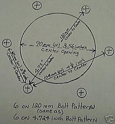

As noted above, the fronts are even more challenging, if not impossible, to safely fit chains without spacers. I ordered 2" front spacers from Bro-tek. They should arrive around March 16. I have heard good things about them and Richard is great to deal with. The 2" front spacers and all bolts/nuts are $290 including shipping. I suppose rear spacers would be in the same ball park.
Richard sent me a smaller CK bolt pattern as a guide to send measurements plus instructions for mounting the spacers when they get here. I've attached those to this post. They may help in your search for spacers.
View attachment KCO 16mm Wheel Spacer Instruction.pdf
As OldPilgrim said MotorSport-tech also has a good reputation. I sent them an email but did not receive a reply. Since Bro-tek also has a good reputation and is in Canada (which avoids shipping/customs/$ exchange complications) I ordered from them. The $ exchange rate might work in your favour.

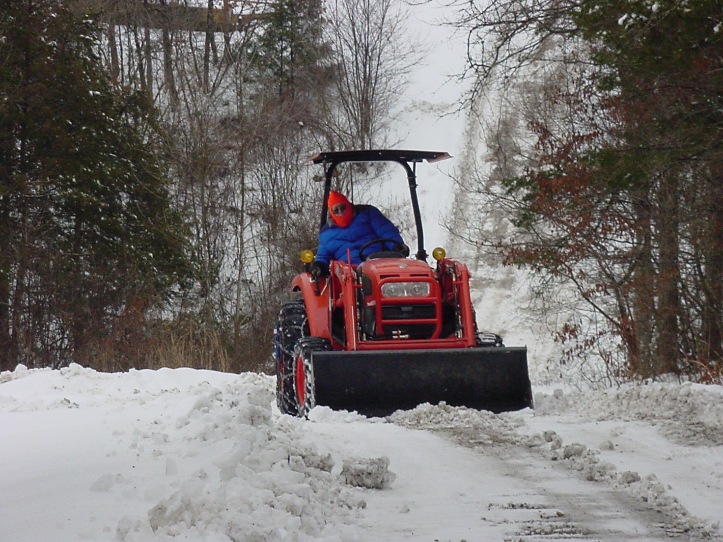

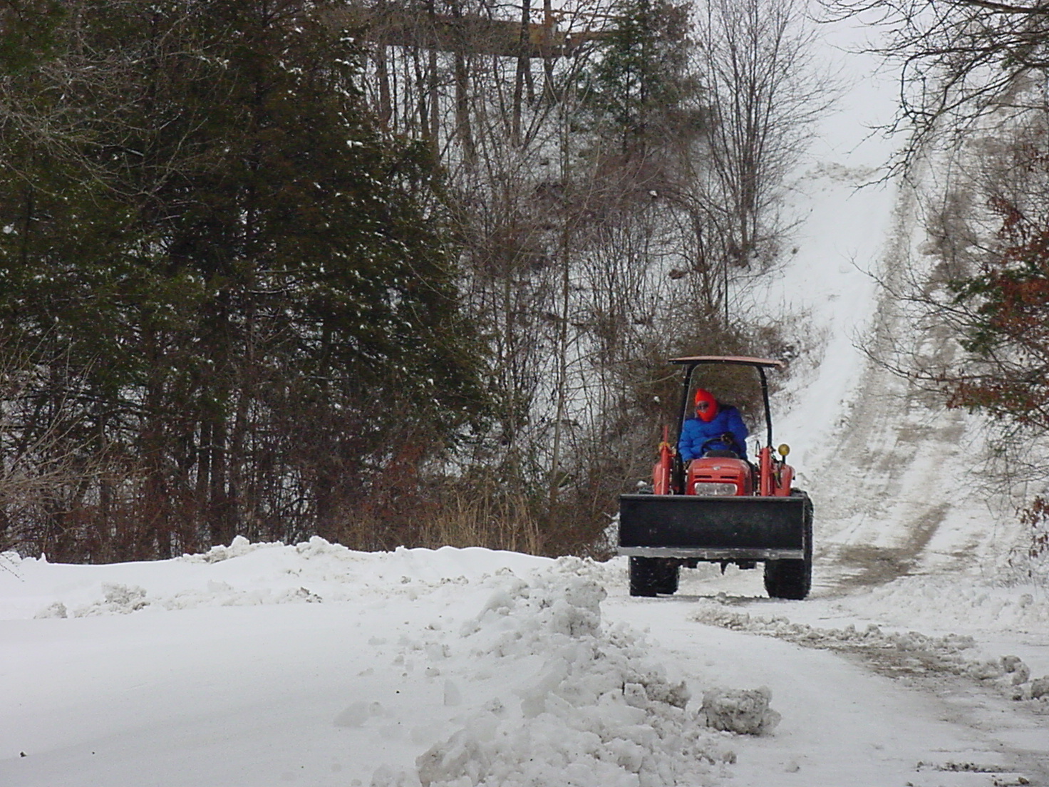

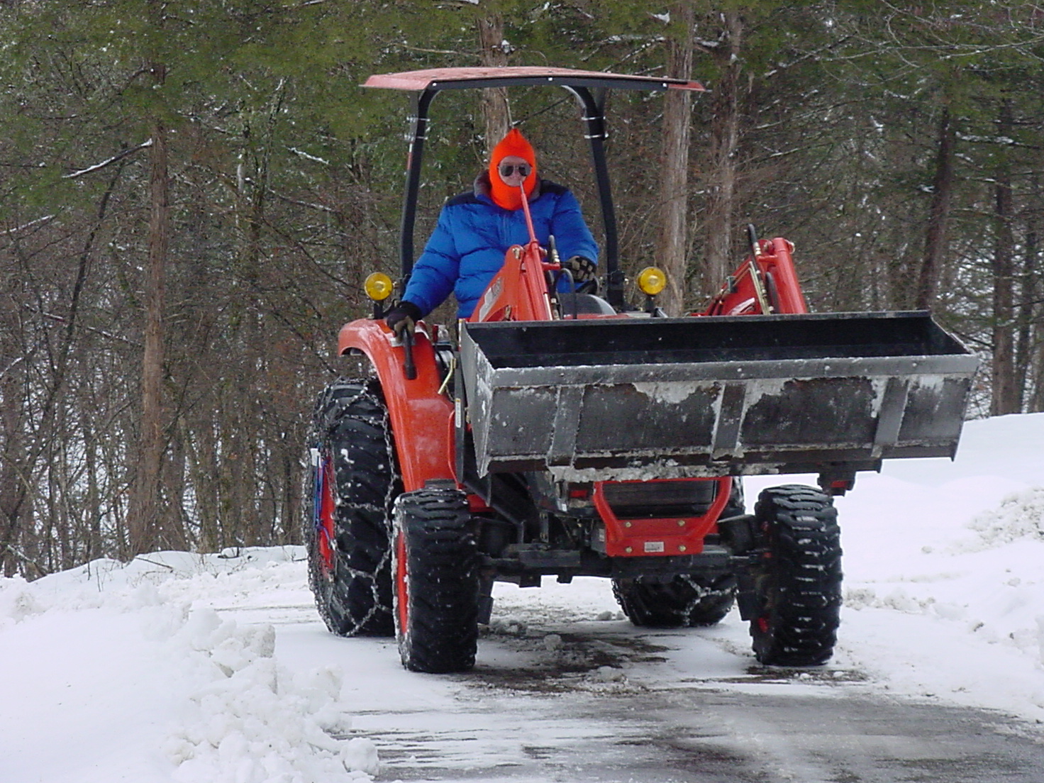

kco, I am really hoping that we are done with the snows this season. and I have until the fall to get the spacers and the chains repaired (shouldn't be hard).. I am not looking forward to putting on rear spacers as the tires are loaded. I think I will groove the front tires before next winter. I have the tool, and I did it to my old Kubota, but I only had one rabbit tracking snow before I traded it off to test it on, so I could not really give it a good test. But others report much improvement. I think I will give it a try.. So with spacers, and the chains back on and grooved fronts,. I will be unstoppable :D
Well with my hills, maybe not unstoppable. Oh, today also the retaining pin fell out of my rear blades kickstand and it got bent up. Just one more dang thing to fix. :mad:

I got my front spacers from Bro-Tec today. They fit great and solve my chain clearance concerns. CanadianChains.com would have let me return the chains for a 20% re-stock fee or exchange them for free. But they will work fine with the new spacers, so I'll let them know I'm keeping them.
The spacers fit perfectly and took about 1/2 hour to try on one side. I took them off as I just use them for the winter seasons. They aren't any more trouble than changing vehicle winter tires.
Here are a few photos:
20150310_BroTek_Spacers_1 (800x600).jpg 20150310_BroTek_Spacers_2 (600x800).jpg 20150310_BroTek_Spacers_3 (600x800).jpg
The specification for the Kioti DK35 front spacers is 6 x 6" with 16 mm bolts. I measured the tire hub opening as 118 mm which must be a standard distance because Bro-tek had a set in stock, and the ones I received were labelled LS 6x6.
The spacers were shipped the same day I ordered them and arrived via surface mail from New Brunswick to the BC interior in 7 days.
