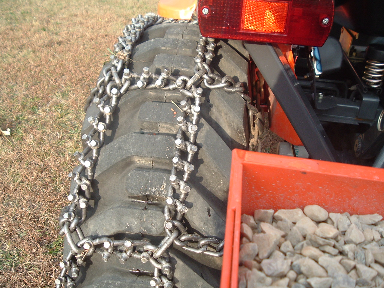

Skyhook, my experience with the DUO chains was similar to DIXIEDOG's. I considered adding cross chains as you suggest (one supplier offers these as DUO ladder chains) but instead I modified them by adding DUO patterns as shown in this thread:
http://www.tractorbynet.com/forums/attachments/268885-duo-chains-planned-modifications.html
and they now work great with virtually no slippage. However, I had to buy a chain tool and extra patterns and it was about a day's work.
If I was starting from scratch I would purchase something like the Aquilines. Other options I'd explore are Tellesfdal and Trygg. They have chains similar to the Aquilines.

DIXIEDOG, those chains you first had that were no good for you,,
is what was given to me with the purchase of my JCB, I haven't installed them yet and may not,
but I was thinking, what about if I added Vbar strips of chain in "the void" area, there's a link there that could take a strip of Vbar chain, what are your thoughts on this?
If you already have them I would ask about trading them in toward a different style chain. You want a chain that maintains contact with the ice all the time....a studded chain will out perform them with ease. I don't like any chains that have voids for ice, even if you add some strips in the voids you'll still get that catch..slip...catch...slip pattern going on which is not good. I think most places would allow you to trade up if they are new chains.

No, there about a year old and came with the machine, so I'm stuck with them.
When and if I get around to ordering some vbar type chain to add to what I have, I'll post a few pics,
I'll take a few before and after shots, I have "5" links between the "H" patterns on mine, way too much I think, I'll bring those down to "3", so I'll have to open all the side links that hold the chain:confused2:
this should give me more of an overlap to the side tire, at least half way down, right now they overlap about 2 inches when I put them on.
