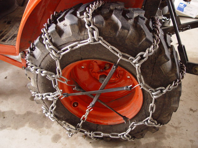

For what it's worth, I have R4's with four link chains - attached is a pick.
I haven't had problems with the chains falling between the lugs, as the chain drapes over the lug.
You may just need to reposition them rather than physically changing the chains.

Appears your chains are too big for the tires, both for the cross chains as well as the side chains. But if they work okay for you, that's great.
I agree with your comments that you made about the cross chains not falling between lugs on R-4's, to the point a change in chains should be necessary. I keep enough slack in my chains so each cross chain falls out of a lug just before it comes down to the ground/tire contact as the wheel turns.
