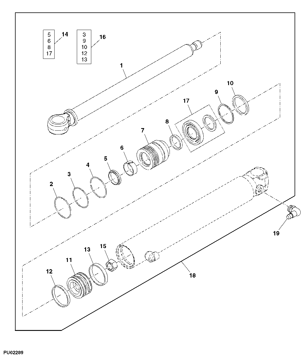

Another quick question (since I started the thread, I can hijack it, right?). I am trying to find the part number for the hydraulic cylinder for the backhoe stabilizer. On the JD site I can find the part numbers of all the components that make the cylinder, but not the cylinder itself. Any idea where I can find a pn for a complete new cylinder?
It is AH213904, part number 18 in the diagram.
