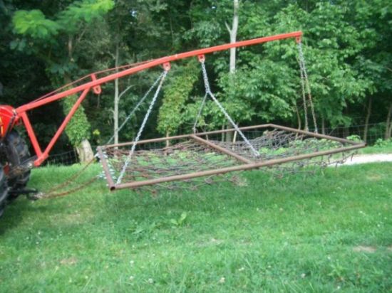

FWIW, I think you might have just hit the wrong salesmen at the wrong stores, or else it's just a regional thing. There are no shortage of chain harrows here. I like them because you can size them to the job. I got the type that has individual mats about 4x4, but they can be hooked together. Right now I've got four of them configured in an 8x8 grid. The tines are angled so that they're more or less aggressive, depending upon which direction you pull them. They can also be flipped upside down if no "scratching" is desired.
I also built a frame around it, and lift the whole thing with an extended boom pole. That way I can travel with it on the road, between fields, et cetera. The best part is that I can back into a corner with it. In addition to being useful to spread manure, I also use it to disperse trampled hay around the feeders. Towed without the boom pole, I can mount a broadcast spreader and scratch the seed/fertilizer in as I spread it.
Pretty versatile investment.
Edit: photo attached

Greg, the setup you have is almost exactly what I am looking at. Is yours a Fuerst or similar?

Anyway, Greg, I was going to ask about how the tines (in aggressive mode) when being dragged over pasture, will get all "clogged" up with the stuff all over the ground? And, if so, does one have to dismount and clear it?

I got the four no-name 4x4 foot sections and an 8 foot wide tow bar from an area farm supply store. Welded three sections of inch and a half pipe to the tow bar to make the 8x9 foot frame. A fourth pipe was added in the middle to make the frame a bit more rigid. Attachment points were welded to the four pipe sections. I configured the 4x4 sections into an 8x8 grid, and placed the frame around it. Chain repair links connect the grid to the pipe. The tow bar is hooked up to the tractor's drawbar for towing. If I have a job that requires transporting the thing - or reversing - I add my modified boom pole to lift it.
The connection links are the threaded type, so I can remove the harrow sections from the frame to reconfigure from normal to aggressive, or from upside down to right side up. I'd say normal is ok for breaking up manure, but turn them around to aggressive if you want to aerate/dethatch or scratch in seed/fertilizer. Upside down does a pretty good job smoothing loose gravel. Mine clogs occasionally in aggressive stance, but most of it falls off withand a shake of the boom pole. What doesn't fall off, I can get rid of by lowering it back down and reversing the tractor a few feet.
Price of steel has since gone up, but I seem to recall the four sections and tow bar was ~$300. A factory "lift kit" for an 8x8 grid would have been another $400, so I went the used pipe and boom pole route with a local welding shop.

<font color="green">I was going to ask about how the tines (in aggressive mode) when being dragged over pasture, will get all "clogged" up with the stuff all over the ground? And, if so, does one have to dismount and clear it?
</font>
Yes the tines will get clogged if you have alot of junk in your pasture. I actually like this because it helps to keep my pastures clean. We use one like Greg's on a daily basis in the spring, summer, and fall. They are worth every penny for maintaining nice pastures and stimulating pasture growth. The work well for spreading rock as well.
You can buy the carrier for them from any of the company's that sell them. The carrier are definitely very nice to have. Also the carrier can be used as a leveler when you have it all the way down which makes it nice for spreading dirt and rock.
