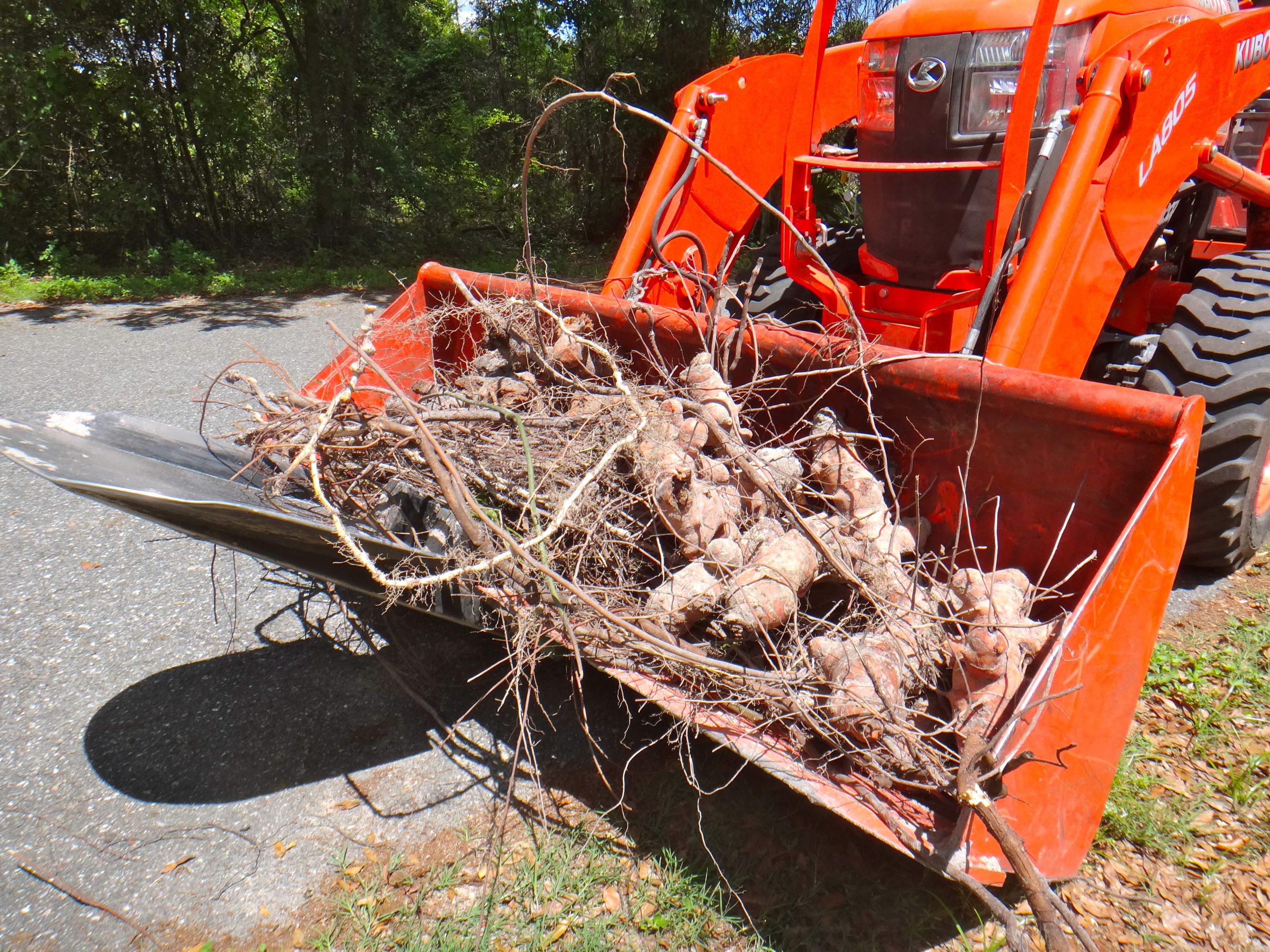

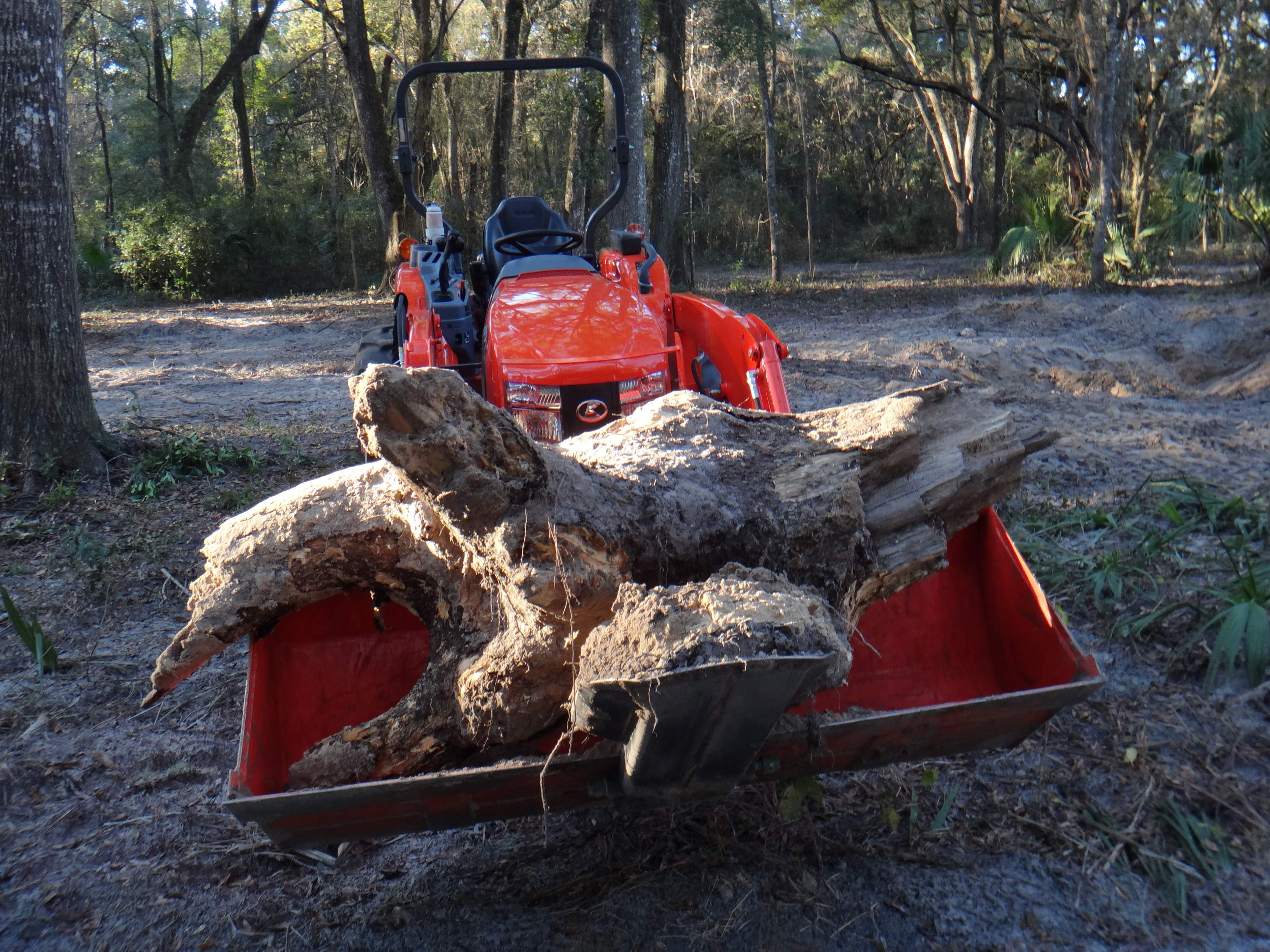

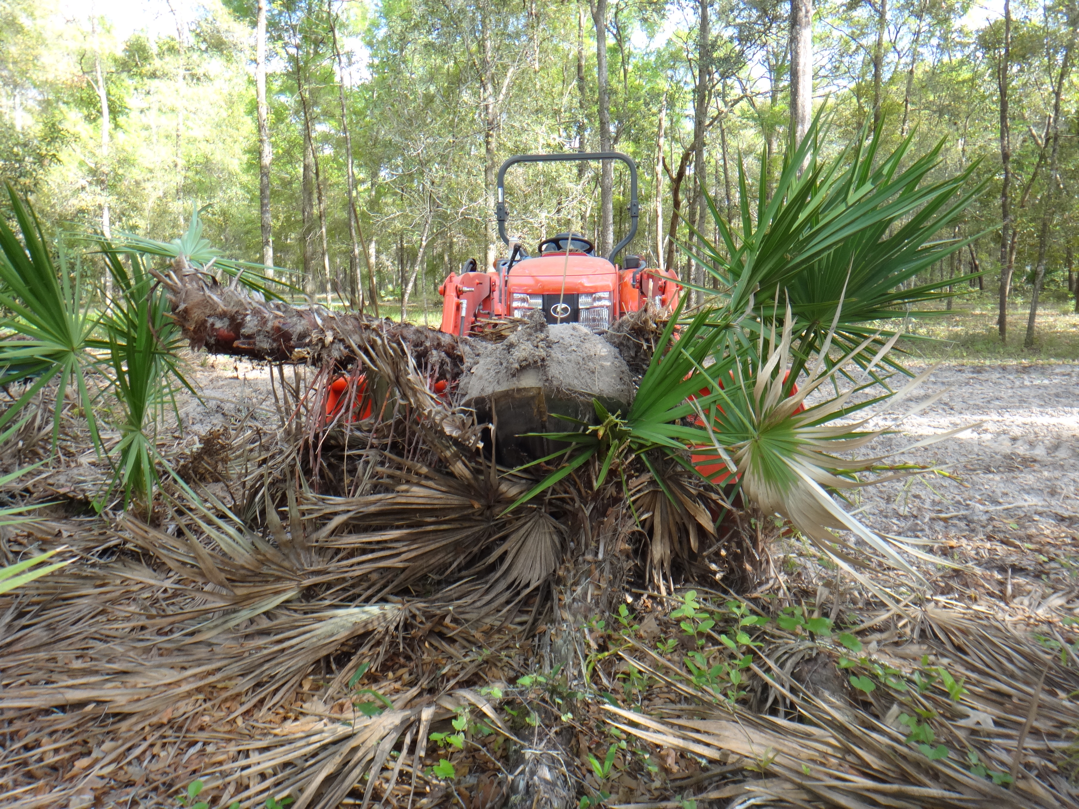

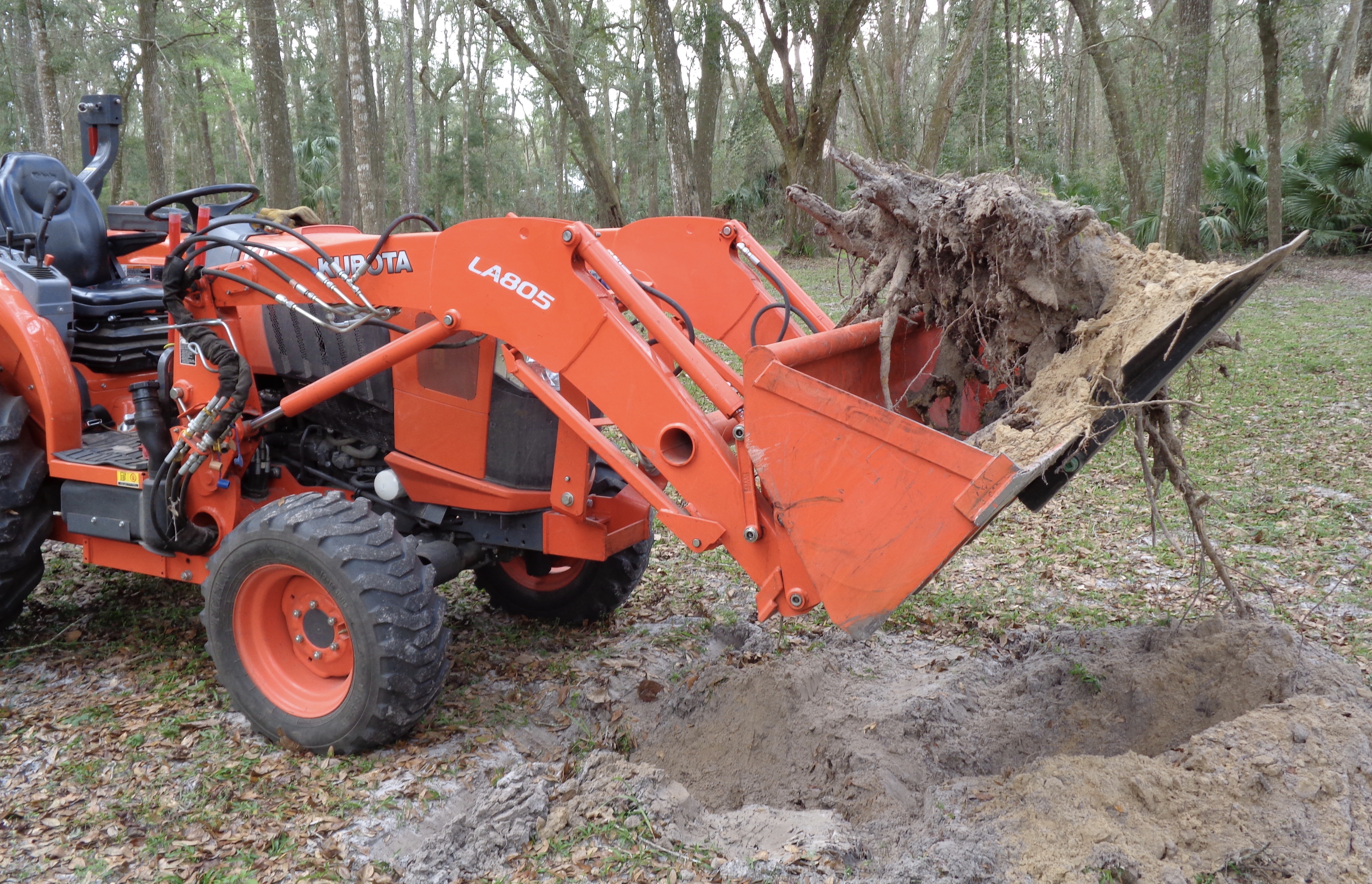

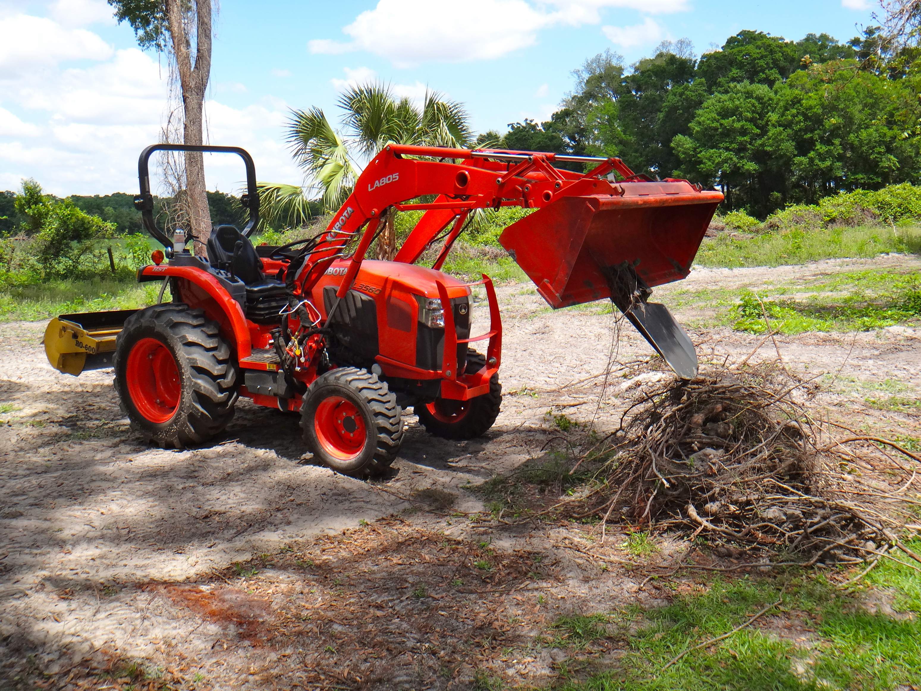

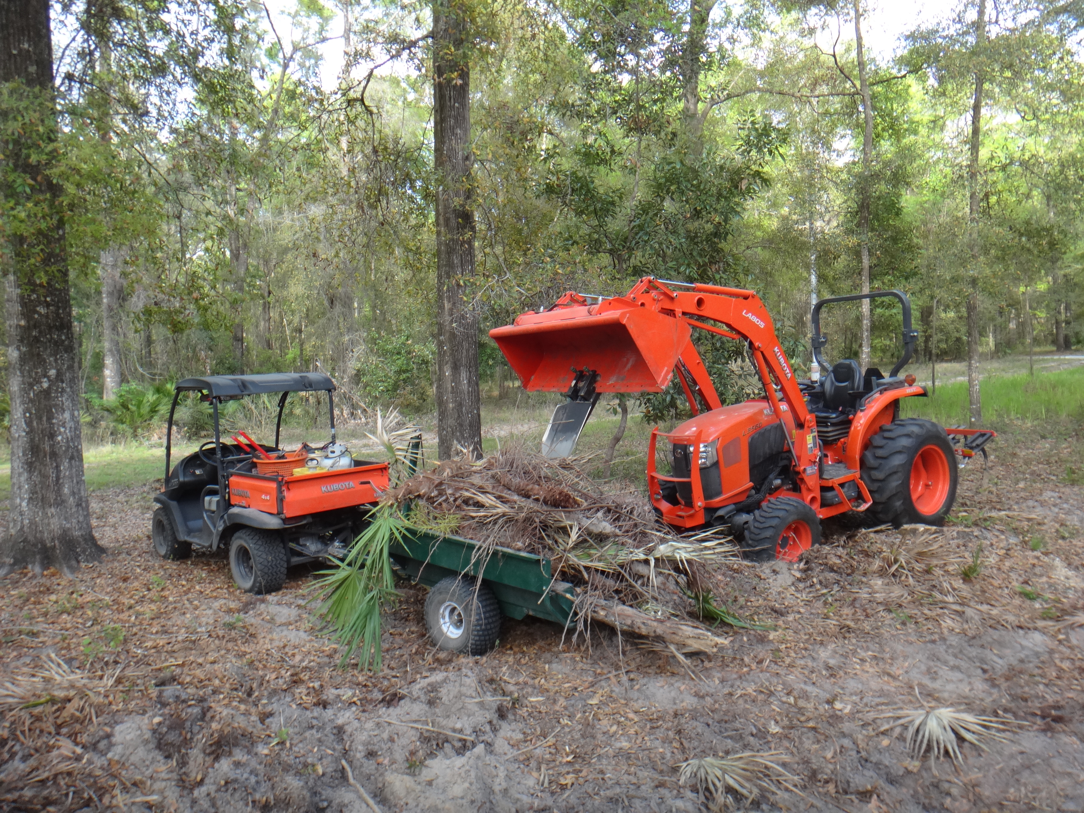

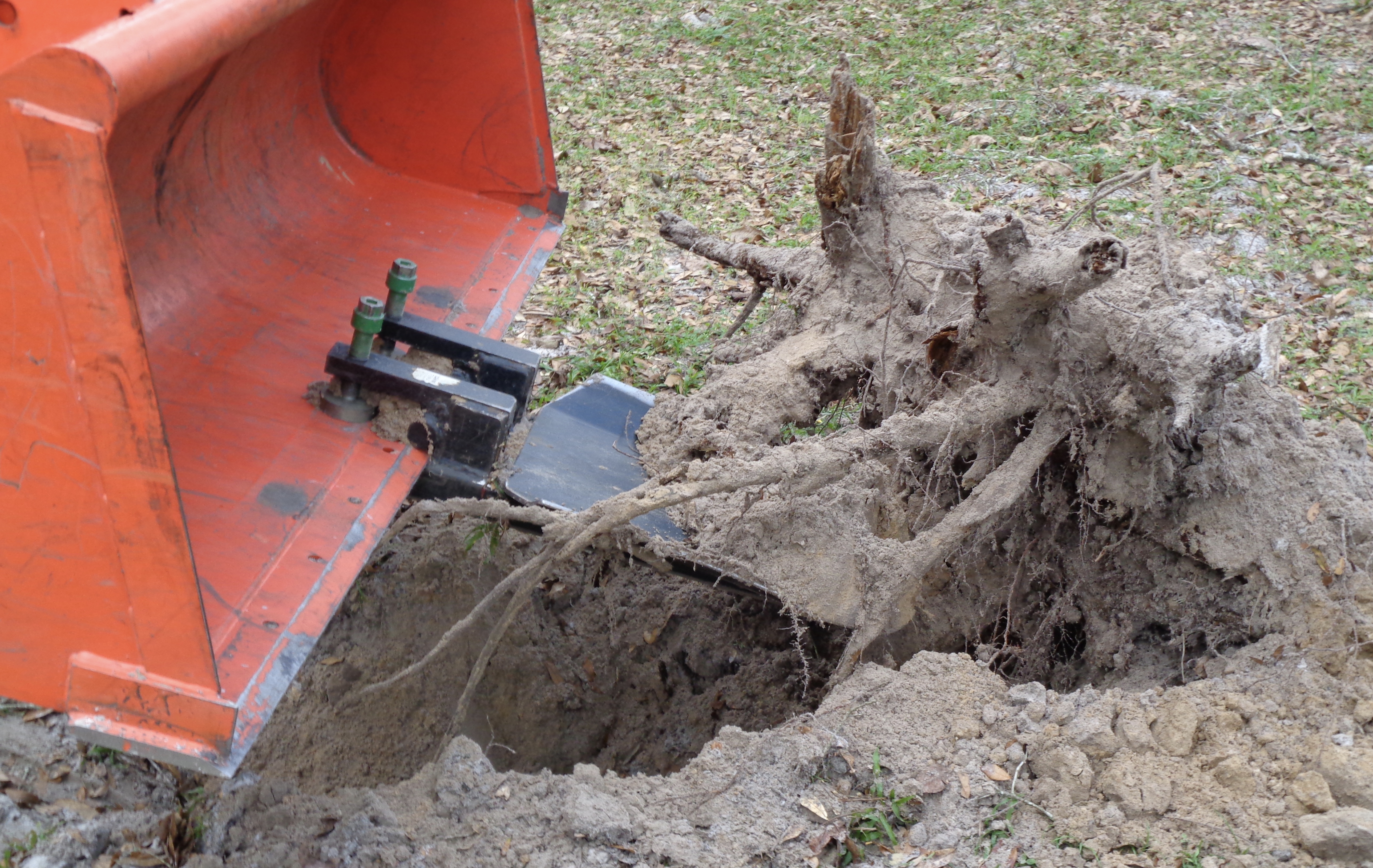

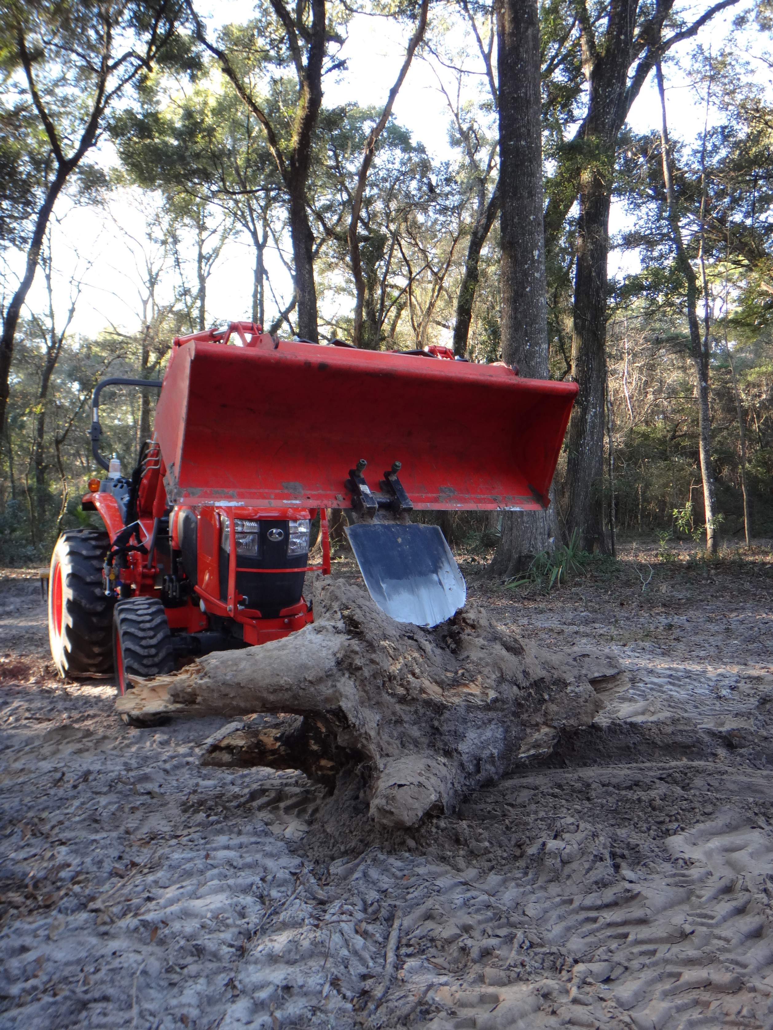

2) You have not been very informative about "digging".

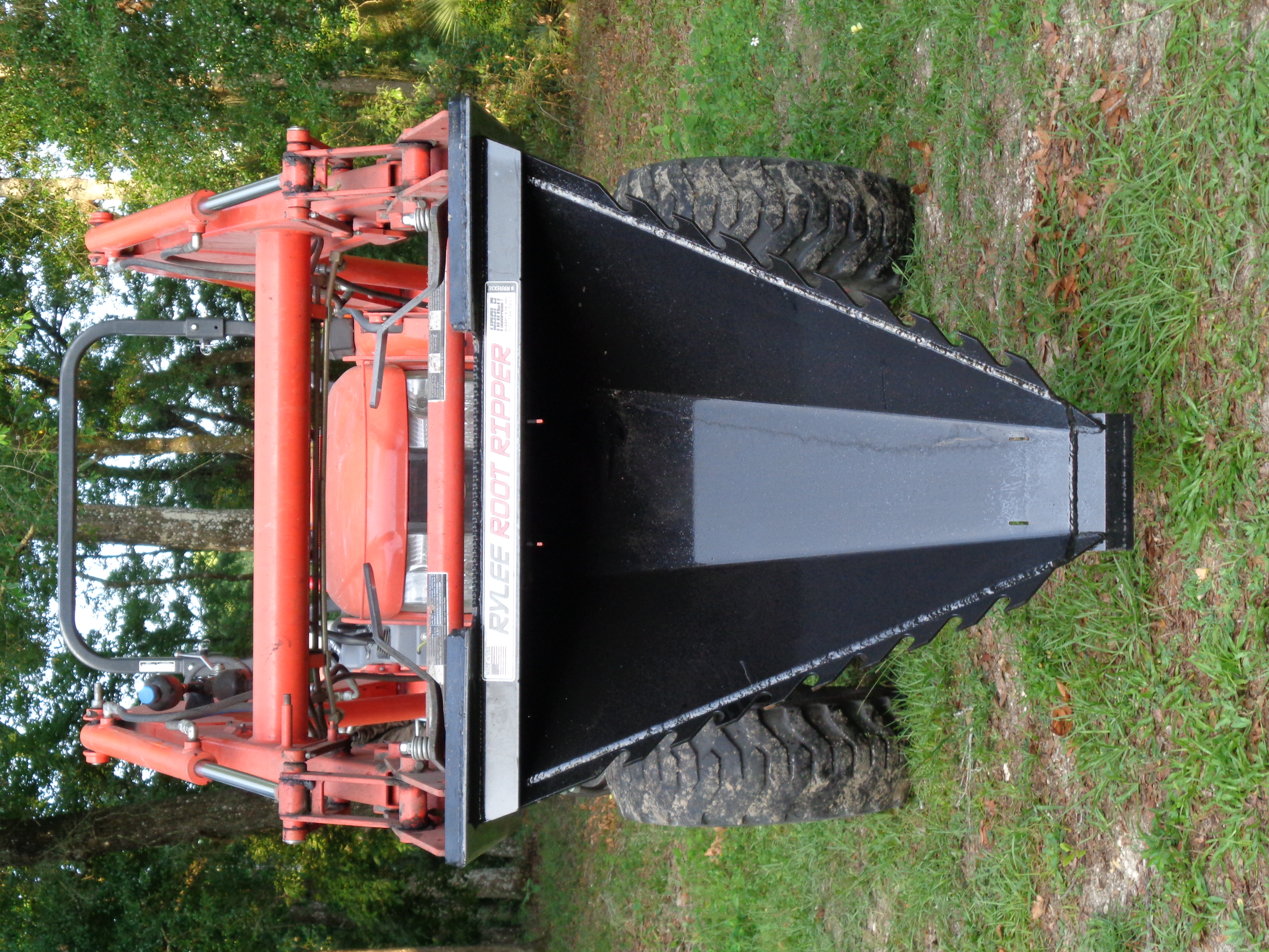

Consider a clamp-on Bucket Spade or a SSQA attached Root Ripper. These attachments are best on Skid Steers but also functional on Utility class tractors.
If find a Bucket Spade more useful.
VENDER LINKS:
Tractor and Skidsteer bucket spade shovel
Rylee Root Ripper | Haala Industries

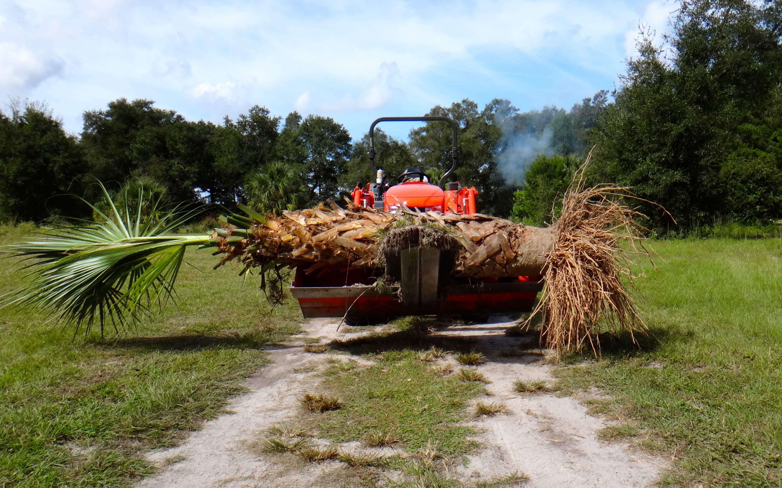

What bucket attachment are you using to lift Oak logs? Pallet Forks?
Is there a reason you cannot use a chainsaw to cut green Oak logs into 2,000 pound sections?
What about dragging uncut green Oak logs from the rear/center drawbar with chains?
You should be able to pull 4,000 pound log loads easily at low speed.

Our property has never been cut before. When trees do come down, we are talking about monster sized hardwoods. Taking them down to small enough pieces means they are not able to be sold for lumber. I can and have skidded logs I can not carry, but I would rather not do that. Skidding grinds dirt into the log as well as leaves drag marks behind which seem to always cross my hay field.
Consider a tractor Log Arch for large trees.
Tractor Arches T30 and T36
Tractor Arches are designed to be used with tractors in demanding forestry and urban situations. The Tractor Arches are super strong and come in two sizes.
The T30 is built to handle logs 30" in diameter and weighing up to 4000 pounds. The T30 has an 8' reach and is capable of carrying a 16' log fully suspended.
The T36 will handle a 36" diameter log that weighs up to 6000 pounds. The T36 has a 9' reach and is capable of carrying a 18' log.
The arches are capable of carrying a 30' or longer log when using a Fetching Arch as the tag axle to pick up the tail.
MANUFACTURER: Tractor Arches T30 and T36 - LogRite Tools LLC
