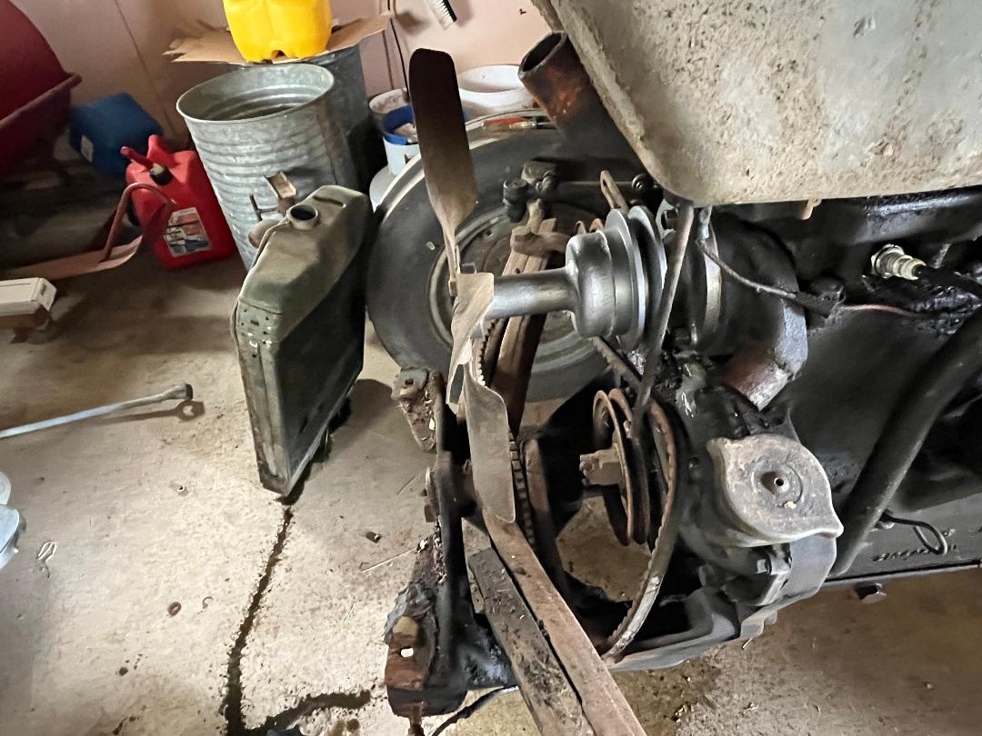

Ir seems like everytime that I go south there are always too many things to do. Yesterdsy I finally pulled the radiator and changed the water pump. It took me longer to get one stupid cotter pin out than to drain the fluid, take off the cowl, pull the radiator and swap out the old part for the new. I had planned on just getting it running enough to load it onto a trailer and bring it home but it doesn't make sense to put the old radiator back on. I had forgotten how easy
these old machines are to work on; also how virgin steel bolts didn't rust in place the way that recycled metal does.

If the old radiator doesn't leak, I'd put it back on, and run it until it had pups. I've got a half dozen 50's era tractors with OEM radiators and all have the original ones, and they get worked pretty hard occasionally. If it ever does leak, I'd consider getting it re-cored IF you have a decent radiator shop in your area. Being that old, many won't repair them because the core is just plain rotten, and hard to repair.
