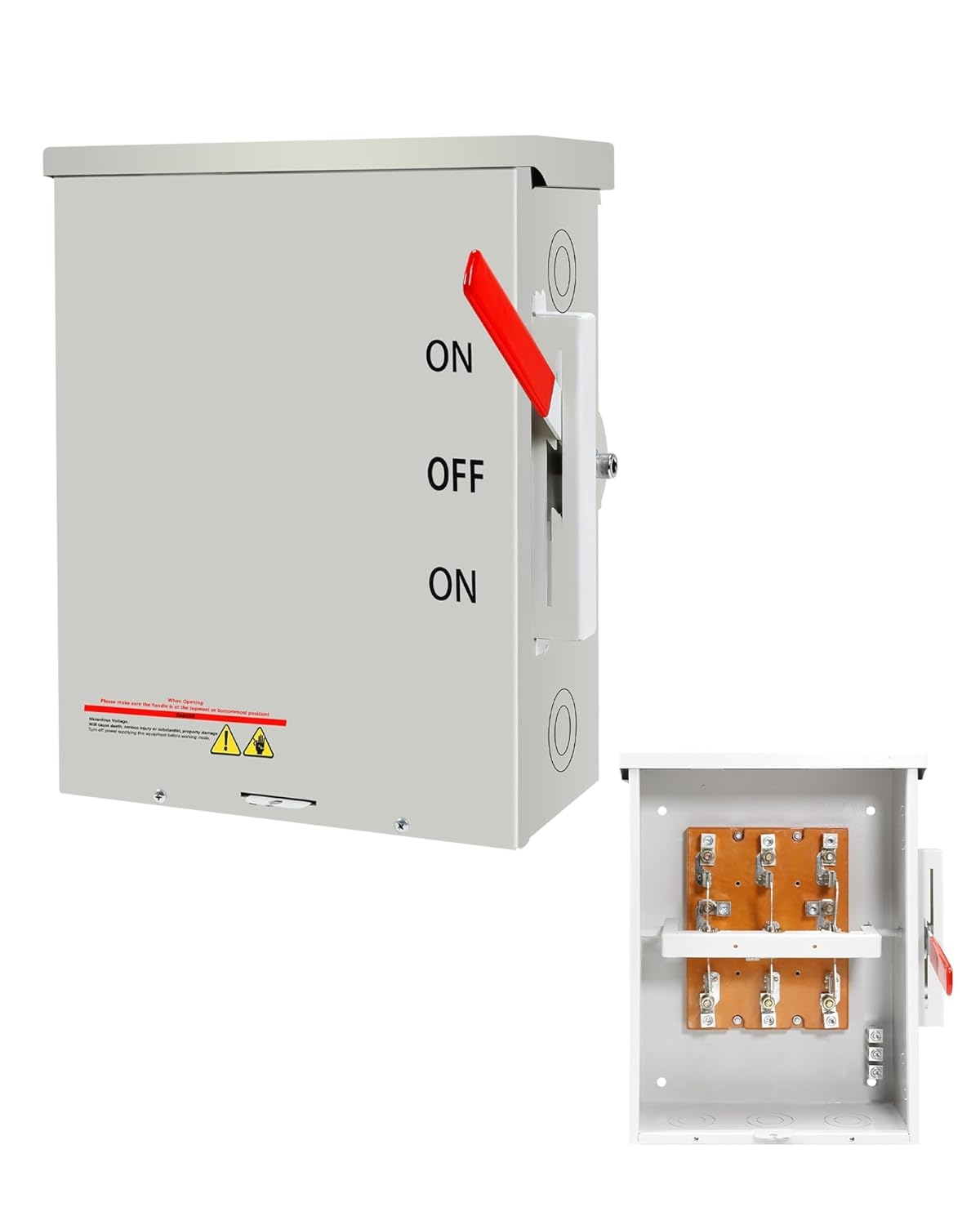

It will be dependent on the transfer switch you have installed. The smaller stand alone switches only cover the loads wired into them.
Then this type which will allow all loads to be powered on a generator, they are available as manual as shown or as automatic transfer switches (ATS)
Here is a decent article on transfer switches;
Generators and Transfer Switches: A Comprehensive Guide

A larger transfer switch will enable a larger generator to power more. A 240V transfer switch should enable both 120 and 240V circuits.
A whole house transfer switch would enable the most support for keeping things backed up. (Usually 200A) Whole house generators often have options for their own automatic transfer switches.

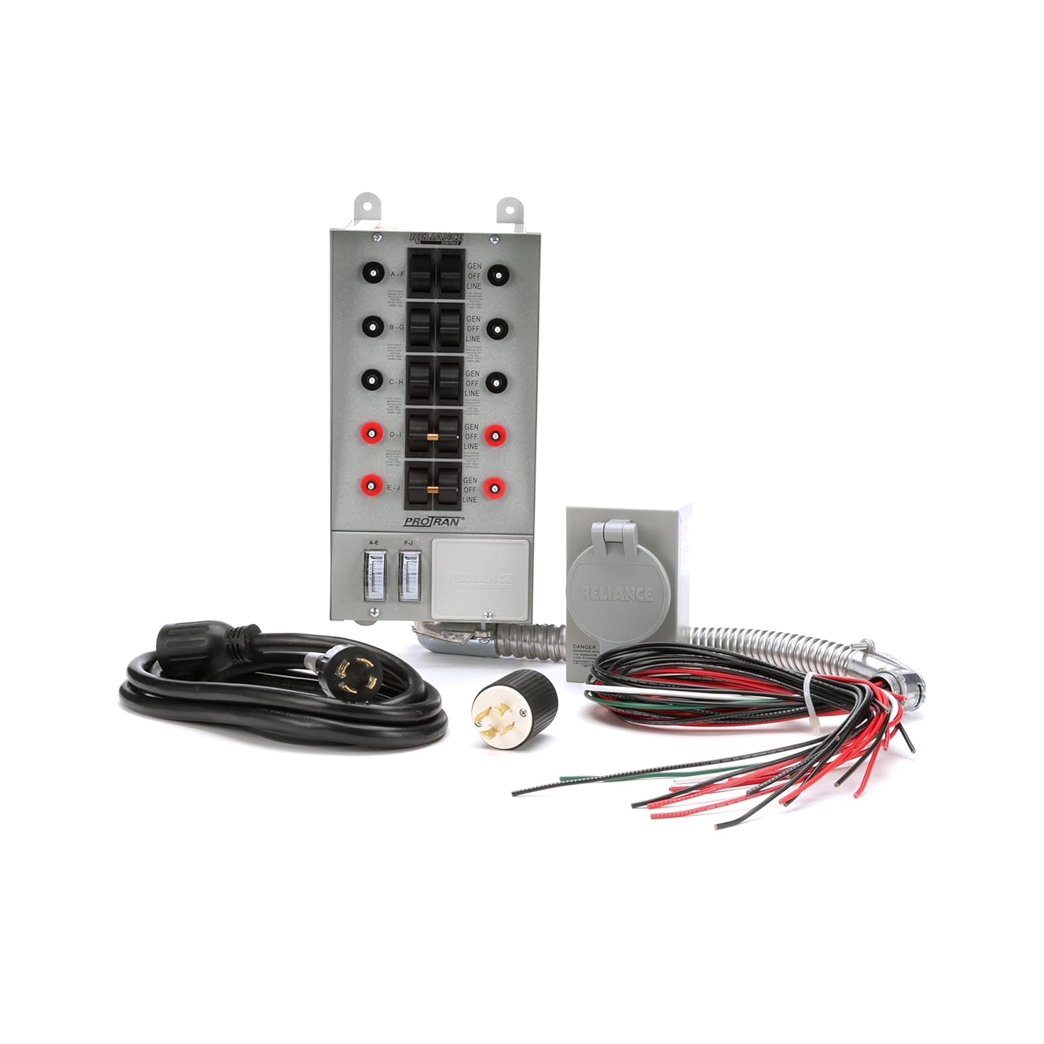

Mine is an "interlock kit" style, similar to this:
I shut off the main breaker powering my 200 amp service fuse panel, then slide the plate blocking that switch, then flip the breaker for generator input. That's how my setup is isolated. So I guess the breaker they installed for the generator is what will determine how much input it will handle? I'll have to look when I get home and see what amp rating that one is.

They are a decent very inexpensive way to go.

Generally, the breaker is sized to the generator, and thus usually much less than the panel it is supporting. (E.g. 40-60A for a 200A panel) I think of the breaker getting sized to protect the generator.
@Blue Mule Like @LouNY, I think that they can be a simple and cost effective solution, but each panel takes its own particular interlock, and not all panels have interlocks available, and not all panels can have the generator breaker bolted down as is required in some AHJs. Bottom line: it may not work for your panel in your area, but it might.
