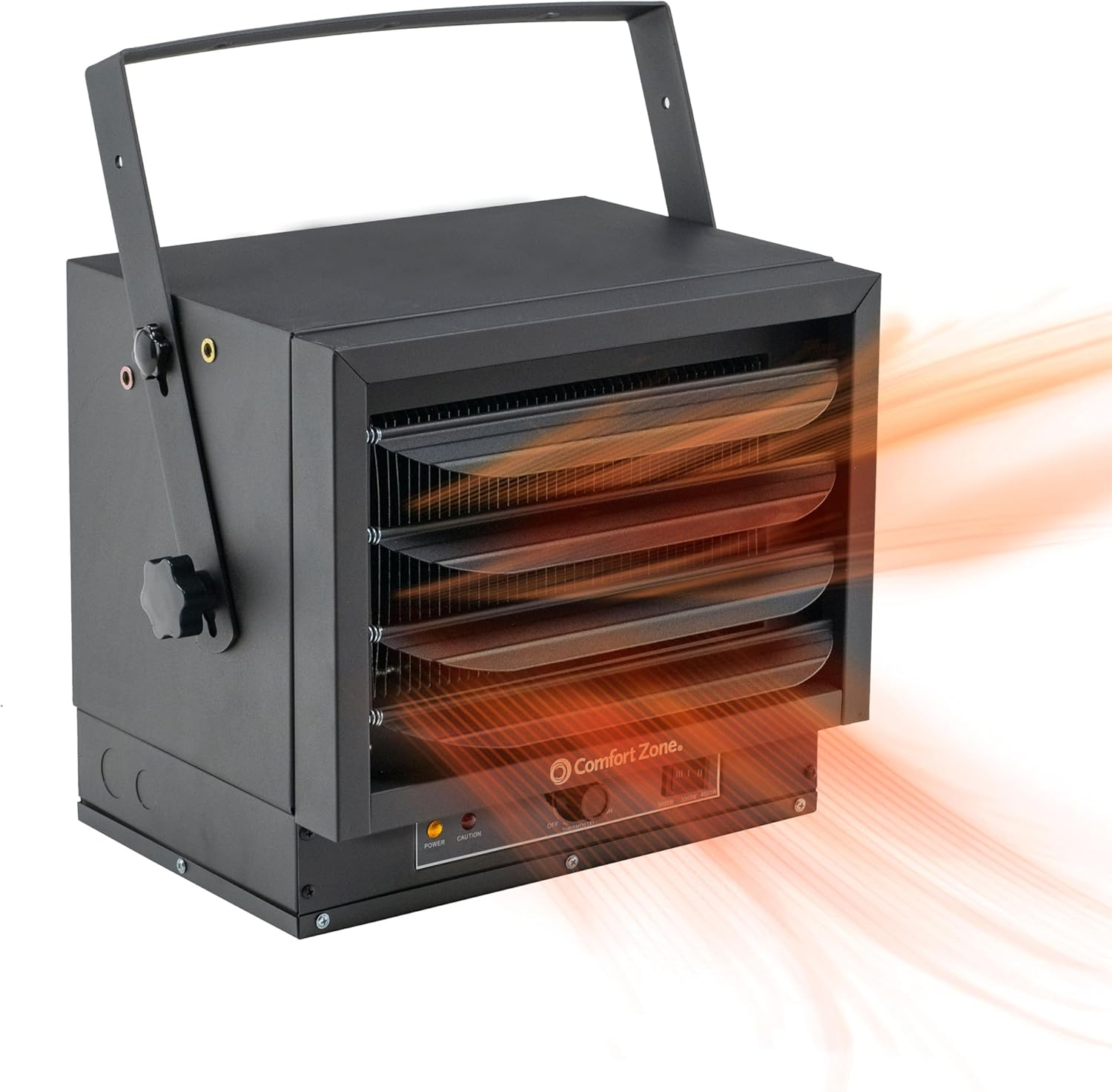

I just ordered two of these 5000W heaters:
Each has 3 heat settings so I can vary the load.
I can also use them to warm up equipment in the barn if necessary. Also to warm myself while working on the equipment. :)
   / Time to check out the generator. #149
I use the 10kW version. Works great! I think two 5kW is actually probably more useful. You might check the wiring underneath the bottom panel when you get yours. My 10kW had some wires resting on some rather sharp sheet metal edges.
