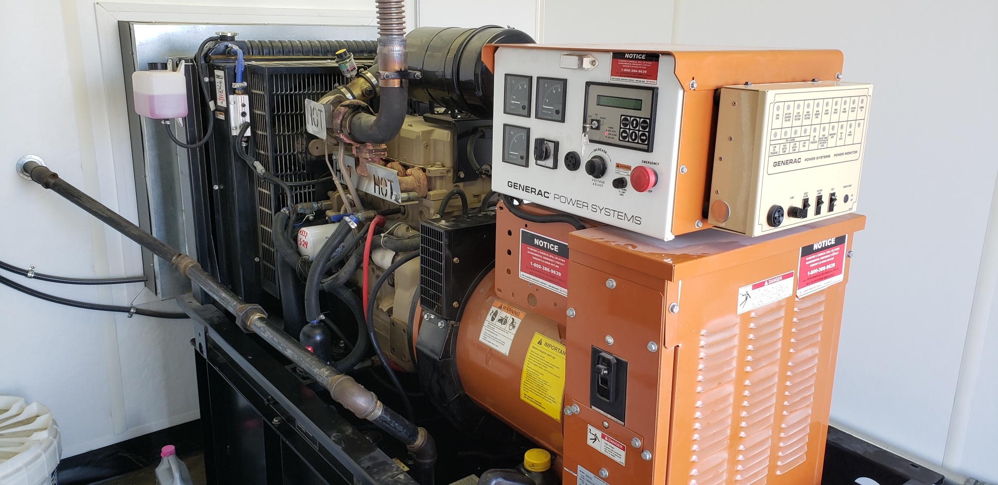

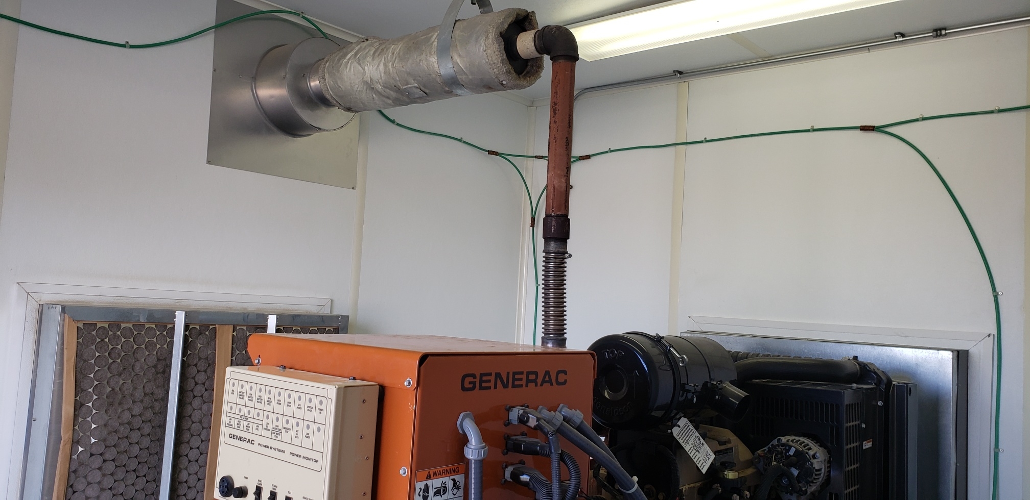

wouldn't we all like to have one of these?
It powers a cell phone tower in my field.
