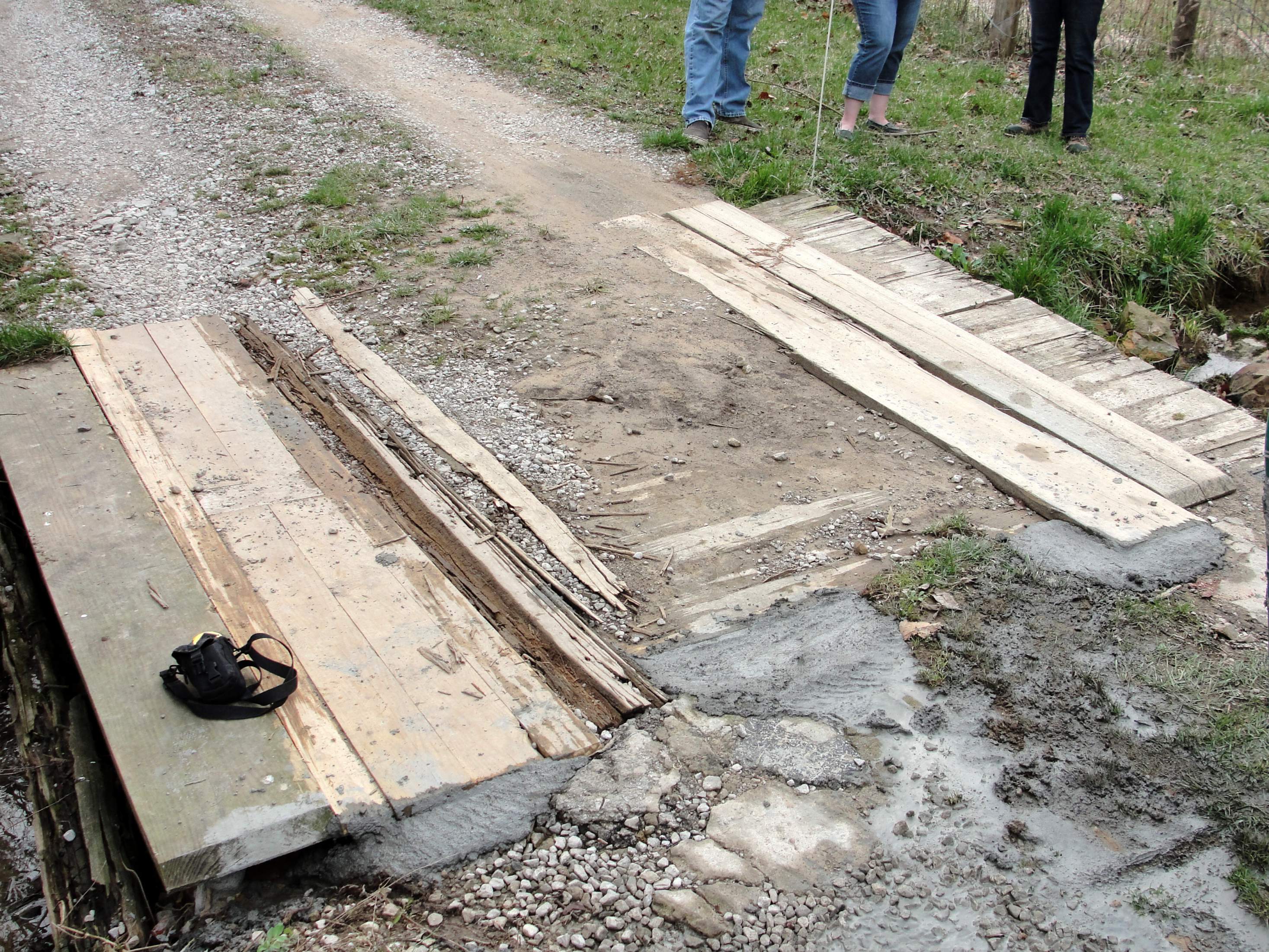

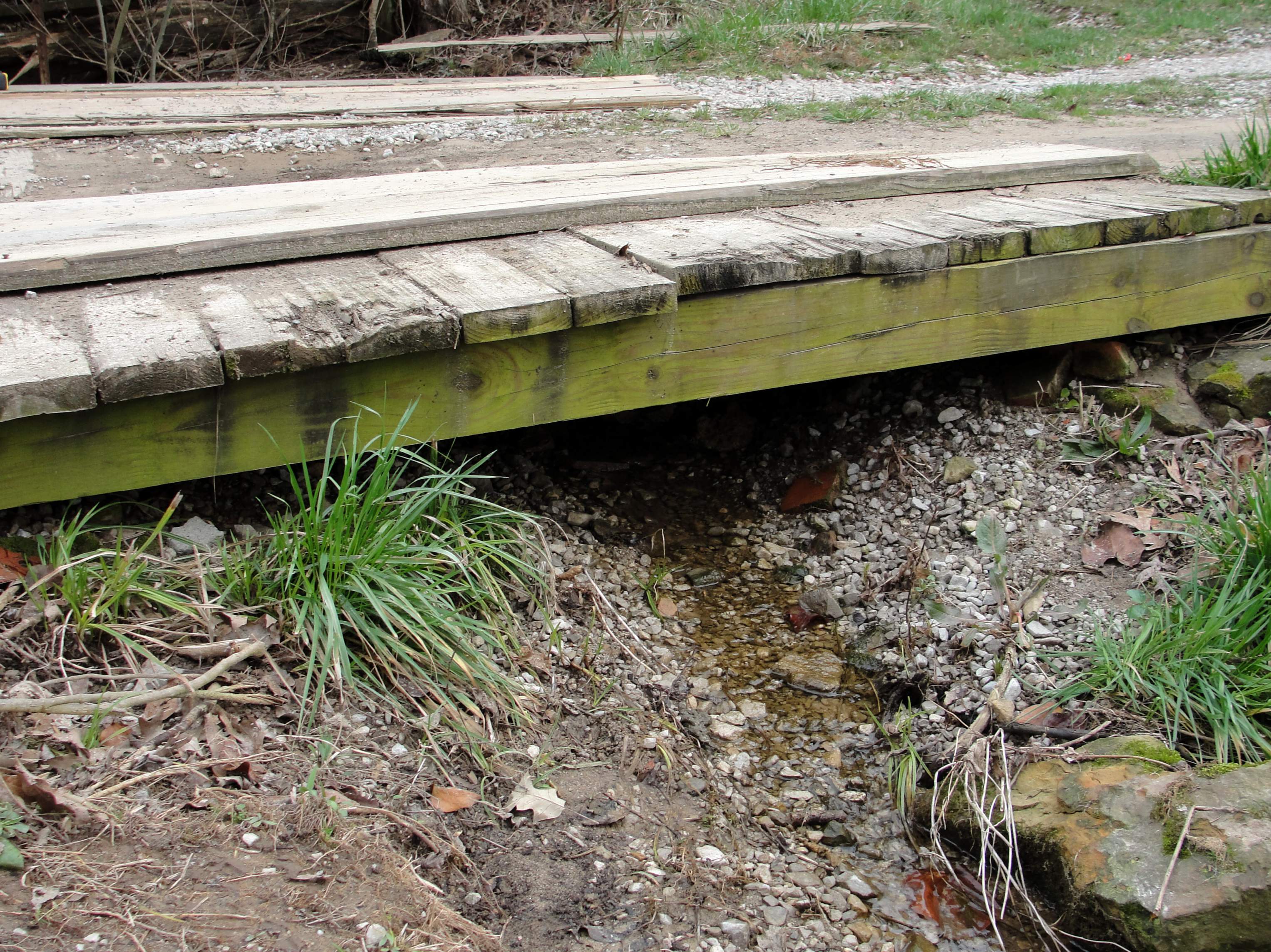

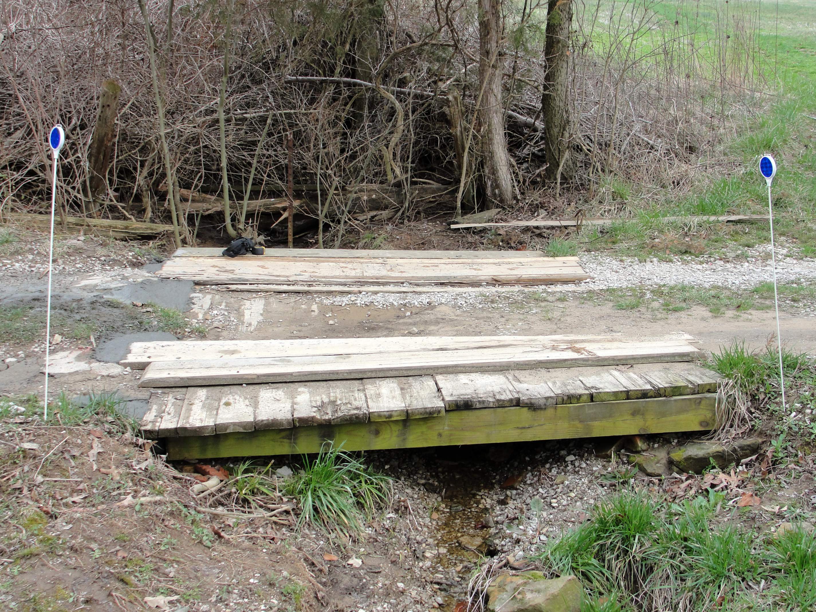

This old bridge needs replacing after a hard winter outside of Bowling Green, Kentucky. It usually has only this amount of water trickling under, but in a big, hard rain there is enough water to wash over the surface.
I want to building it so that a gravel truck can cross it with much needed loads for my driveway. I am thinking about treated 8" X8"s. How many would I need and at what spacing? Then treated 2X boards across the 8X8s. I will have no idea what the footing is like until I do the demolition. It is 8' long and 10' wide.
Suggestions? Links to plans or articles?
Thanks, JeremyL.

Couple of culverts, side by side? Assuming you can fill enough over the top.

I've always preferred large culverts or a concrete ford instead of a bridge. Use a bridge when the crossing is too high above the water for culverts or ford, or there is too much water flow.

An 8x8 wouldn't be better than multiple 4x8s spaced closer. Minimize the clear span as much as possible. The SPC (southern pine council) has or used to have good free info on beam strengths.

Looks like an easy place for a culvert. Seems a better choice than a bridge
Agreed. The size needs to come from the drainage area upstream and your ability to let over flows wash over the road at a relief point. Just a 24"if you can relieve it and maybe a 30 or 36 inch if not.

The area of the waterway under the present structure appears to be a triangle about eight feet wide and three feet deep. 1/2 b*h = 12 sq. feet. A 36" pipe has a cross sectional area of 1.5 *1.5 *3.14159=7.07 sq ft. But a smooth bore pipe will flow more water then an open channel.
Another thing is you can look at the nearest pipe downstream and upstream and see how big they are.

Culvert does make sense. If you really want a bridge, build it higher ramping up on both sides. Pour substantial concrete footings and tie the beams to it somehow to keep it from floating. Use 2 x 12's for beams, not square sections, as many as required for your design load using beam tables.
