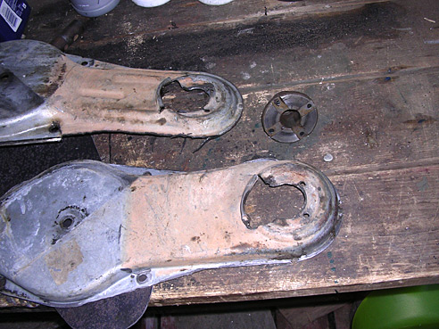

I maintain the dirt directly under grape trellis wires tilled most of the year. I have regular front tine tiller and it takes a lot of my back to get it tilled let me tell you:mad: I basically come from the side and till that foot or so, than yank it back and move to the side and do it again. My lower back is getting the best of it.
I was thinking to remove half of the tines on the left side and go front and back the row in two passes - does it make sense? I feel I should alternate the tiller somehow but I am still in process of problem solving.

/ Tilling under trellis
Well I don't have 100% proof of course, but seems like tillers don't take tilling with half of tins very well. The chain cover - that holds also the tins axle - is cracked and busted beyond repair. I didn't take it apart yet, but I suspect something about one side only tilling prying the tins axle out and eventually braking the housing.
The good news? The tiller is ready for complete rebuild to fit my needs better:thumbsup:

The front tine tillers I am familiar with usually came with a pair of tines on each side. You could remove one set on each side, but not both sets on a side because it wouldn't be balanced. Maybe that's what cracked your housing.
Here is the damage. Gotta say that the tiller is not build very well - but it was most likely me who killed it.
