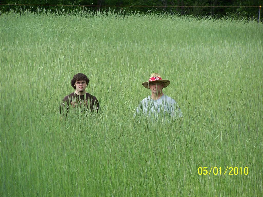

Here's a picture of my rye when being tilled a few years back. I'd love to see a picture of your 6' rye.
That is about the height mine was at the end of Feb first of March. It really amazed me how tall it got. I did take a couple of pics Saturday before I bush hogged. I will try to post them tonight.
I used the RC but the problem is the tires on the tractor flattens the rye before the rotary cutter can cut it.
/ Tilling Rye for Green Manure
here is a picture of the rye before I mowed it down. We had to move to the edge of the field for my wife to take a picture.Out in the middle you could not see us. I am 6' and you can see how tall the rye is behind us.
