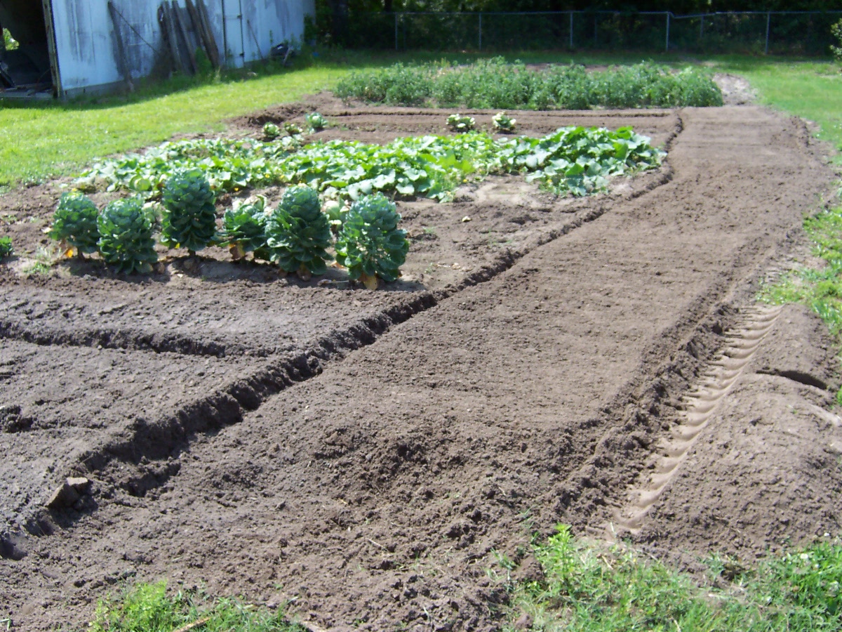

Smaller tillers that I have seen can be offset to cover the tire track. I just bought a used 4' tiller and I cover my tire track very well.
This tiller is supposed to be run at 540 PTO RPM. My tractor, Branson 3510 has tractor RPM about 2600 RPM to get 540 PTO. I have been running the tractor at 2000 RPM and the tiller still does a great job.
In the tilled dirt pic I was tilling toward the camera. Looking to the left you can't see a tire track.

Since I just got my 4'er last weekend I'm no expert at using it. If you look at the pic, to the far left I made three passes side by side and I put the skid in the skid trench that was left by the last pass. It seemed to work well doing it this way on ground that I have been working.
I have basicly 4 planting seasons here. What I like about the 4'er is I will be able to go in between old crops and till for new. I still have a few cabbage and brussel sprouts from the winter plant.

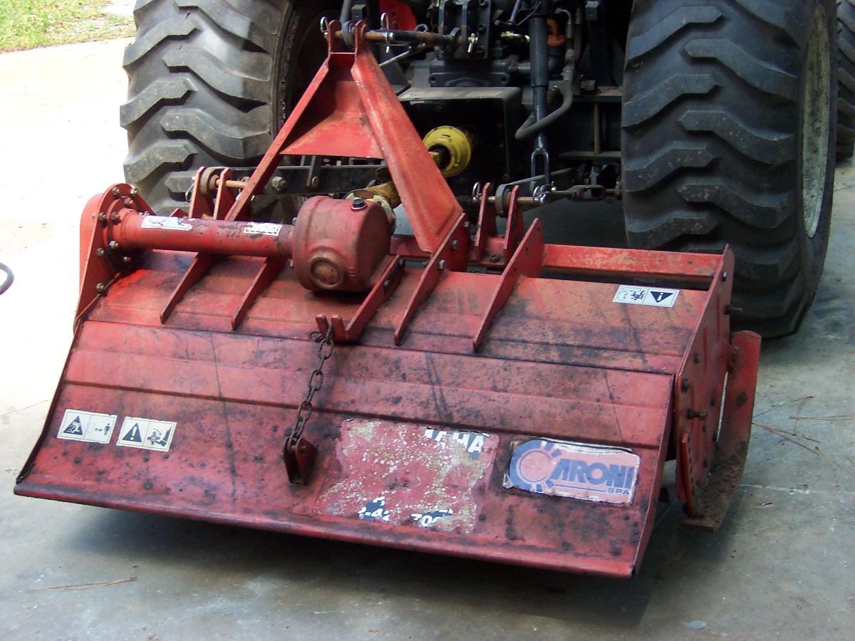

A 655 will cover the tire tracks on a 3320 or 3520 or 3720. With the R-1, R-3, or R-4 tires, as long as the rims are NOT flipped around to wide stance. A 655 has a cut width of 55 inches plus skid shoes on either side = 62 inch width.
The only time you will see tire tracks is when turning. If your property requires a lot of maneuvering then the 665 will cover the tracks no matter what. A 665 plus skid shoes on either side will come out to a 72 inch width.
The John deere commercial tillers are the best out there. I've hit concrete, rebar, wood, car parts, and pretty much everything else without one problem.
In Pic-3320 R-4's, 655 Tiller
