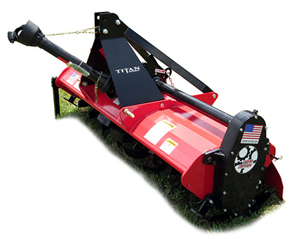

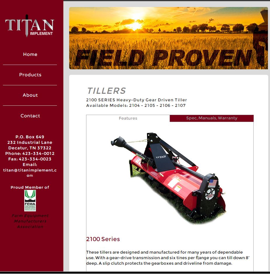

Looks like a different Titan than the forum sponsor: Titan 2100 Series
/ Tiller woods or landpride #12
Sure does look like a KING KUTTER, and several others with gear drive. Guessing they're all made same place, different place.

Go back up and read post #10, note the picture. This is what comes up when you click the link:
I did find a dealer selling the 72" Titan tiller for $1700 plus shipping.
It is hard to tell, but from the Titan pictures it looks like it might not be quite as ruggedly built as my King Kutter.
