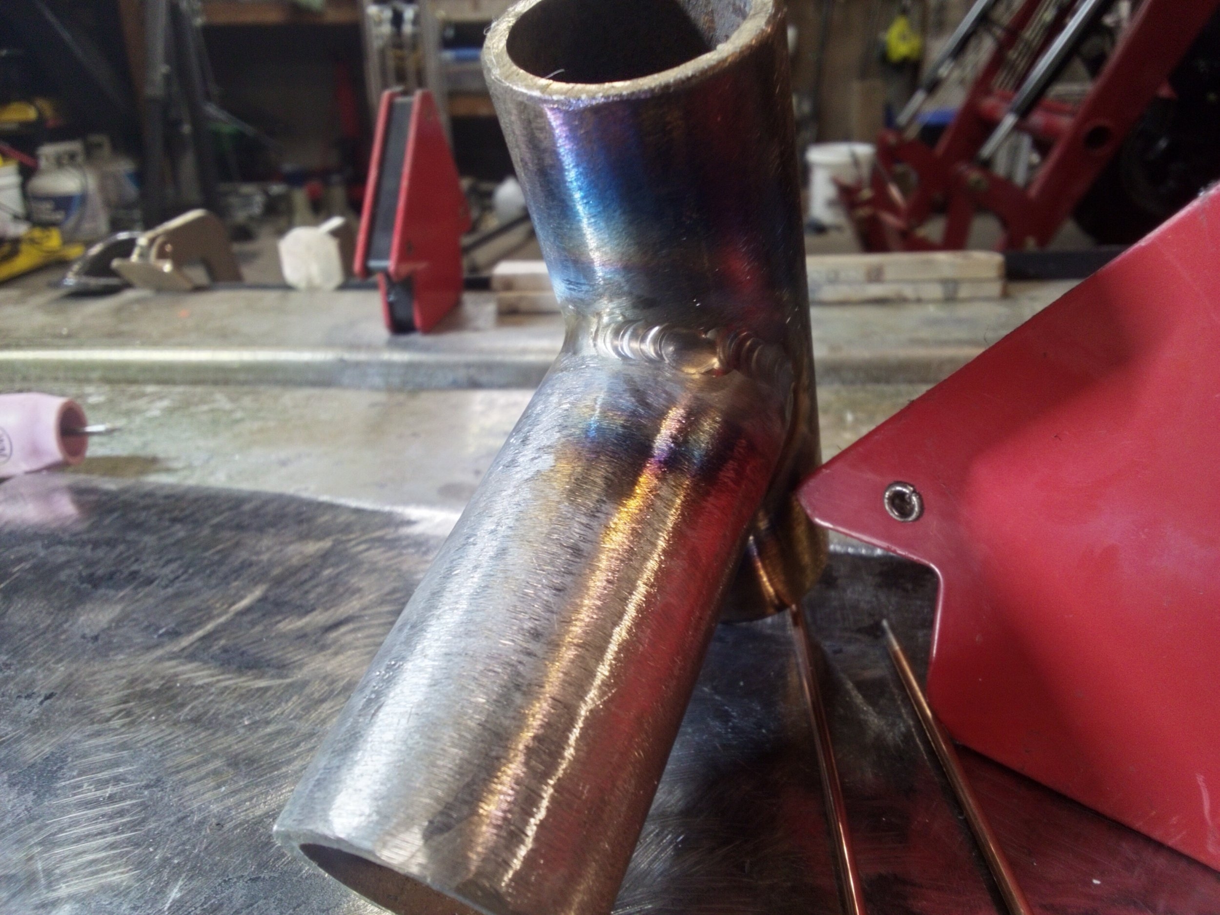

Here is some coped pipe from today. Think she got a little warm.

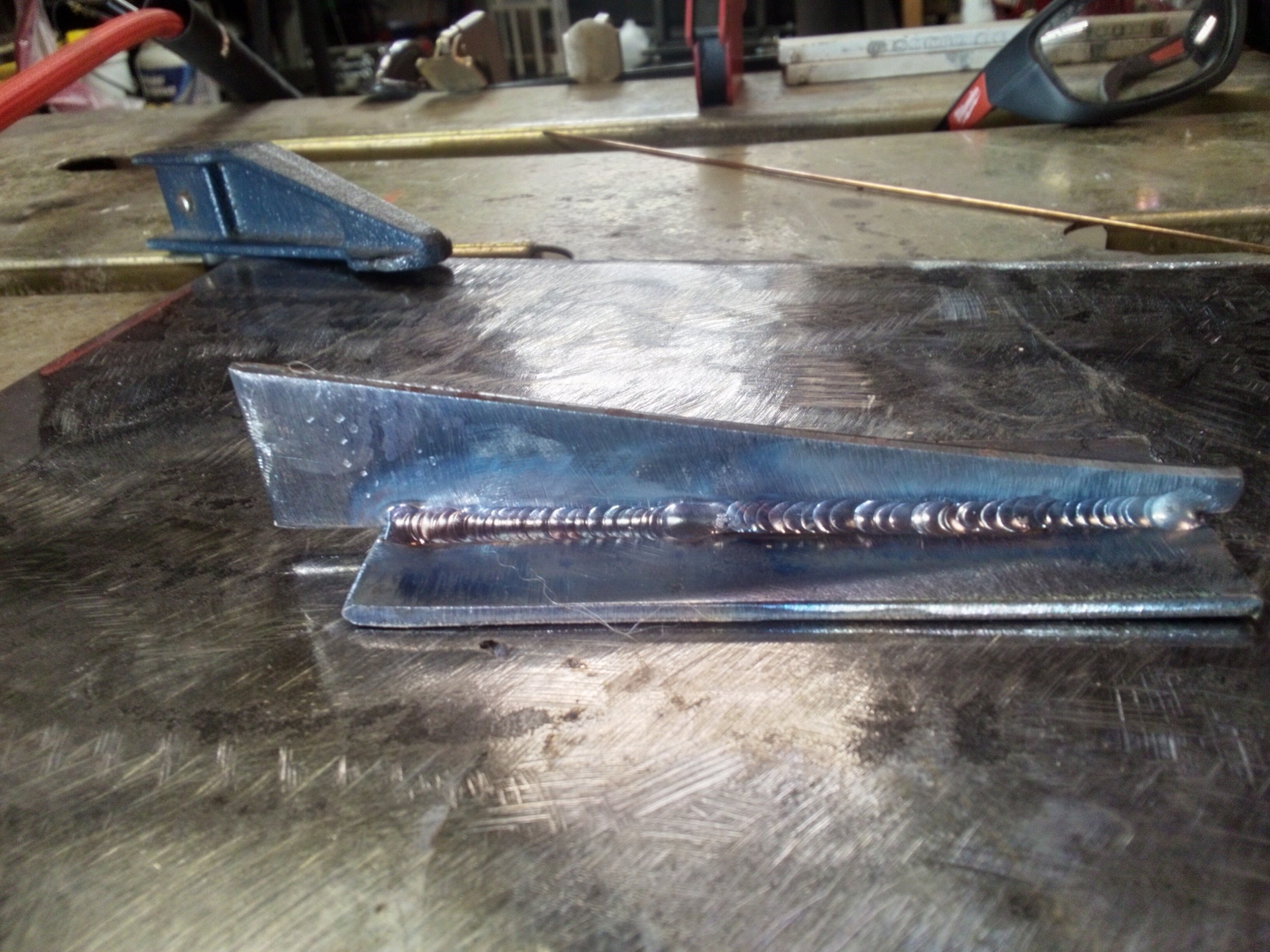

Trying out a technique I saw Jody from welding tips and tricks do. He called it back step. Start in the middle and took it to the tapered end then start at the end and take it to the middle. Kinda a cool technique to keep the heat out. Terrible weld but you get the idea.
