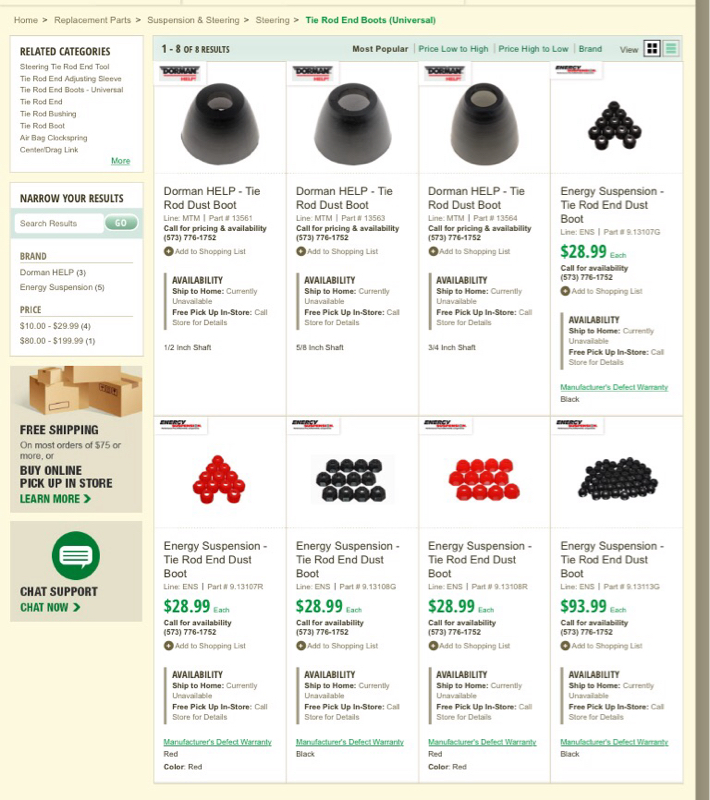

/ Tie Rod Dust Cap Question... #6
You can buy universal fit dust boots if you want too at a local auto parts store.
