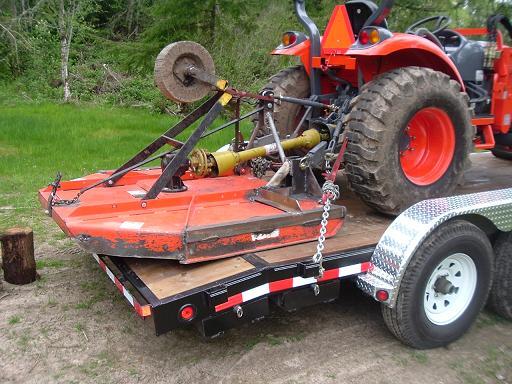

I use the stake pockets for a 4500# machine but mine are not built as stoutly as you describe, more like 1/8" steel bent into a U. If the TLB is much more than 5000# I would prefer the real deal of adding honest to goodness D-rings welded to the frame in the proper location. You will have to trust the integrity of the welds. In all cases, use 4 seperate tie down chains with the four binders as is typical and this way if one of the tie downs rips out then you will have the other three to hold the TLB.

That's what I use good USA grade chain and I cris cross the chains to the opposite sides of the trailer and come up thru the pockets just in case one would loosen up it would still hold if stressed. I was hauling close to 5000lb tractor loader and brush cutter,and it works great. MH
/ Tie Down Points on Trailer...Few Questions #5
Agreed, and it might be hard to see on the picture but the idea is to drop the hook through the stake pocket and then swing it up and hook on the outside of the pocket so that slack in the chain will not cause it to become unhooked. I get plenty of people looking at me funny about this method until their own light bulb comes on.
