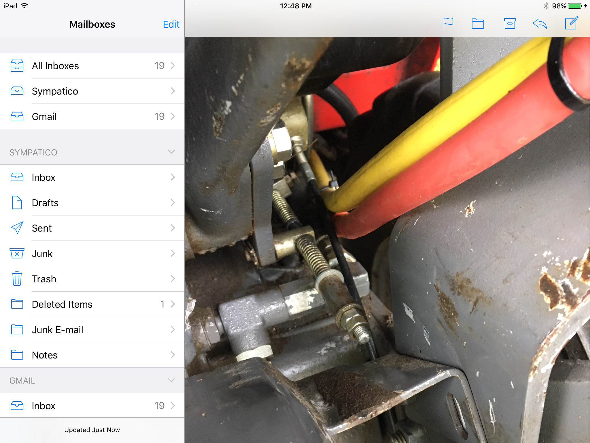

Does the linkage that lifts the lift arms have a threaded connections so you can adjust the lift arm height?
I never liked how many tractor had no problem lowering everything to the ground but didn’t raise things very high, even with top link shortened. Shortening the “linkage that lifts the lift arms” made a big difference.

AHA! There is an adjustment that appears to simply limit the control lever. The yoke now raises to it,s full height. This will solve the problem with my landscape rake and the top link. IMG_0364.PNG. IMG_0364.PNGHow simple it turned out to be. Too bad there is nothing in the manual about it. Speaking of the manuals, both operators and service, they pretty much suck!
On a related note, when I first took the backhoe off, I discovered that all three hydraulic lines were almost chafed thru. I was able to get a new set made and, instead of the stupid little zip tie, put colour coded heat shrink over them.i slap wrote the connections for configuration for tph on the back of the tractor.
