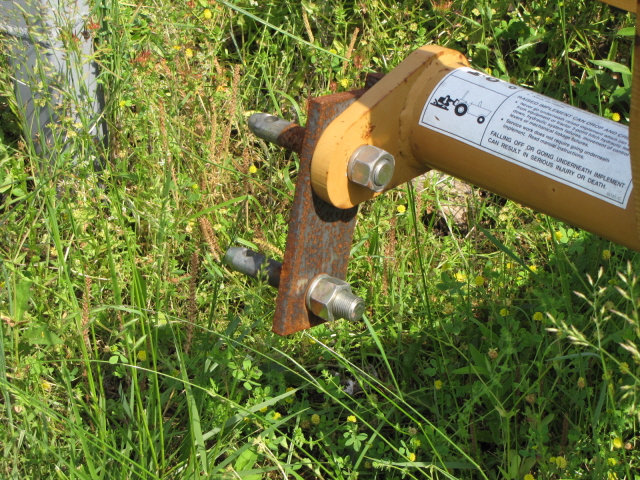

This is how I did my rake. Then you can get the *** end up. Had to do it for may B7800. BTY that is 1/2" flat stock.
