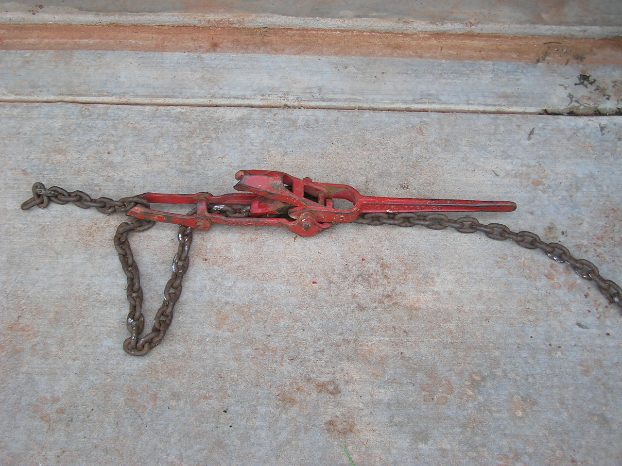

I want one of those.
Me too. I will be even more jealous if you can drop it anywhere along a long chain (same as a chain binder) and just start cranking.
You can put a longer chain in it and slide it where you want it, but you need no hook or a removable hook on one end of the chain.
That is exactly why I want one, but at $275 for the light duty ones new, I'm watching CL but since this thread was the first I ever saw them despite years of watching CL, I doubt there are many be let go...
